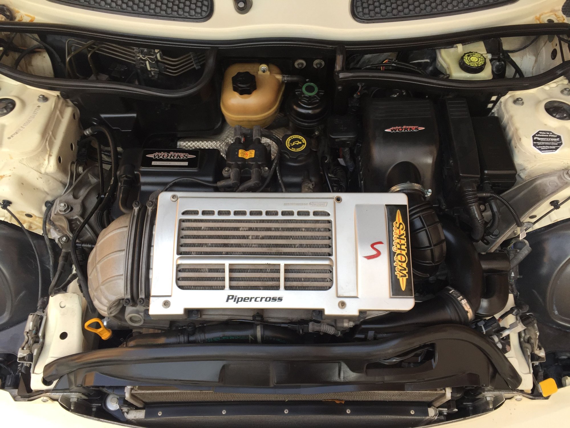

Oh and some pics of the engine bay - after a bit of spit and polish

Great job on cleaning up the engine compartment!
Lookin’ Good!
