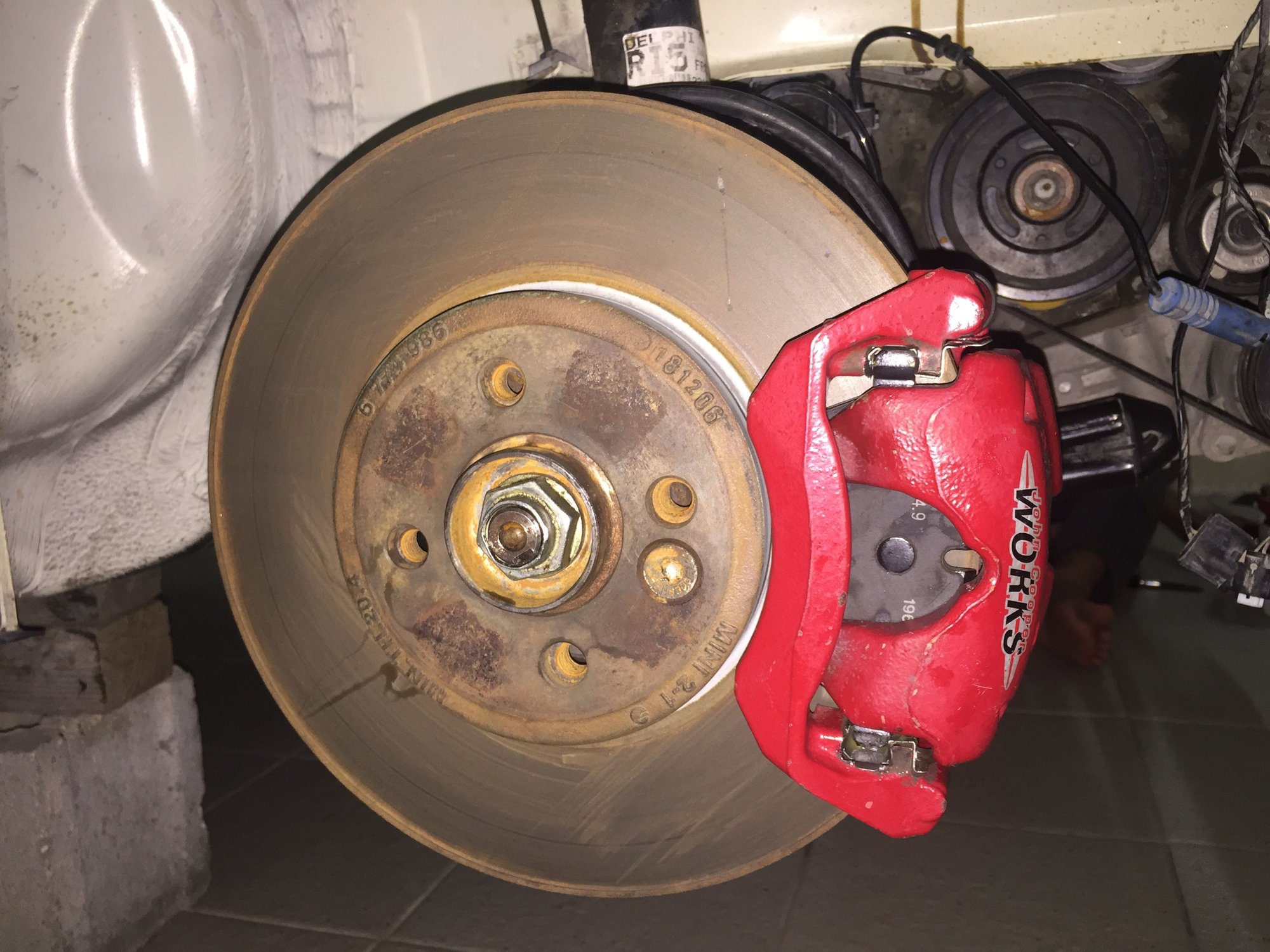

With the JCW big brake option fitted (pics below) - 294mm discs up front - so the pads are bigger too - 163mm x 140.2mm x 58.8mm.
The EBC Yellow Stuff are readily available on eBay from the UK - around $120 for the front set.
The Hawk HP+ are also available but only from the US - around $150 for the front set and will be more postage.
I'm thinking to go with a set of fairly standard pads for the rears as most of the braking is on the front discs.

Yup, yours are the same as the R56 S brakes. The JCW uses a 316x22 mm rotor and a 4 piston Brembo caliper.
http://www.realoem.com/bmw/enUS/part...oopS_JCW&mg=34
https://www.turnermotorsport.com/p-5...iABEgJDdvD_BwE
The R56 JCW also runs a larger diameter rear brake too.
My 12.2” (309mm) Wilwoods are a “poor man’s” version of the JCW brakes. I can switch those out for 11.75” (298mm) rotors for use with my 15” wheels. On both of these I have had a custom setup made that uses 25.4 mm thick rotors.
Nice find on the Yellow Stuff pads. You can run them on the street, but they may be noisy and over time the will wear your rotors more. If you make a habit out of going to the track all of the time, you will want to upgrade to a more aggressive pad both from and rear.

Brake pad guy is asking if I have standard TRW calipers or optional AP calipers ?
Anyone know how to tell the difference ?

Just tell your brake guy that you want the pads for a 2007 - 2013 R56 S and see what pops up. You have the same pads.
That Real0em.com web site is a great resource for part numbers and seeing what is the same.
Where you have tabs on the pads that come out of the side as a bent rectangle, the other pads (R53/R50) have tabs that come off the side of the pad at the top of the side at the intersection with the top of the pad and they look like hooks.
Yes thats what my front pads look like and yes the brake guy confirms that this is what he has. Front EBC yellow stuff sorted.
But I think the rear pads on mine have tabs off the sides, that do look like hooks ?
I think the rear discs, pads and calipers are the same for all R50, R52 R53.

Yes, your rears will be the R50/R53 style with the “hooks”.
