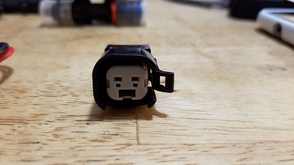

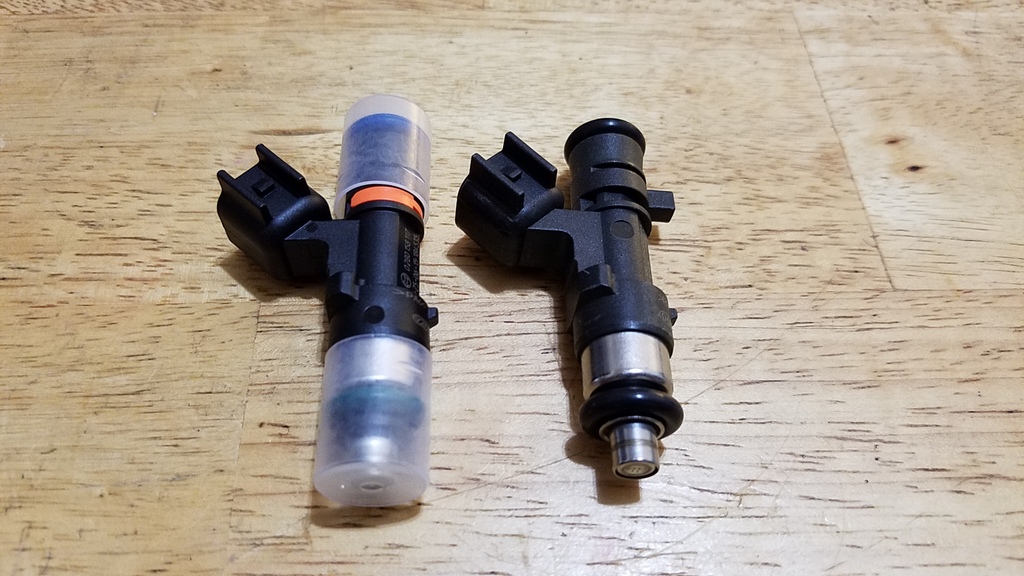

HaveATank,
These injectors will fit and I've been using them for over 2 years.
They are 380 cc. Bosch #0280158096. You will need EV6 Female to EV1 Male Plugs, and the have to be wire extended and not the dual sided adapters, otherwise you will have intercooler clearance issues. You can find them used on occasion for cheap in ebay.
Hope this helps.

Yah i just order some. I have does 550cc injectors and already have the extension piece. they cost me $83 for 5 since this are injectors for volvo and there 5 cylinder engines. Guess ill have a spare lol.

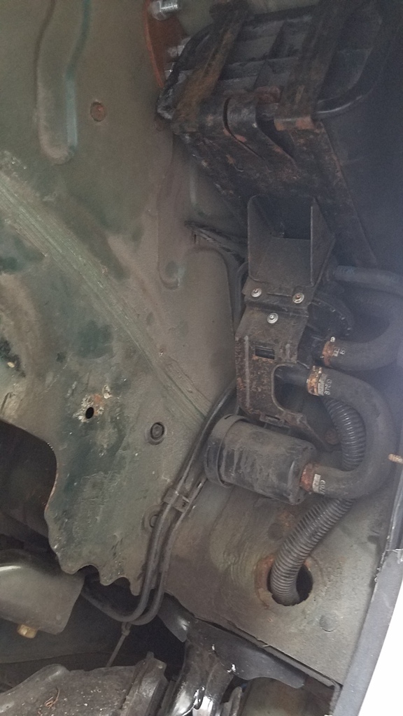

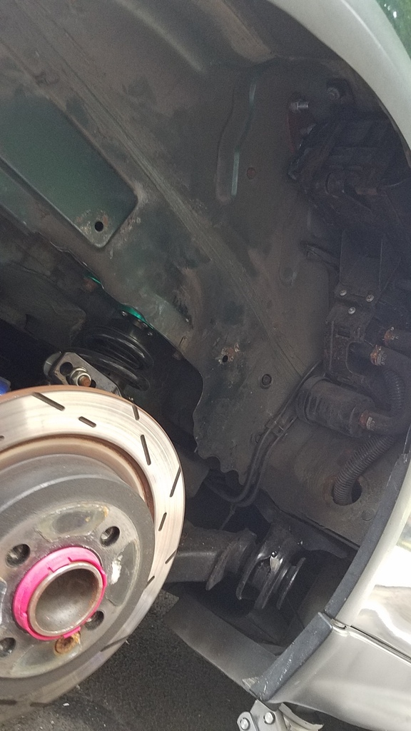

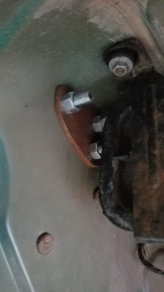

Also after doing some exploring, I found out where my Evap leak is coming from. Looks like i actually punctured the Charcoal Canister while installing the Roll cage, So guess i have to get a new one. I was going to patch it up, but don't really want to deal with it again. I figure ill take care of it once and that it. After i replace it ill clear the adaptation again.
Got the transmission insert. guess i have more work to do. Hope this will also fit along with this
Had the side PU support bush for a while just never put it in, But after the Flex i want this motor not the move at all LOL.

On Friday I replaced the charcoal canister. It turns out i drilled into it while installing the roll cage.

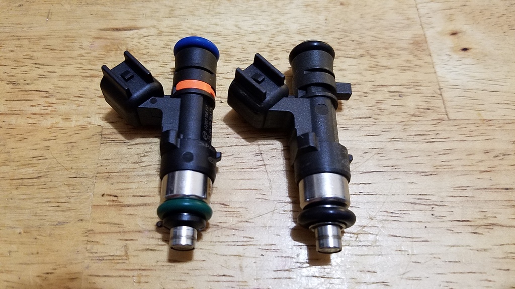

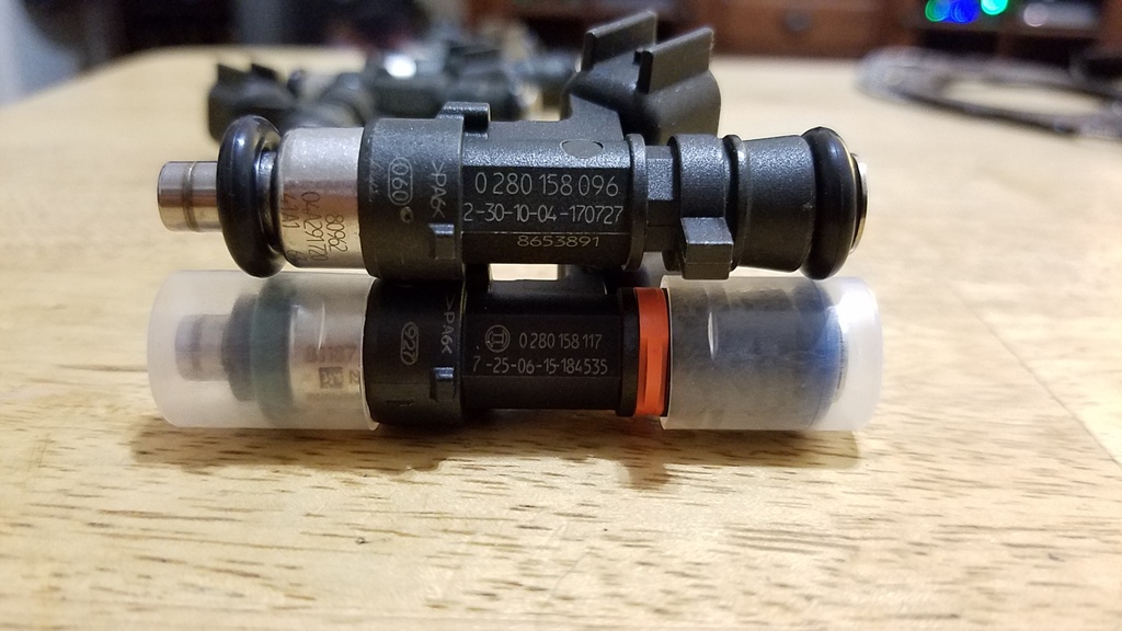

Got the 380 Fuel Injectors yesterday. Put them side by side with the 500cc i got before.

this is the 550cc
380cc on top and 550cc at the bottom

I think this wont work just for anyone going down this route

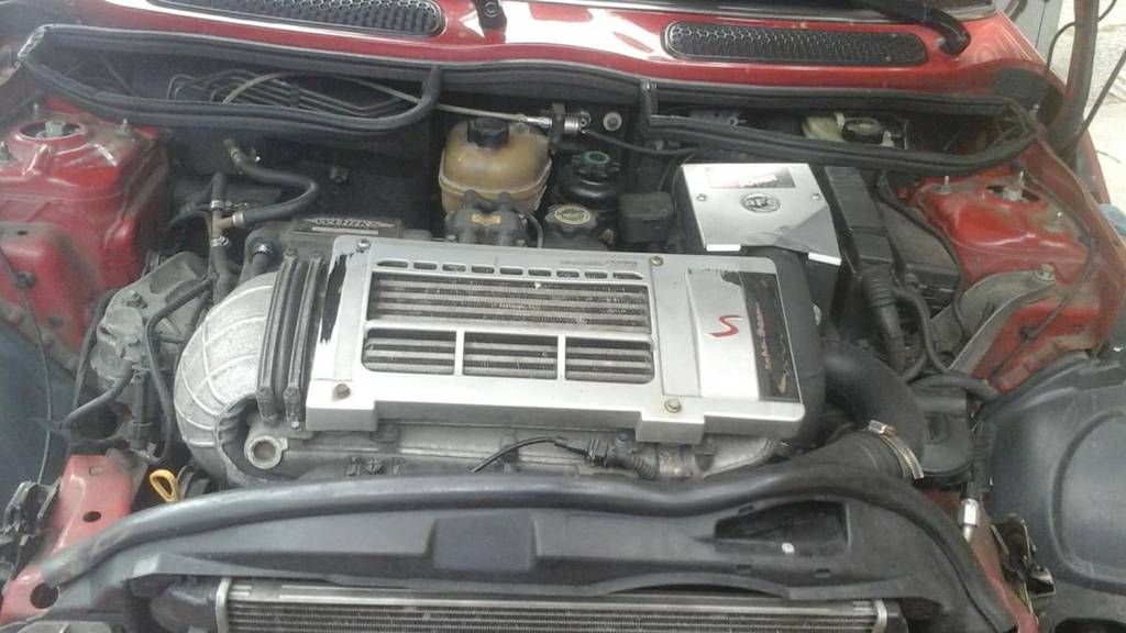

OK Ill soon be the owner of this 2005 JCW
Everything will be up for sale, but the engine/Transmission and maybe the wheels.
