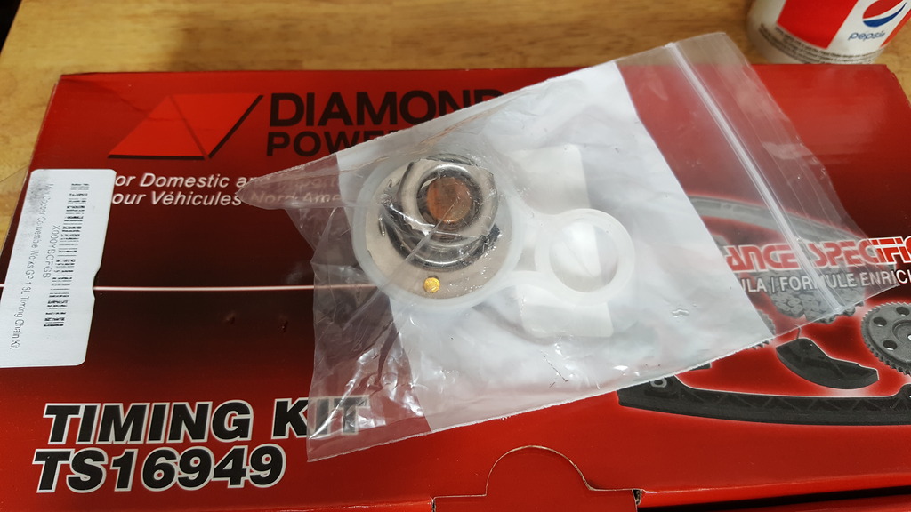

I got the red one for the engine.
Ok so i placed order for some parts and OMG Amazon already delivered some stuff. I mean i placed my order yesterday.

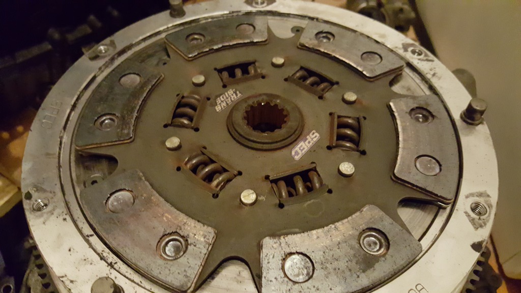

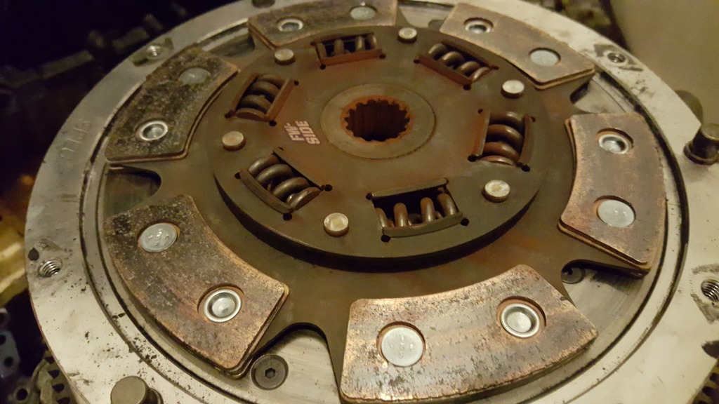

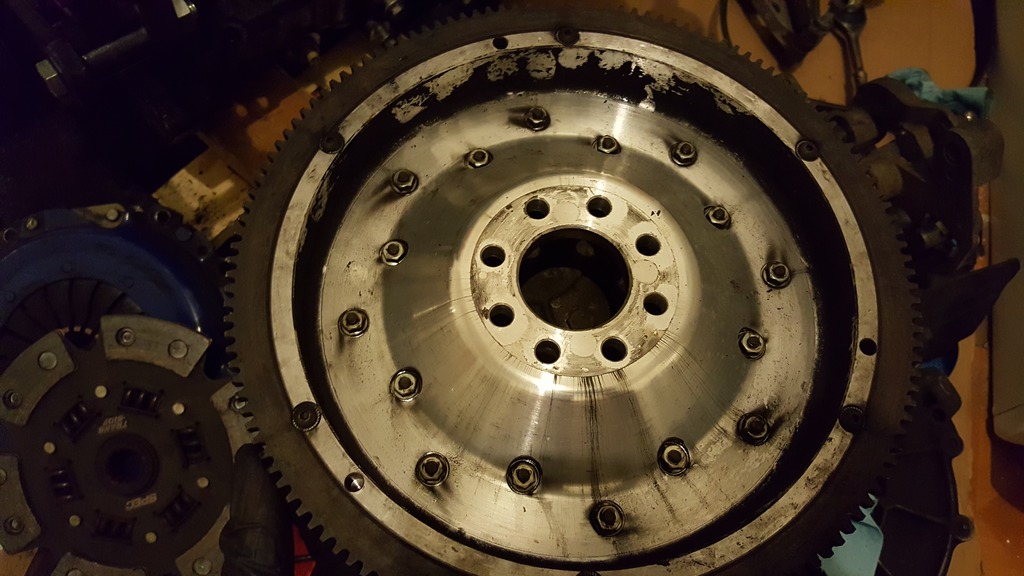

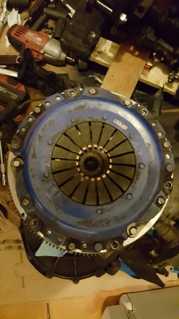

I separated the engine and transmission today and found out this had a LW Flywheel.
6 puck Clutch looks glazed to me. Guess ill know what i have when i take my motor apart.

That flywheel doesn't look too good either.
It looks like the face of the clutch is bolted in...Can it be replaced?
Previous owners slipped it a lot? Any chance they were into drag racing the car?
