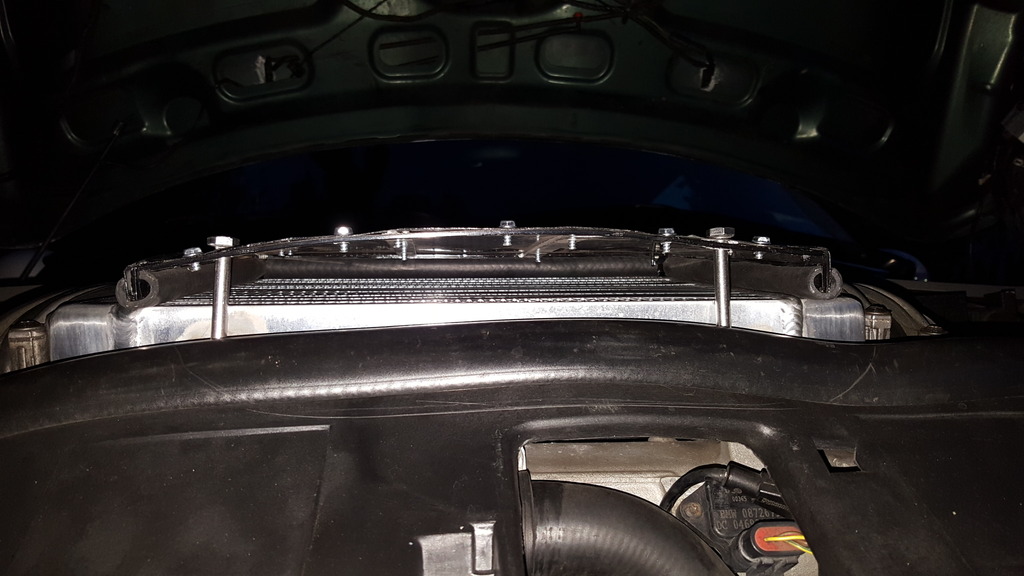

Eddie07S
So i took your suggestion and made the top alittle round.
Give it a little more structure and made it round As it is it touches the top of the hood

Fits nicer
Now, time to see if it makes a difference.
Hey, if not not harm and it looks better....

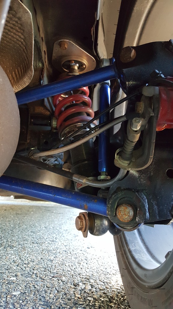

So it all happen today on the Hwy. Crack car drove fine. when i got to where i was going i saw that the right rear was lower then the left. after taken a look surprise surprise. Broken suspension. Called WMW and place an order for Megan Coilovers. Have a track day next Sunday hopefully it gets here before that. and i can install it.

Crap, that sucks!
Who's coilovers were those?
You are lucky you didn't loose it when to broke.

BC Coilovers with Eibach springs. The guy that sold me the car gave me like 3 other cans don't know if they are blown, but will be trying them out tomorrow until the Megans come in.
If i hadn't paid for the track day, i would have taken my time and done some research to see what would be the best bang for your buck suspension for track use. Did a quick search and everyone seems to be running megans and Way from WMW suggested them as well. The Mod mini channel dude also uses the Megans. Don't know if there was other options like regular shocks (non OEM bilstein or something else) and different type of springs and camber plates or something.
Happy when it broke it went forward instead of back. It would of taken my brake lines/ABS/Brake sensor and only god knows what else.
But happy it happen on the highway and not at the track. Taking a corner at speeds.

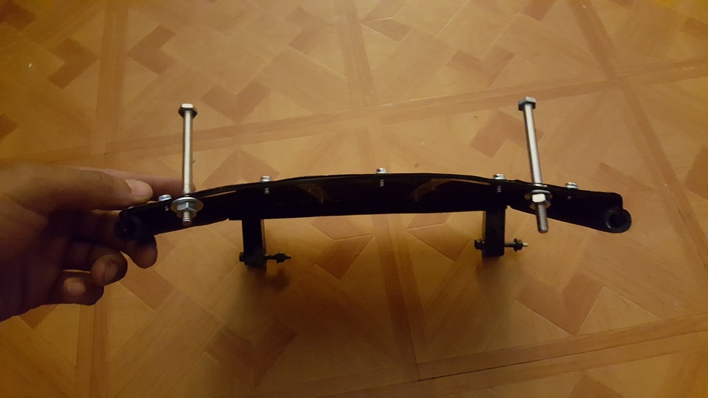

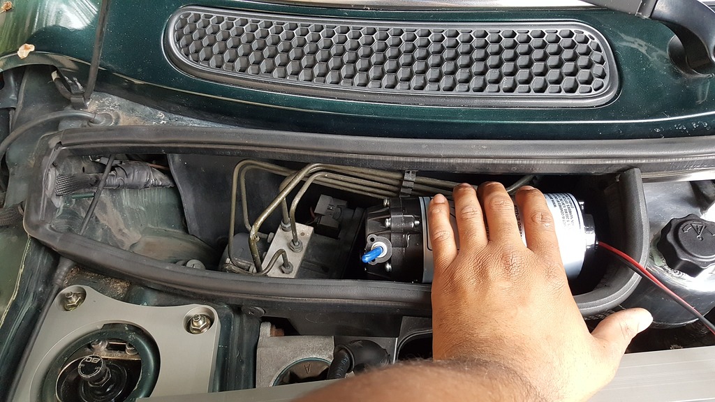

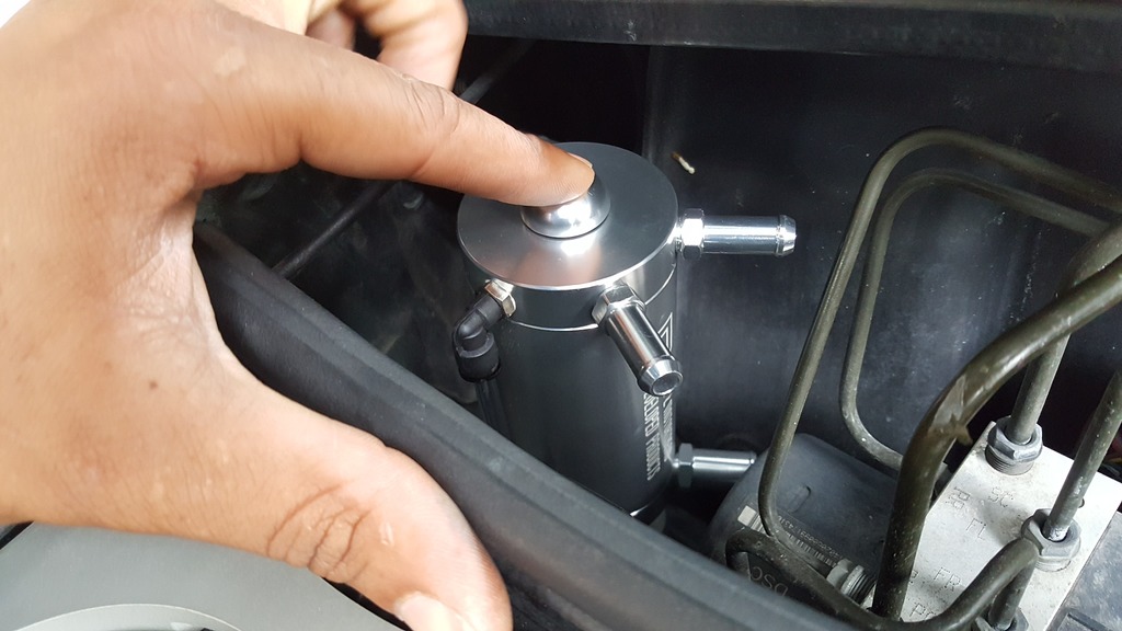

So since the car is down. I decided to get some stuff done. Made a bracket for my OCC and i purchased a used cold side supercharger horn to install the WMI nozzle and a source to get boost for the WMI.
Plan on making the Headlight washer tank the reservoir. What I'm still trying to wrap my head around is getting about 2" diameter of cables and hose into the cabin from the engine bay thru the firewall. I know some of the cables i can cut and splice them back together, but prefer not to do this. Any ideas? here is the list.
2 cables for the WMI pump
1 Cable to connect to the Positive terminal in the engine bay for WMI MAP/controller
1 boost hose for the WMI MAP sensor/Controller
2 Cables for the WMI Tank Level sensor
1 big fat connector for the wide band sensor Gauge
1 big connector for the Map Sensor for the Boost gauge
1 cable for the Shift light
1 big connector for the Oil temp gauge (still dont have but looked at the install instructions, Innovate will be coming out with the updated version on June 30)
1 big connector for the Oil Pressure gauge. (still dont have, but looked at the install instructions, Innovate will be coming out with the updated version on June 30)

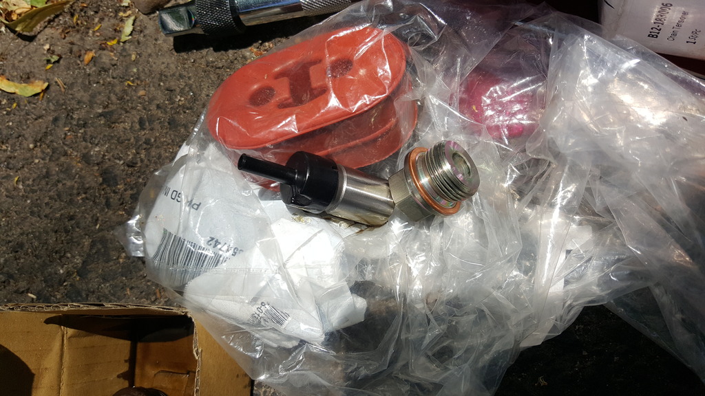

This is going to be a useless question, but hope some one has the answer. I looked under the steering wheel and there seems to be a big gourmet that has the red cable which i assume comes from the battery cable in the engine bay, but i can't see it from the engine bay or is not accessible. Push come to shove ill just drill a whole and figure out how to make a gourmet or where to purchase one from. But prefer not to do this so if anyone can help me out here.
Found other air bag in the pile of stuff the guy gave me when i purchased the car. Going to install it and see if this will make my air bag light go away.

The Oil Catch Can and the WMI Pump are going to live right here
OCC
WMI Pump

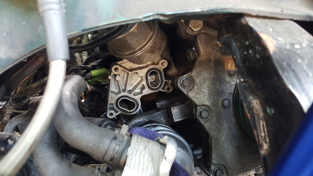

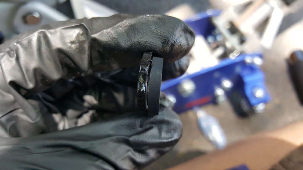

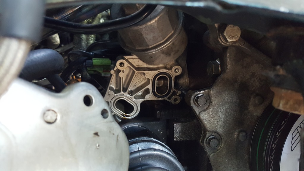

So got the CO today and installed. Installed the timing chain tensioner and bolt which then turns out i didn't need since it was just that the old one was just loose, but i installed the new stuff since i couldn't return it anyway. Replace the oil cooler Gaskets. it was pretty flat and hard
Tomorow
Going to change oil
Get other alignment
Install my OCC
Need to get all the tools out of the car to see if this will help with the scrapping in the rear. I will have to adjust the suspension if that doesn't do it.

Here is the lucky one. It snapped right before the hat.
Much eaiser to do this with the oil cooler off and the strut off.

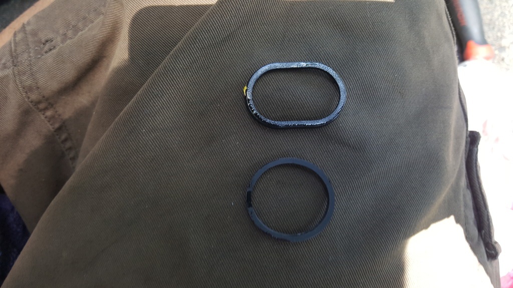

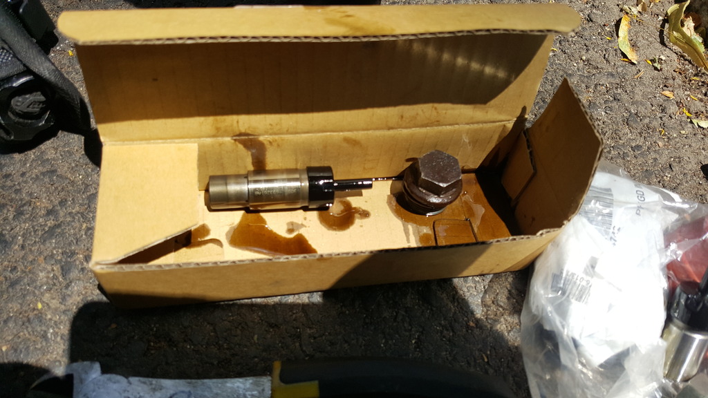

Old Tensioner and bolt
New Tensioner and bolt
Oil Cooler

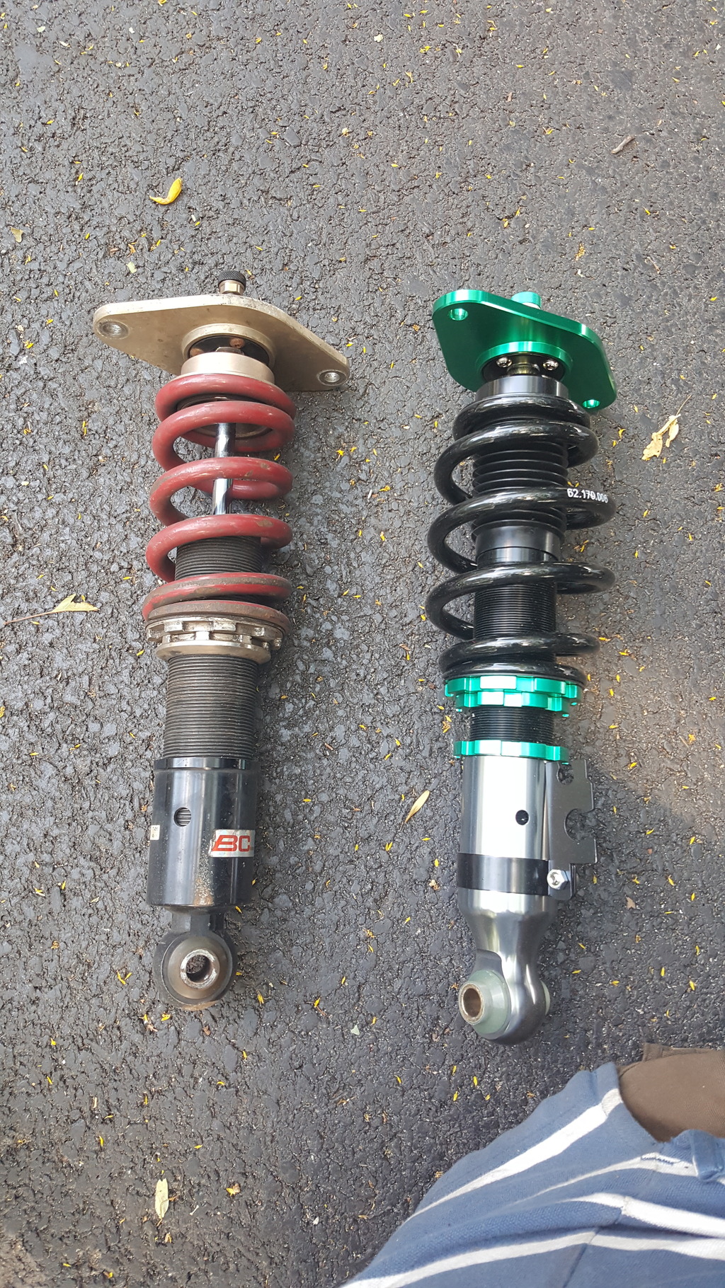

Are you sure those are R53 CO's? The rear looks like it has the tapered bottom bushing that fits into the recess of the aluminum R56 trailing arms. The R53 struts are flat since the steel arms don't have a recess.
Old Jun 23, 2016 | 06:23 AM
  #73
HaveATank's Avatar
HaveATank
Joined: Jul 2015
Posts: 460
Yah im sure they are for the R53. The R56 are not that different then the R53. The old BC CO also has same thing.
