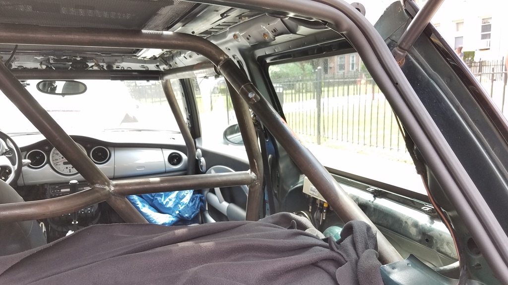

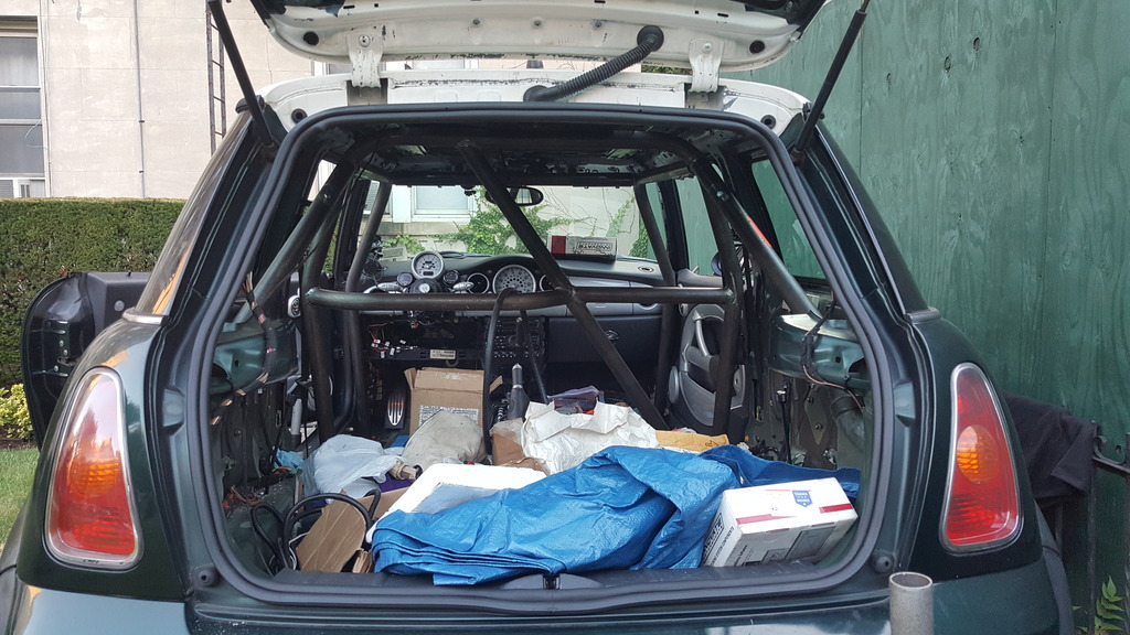

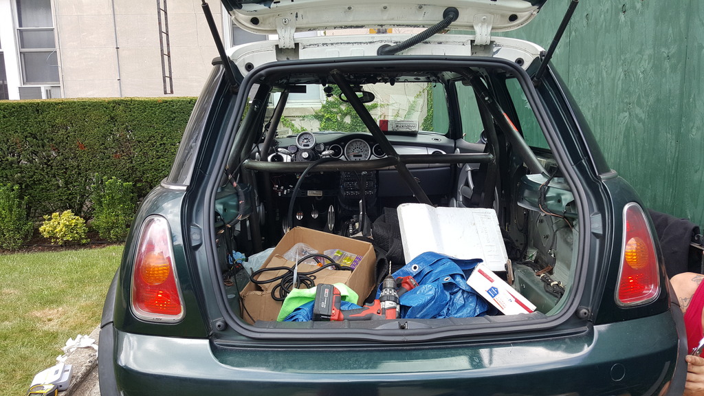

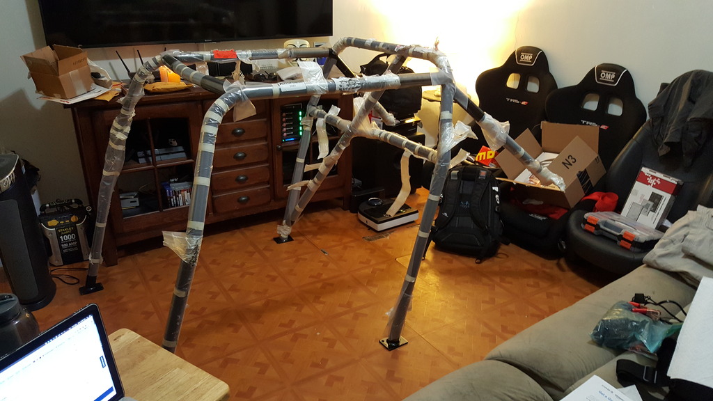

Finally got the Roll Cage
Install only took all day LOL. Damn i was going to take it out to paint it later on, but i think it will be painted it right in the car. Installed the eye bolts for the Harness. Also installed the remote damper adjusters for the rear. Tried to install the seats, but the bar that goes to the front is really close. It like 2 inch away from your head and with a helmet on it like 1/8"-1/4". If i remove the planted mounts then i get little more room. Even if i use some kind of protection for the tubes i will be rubbing on them at that point. I don't know if to just leave it like this or make me custom mounting (side mounts and bracket), So the seat sit lower and get more room. It almost feels like i will be driving with my head off to the side lol. I don't even know if i can return all this which is like $400 worth or more of stuff.

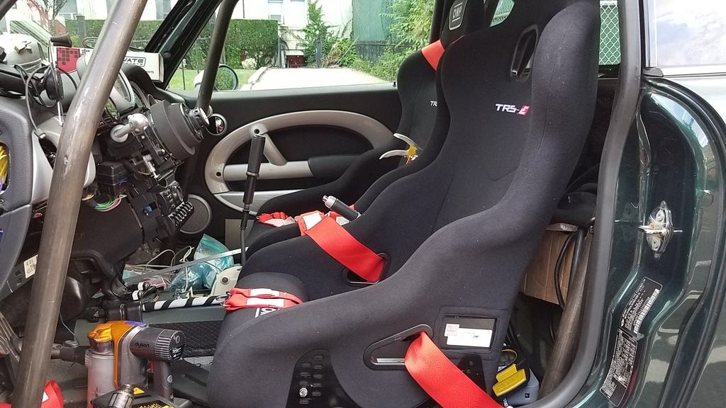

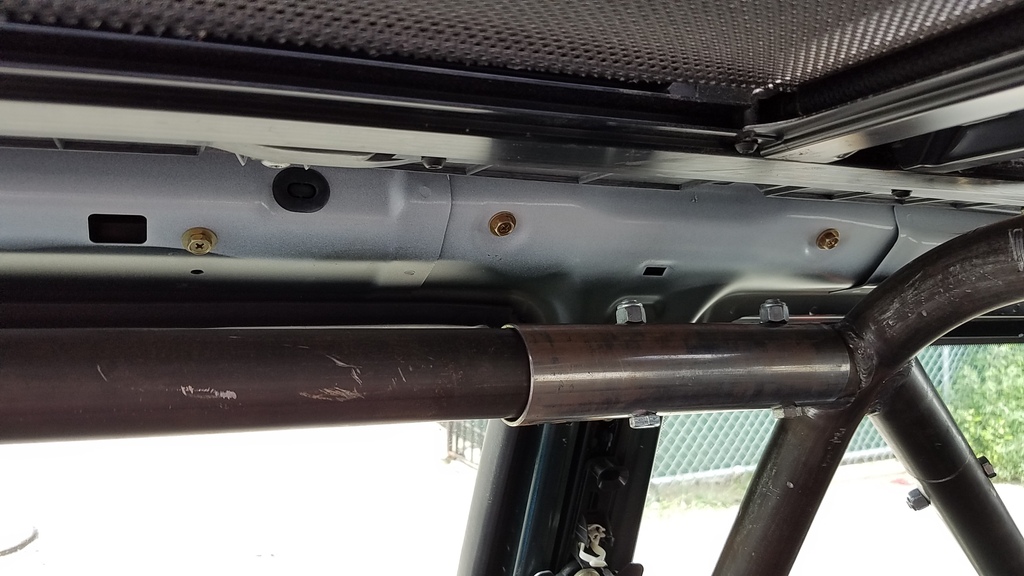

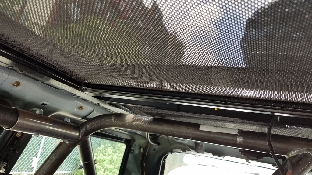

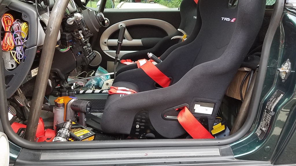

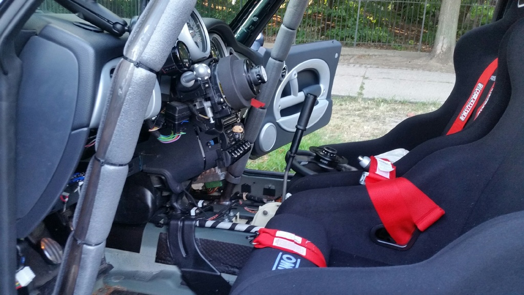

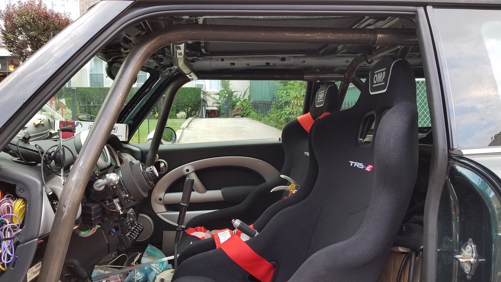

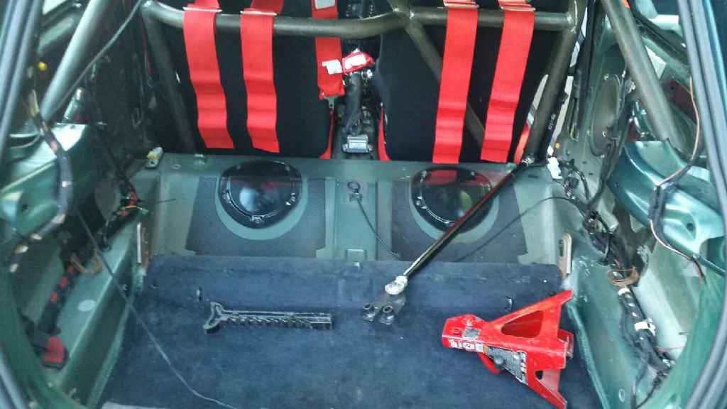

So i just drilled the seat brackets and that how i was able to install it. Here is some picture of the bars and the seat installed.

By the way i have other 6 point roll cage for a mini with no sunroof if anyone is interested in it PM me. It painted black

Wow, that is quite a mess you have going there!
The roll cage looks good in the car. It seems from the picture with the stock seat, and judging by the location of the head rest (where your head would be, supposedly), that there should be room for the helmet. Am I not seeing it right? Or is there something different with the race seats that brings your head closer to that bar?
At any rate, what you have done is pretty impressive.

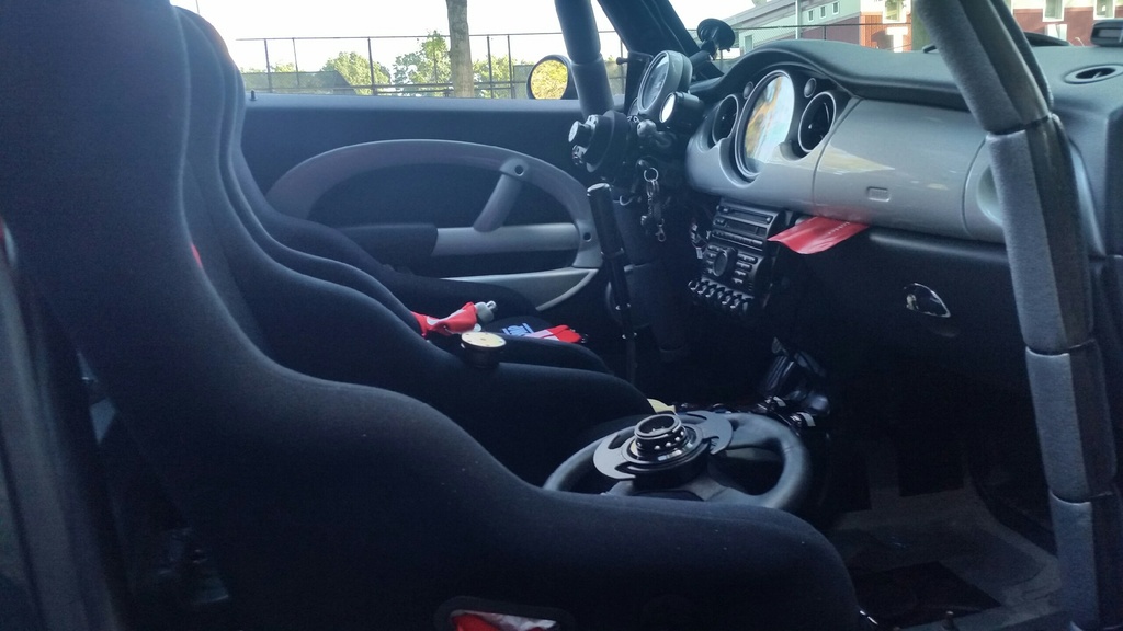

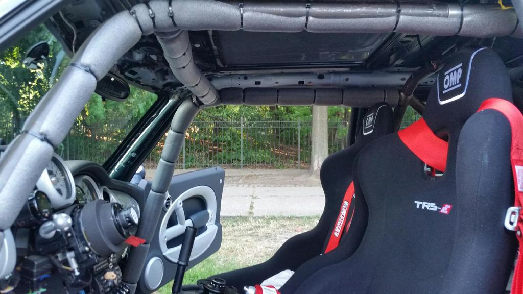

Heading out to Watkins Glen today
Heading out to the track today
Yesterday i put padding on the roll cage in the front and fixed up the belts. getting an evap code but i think that is from installed the belts will take a look at it when i get to my destination. Forgot to take a look a photo of the belts neatly zipped up.

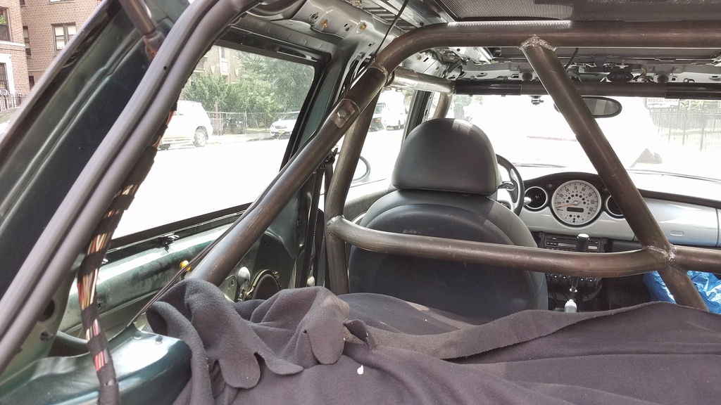

Likes: 98
Originally Posted by HaveATank
...the bars installed.
The nice thing about this shot is that it provides a clear view of the sunroof drain and how it connects to the steel pipe that runs down the A-Pillar, for those who run into that issue several times per year on this forum.

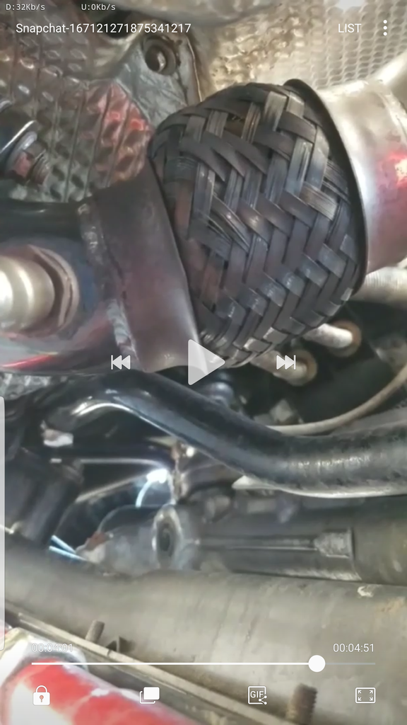

Made it back from the track, but with a failed Flex pipe on the exhaust manifold. it was a LOUD!!!!!!!! ride back. Will up date tomorrow.

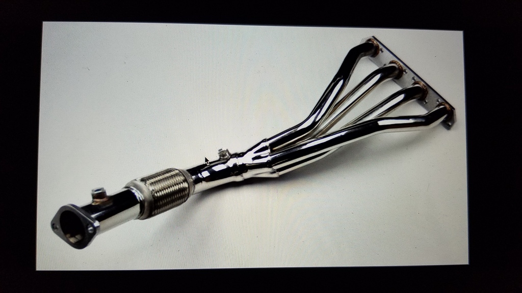

So my flex pipe on my header is leaking i was looking at this headers what do you guys think. I like the first one because it has a more standard flex pipe. This is the second one with a leaking flex. The one that came with the car head a leak in the same place. There was other mini at the track and he just txt me like 2hr ago and told me he also has a leak now. It seems like this will be part of maintenance and the stock version isn't any better. If i can avoid having to buy one very so offent that would be cool. The second one doesn't seem to have a flex pipe at all, but it requires welding and around me, people charge an arm and a leg to weld like they are using Unobtainium to weld the pipes together.

i would check all of the engine mounts. Does this engine have a torque arm? I know that the Gen IIs have one. If not is there an aftermarket one? I know S-driver ran the snot out of his MINI and didn't have this problem.

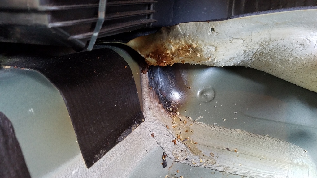

Need to figure out where is the small leak in the Evap system. I really hope i didn't drill into the charcoal canister while installing the roll cage and it just that i pulled the fuel evap line alittle too much. The header should come in Monday, but will be working more then likely. I'll install it as soon as i get a chance and cross my fingers nothing else is wrong down there.

Session 2 of 08-23 After watching the video you can hear the exhaust already starting to leak.

No problem with the roll cage/helmet clearance? I recall that was a concern.
Occasional rub, but not at all. Getting in and out with helmet alittle bit, but not really to. Need to practice the egress. Since i totally forgot to take tge wheel off in that little scared i had. The instructor got me more nervous then anything else.
