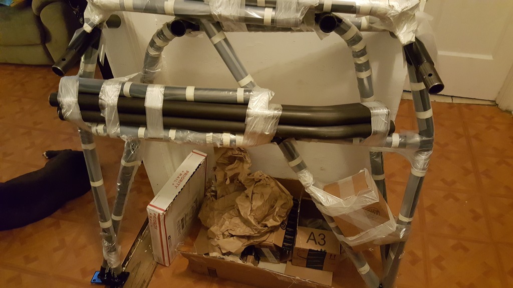

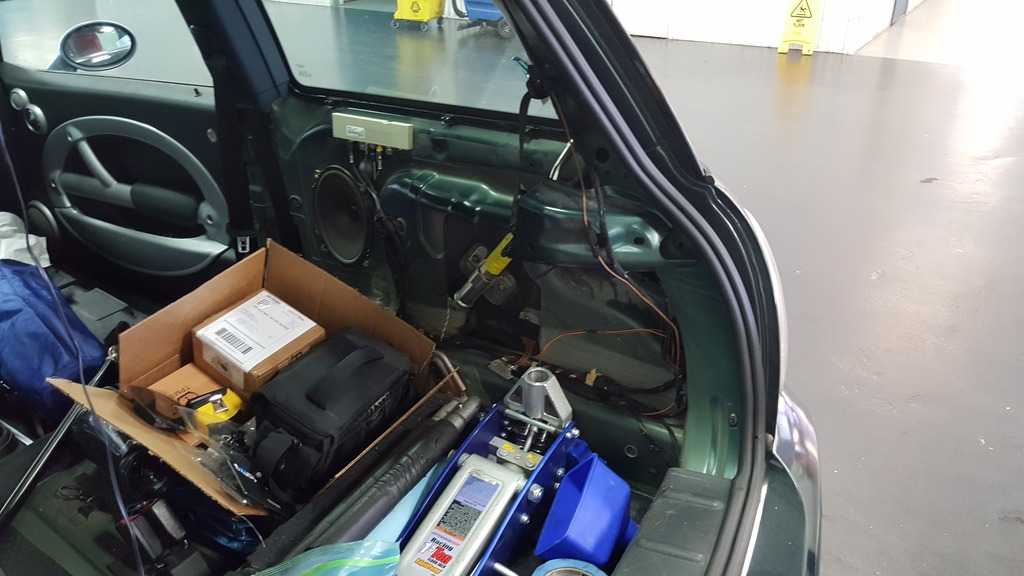

The 6 point roll cage comes in Monday, so I stated to strip the interior. Test fitted the seat. The Planted unit i got for the passenger side was bent. So just used it to test fit in the car.
Going to the track tomorrow to push the car. If it makes it (crossing fingers) then we will be in business. Tomorrow is set to reach 100f and i plan on pushing the car to see what it had. Already picked where i will be going to go hard on the brakes since there is a pretty big run off. hope everything works out. I guess i will be fighting to stay in the seat again.

Patiently Waiting to be installed

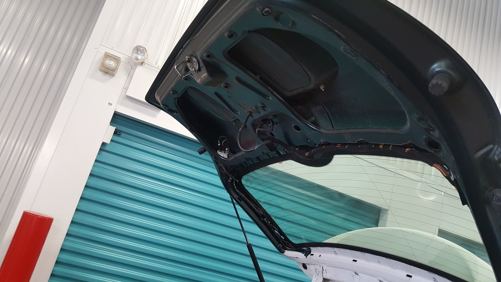

Stripping stated
Took out all the seat belt components. If the car makes it from tomorrows track day i will take out the curtain Air bags.

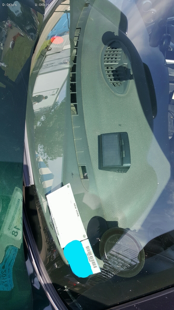

Casualty of the day was my windshield getting a chip/crack

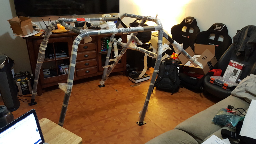

Roll Cage came in today put it together to make sure very thing is there.

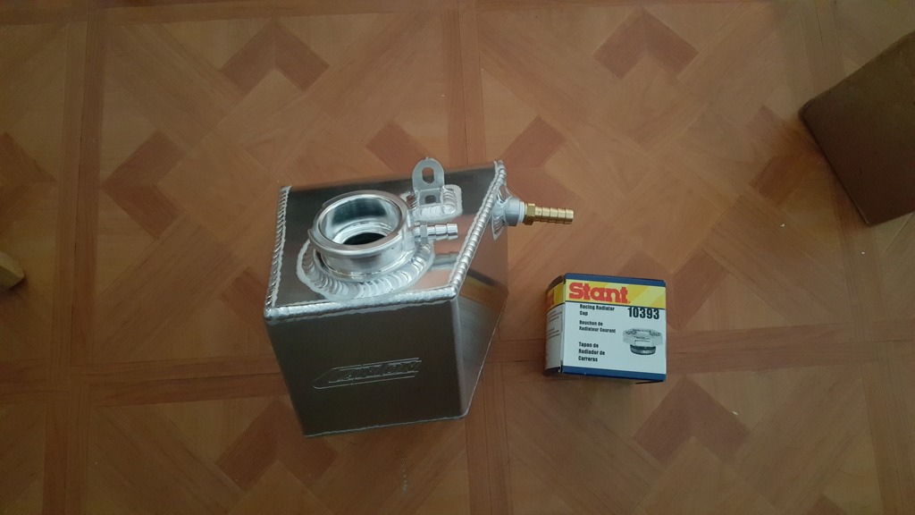

Ordered a new tank since the stock cap sucks. want to use a regular rad cap

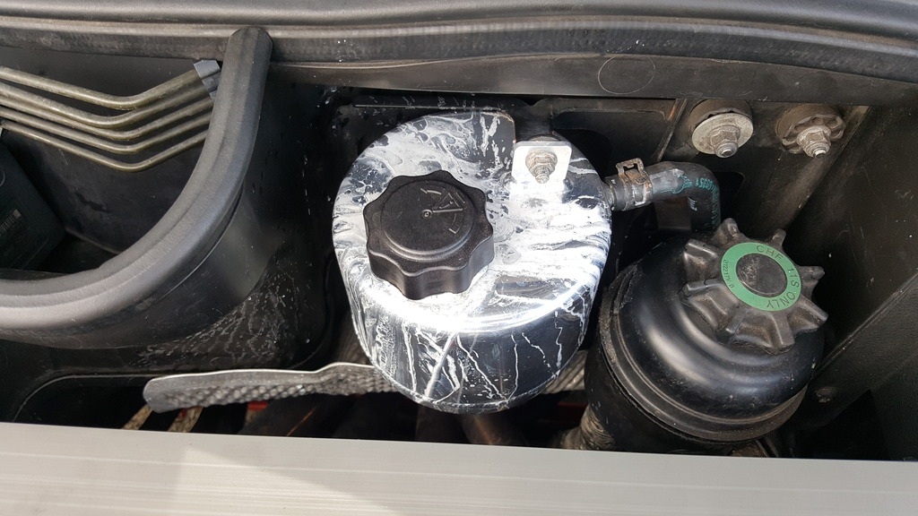

Got the new Coolant tank with a proper Rad Cap. Hopefully everything works out. Not much of a fan of the barb brass fittings, but lets hope it holds up.

HOPEFULLY it Cures this

Mine did that first time at a track, keep it low end of range now,. Well it puked down to low lol

At least the fittings are screwed, so there's always the option of replacing them with normal fittings.

Originally Posted by HaveATank
I don't understand what you are trying to say
I thought you changed out the coolant expansion tank because it was puking coolant all over ?
maybe I missunderstood the picture

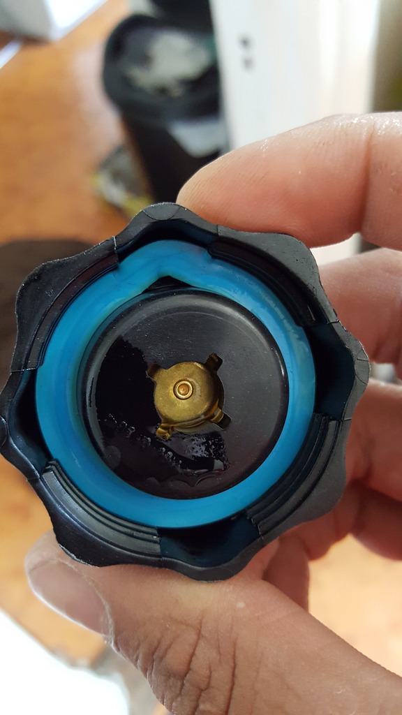

Yah i did. It was the cap after all. Here is what the cap looks like after i took it off and it makes sense how much was coming out. I guess i kept making it tighter and tighter, because it was coming out until it got to this point.
It spilled all over the engine bay. I washed the engine and i used mean green and it made all my nice shiny aluminum things white (a little mad at myself, but it done already).
for got to take picture of the after
