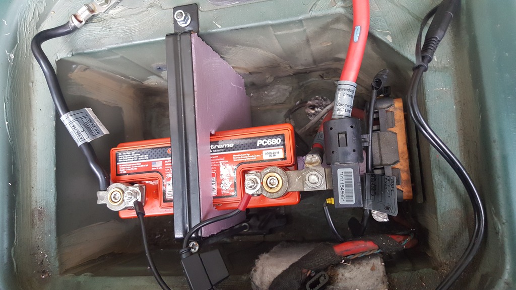

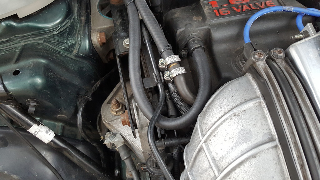

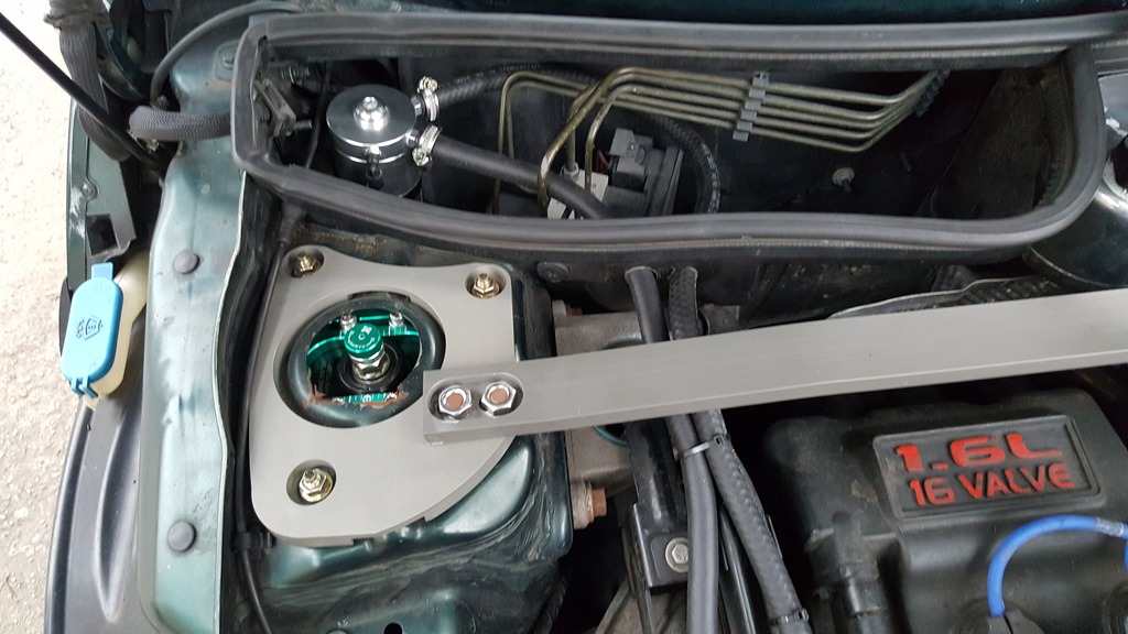

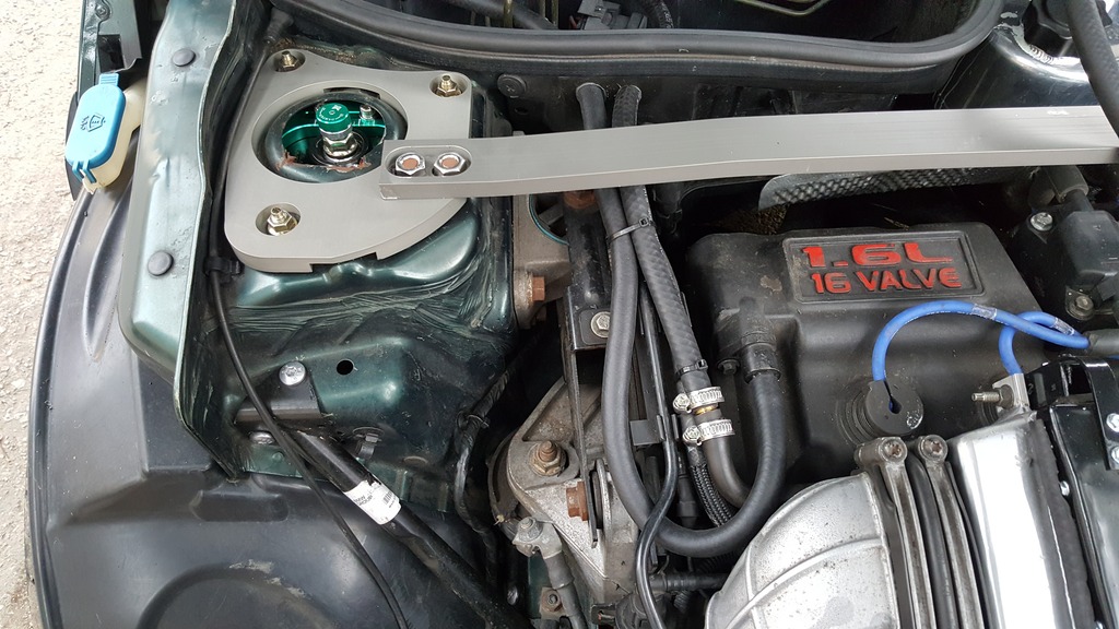

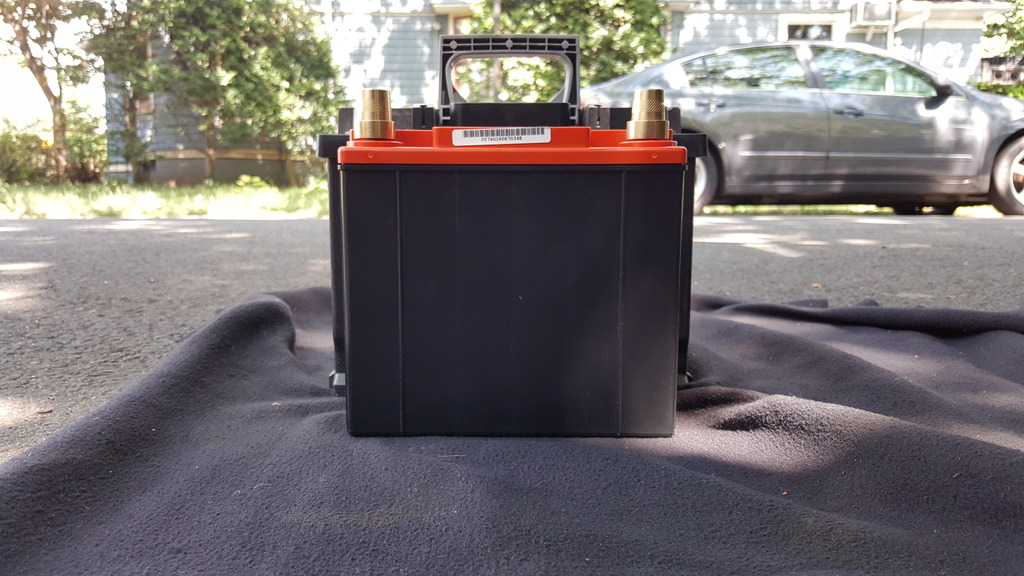

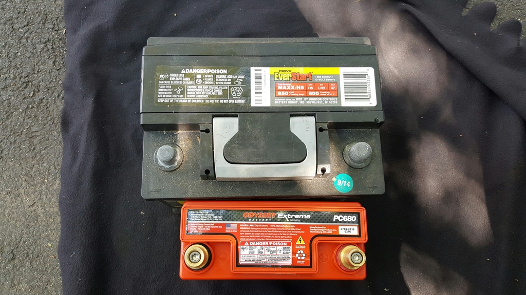

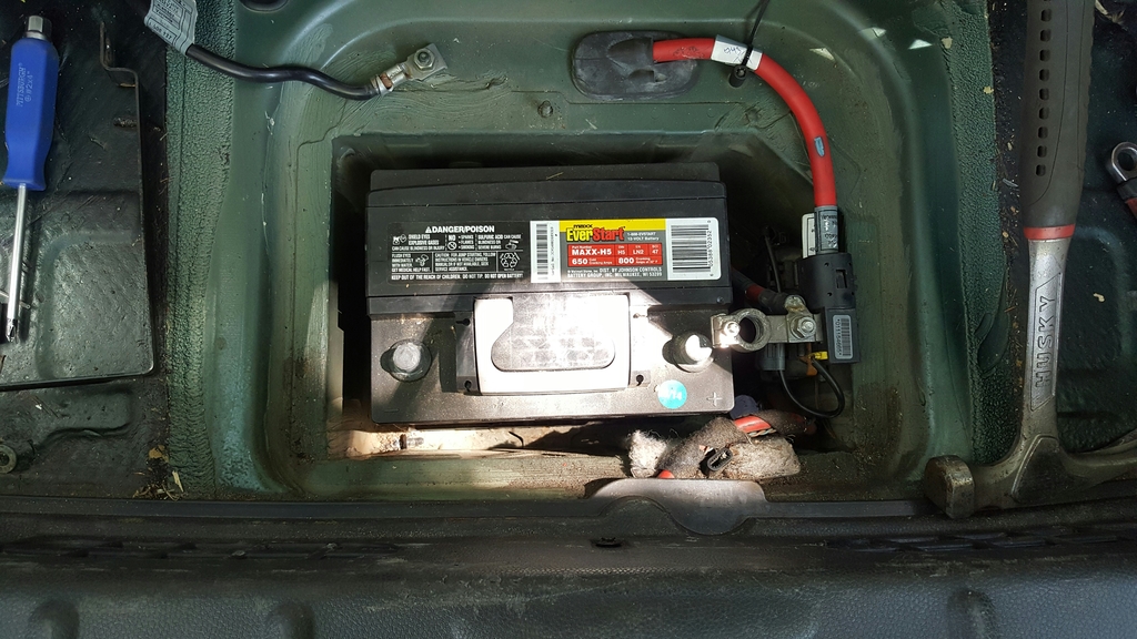

Oil Catch Can and Battery
So finally got around to installing some more goodies.
OCC was connected today. I had it in there for several days just never got around to plug the hoses in and all. Also installed the battery still have some things to deal with since it has lots of room where the battery goes. Here are some picture
Battery size Comparison
Used my old coolant reservoir cap and a water bottle cap to fill in the gap. this is where i was thinking of using the Styrofoam to fill in the gaps. I checked today and it seems to be holding up pretty well.
Was thinking of using Styrofoam to fill the the gaps, what do you guys suggest NA or YA?
Oil catch can pictures

Best bet for the battery would be one of the mounts they sell for it. You can fill the gap with styrofoam, been done forever, I personally prefer a clean install. I got mine at the same place I bought the PC680, which is Aircraft Spruce (Oh Canada) and it was $54 CAD. There's a small lip at the bottom and top, so the battery doesn't move around. I added strips of rubber insulation on the delete plate itself and on the inside of the battery mount, just to avoid direct contact with metal and reduce the vibration.

I think I'm going to go with the styrofoam. Not ready to cut the battery tray out and seal it like you did, But your setup is clean. I would do the same if i was going to mount it flat or somewhere in the cabin.

I meant to use the battery mount to fix it in the factory box. You'd have to drill holes, so there's that.

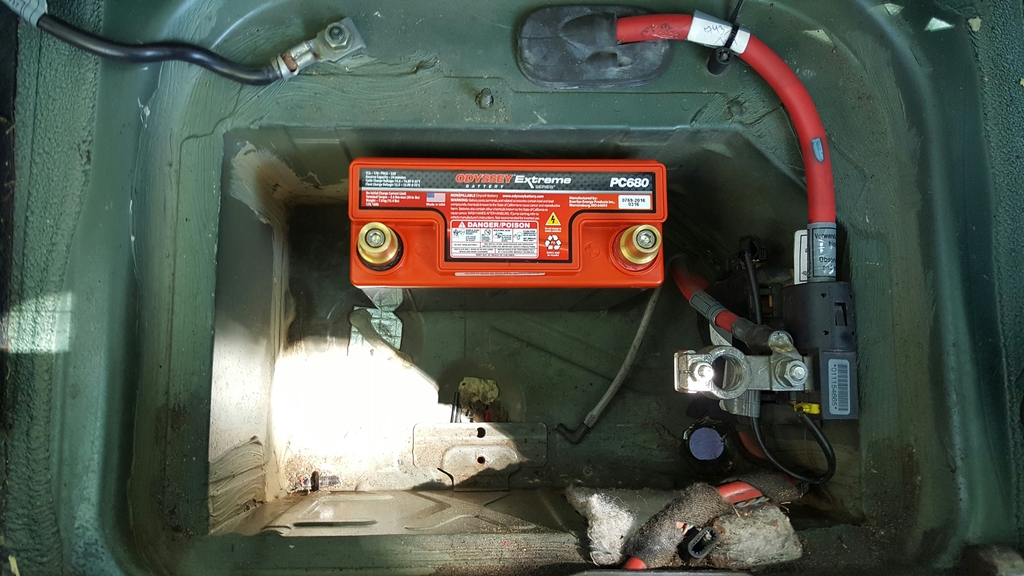

Here is what i did. Cheap mounting system ever lol. $6 dollars for whole system. I was going to fill the whole cavity with this, but after making the middle section and seeing how the battery not going anywhere i just said forget it. Added the side pieces just in case someone wants to give me a hard time at track inspection on an HPDE day. Forgot to take a picture of the Solar battery tender. I put in the the rear moon roof section. Will update when i get a picture.

However I think there is still some amount of rotation that will have to be handled. How about 4 gallon size food storage bags, put one in each open corner and fill each one with Great Stuff foam? That would full support the battery, would be easily removable and, most importantly, remains cost effective- that is, cheap
Old Jul 10, 2016 | 12:23 PM
  #90
HaveATank's Avatar
HaveATank
Joined: Jul 2015
Posts: 460
Don't know if that is a joke hahahah Sandwich bags lololololol Dude you made me laugh so much with this one.: lol:
The battery is not going anywhere. I purposely made the foam 1/4" taller, so the stock bracket can crush into foam and the foam and from itself around the battery and create an indentation in the foam. I added the side in the same manner, A little bit bigger so it tight. I can tell you this much not even 5gs of force will make that battery move lol. when i was tighting the bracket i thought i was going to explode the battery that how tight it got. I left it like this for about 2hr then took it off and the bracket had compressed the foam nicely and it was still tight. I just did the sides for any inspector at the track not to say anything.
I mean hell i only used 7.5"x7.5"x1" out of the 24"x24"x1" peace of Foam i got for $6. My original plan was to use 3x7.5"x7.5" and glue them together to make it 3" across the top, but when i saw how stiff it was with just one i said good enough for me.
Originally Posted by Eddie07S
I love it

Well, I actually was serious. Do you know about Great Stuff foam? This stuff has about a 5 to 1 expansion ratio. Inside of a un-sealed plastic bag it would conform to the shape of the space that it is in, without sticking to it. Then it hardens to be much like the foam board you used. The advantage is that you would not have to cut to shape and glue pieces together.
The downside is that it would have doubled your costs.
At any rate, a little laughter is ok. The world could use a little more of it.

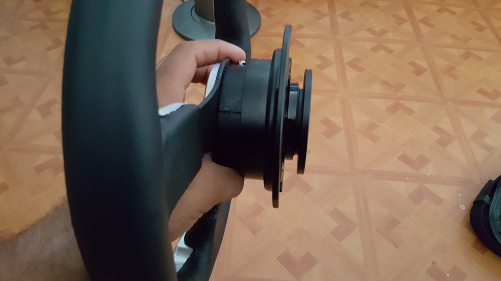

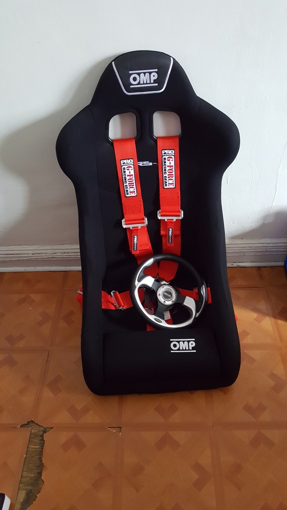

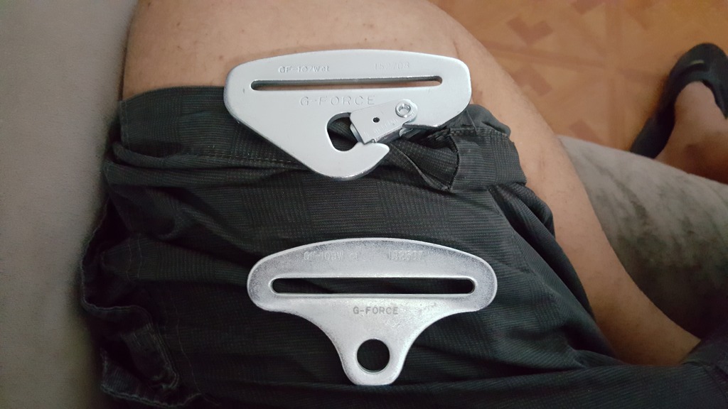

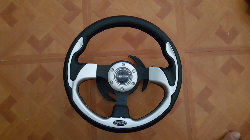

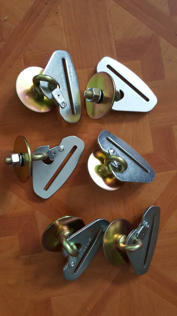

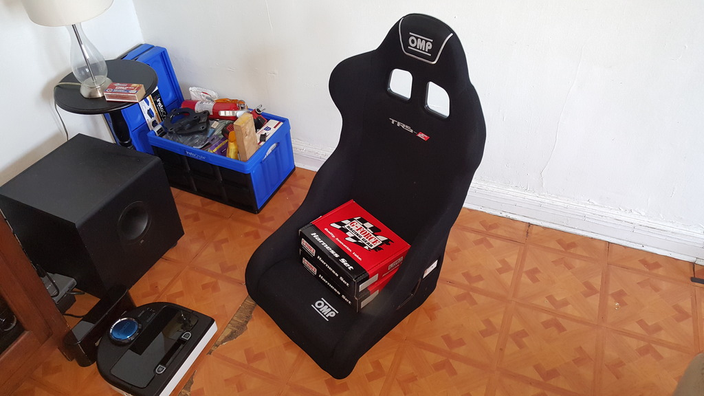

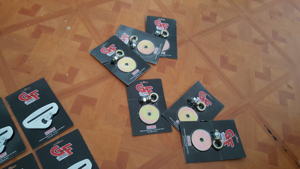

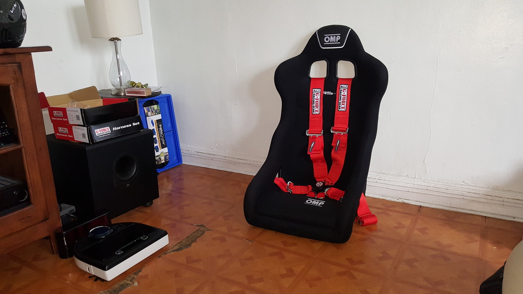

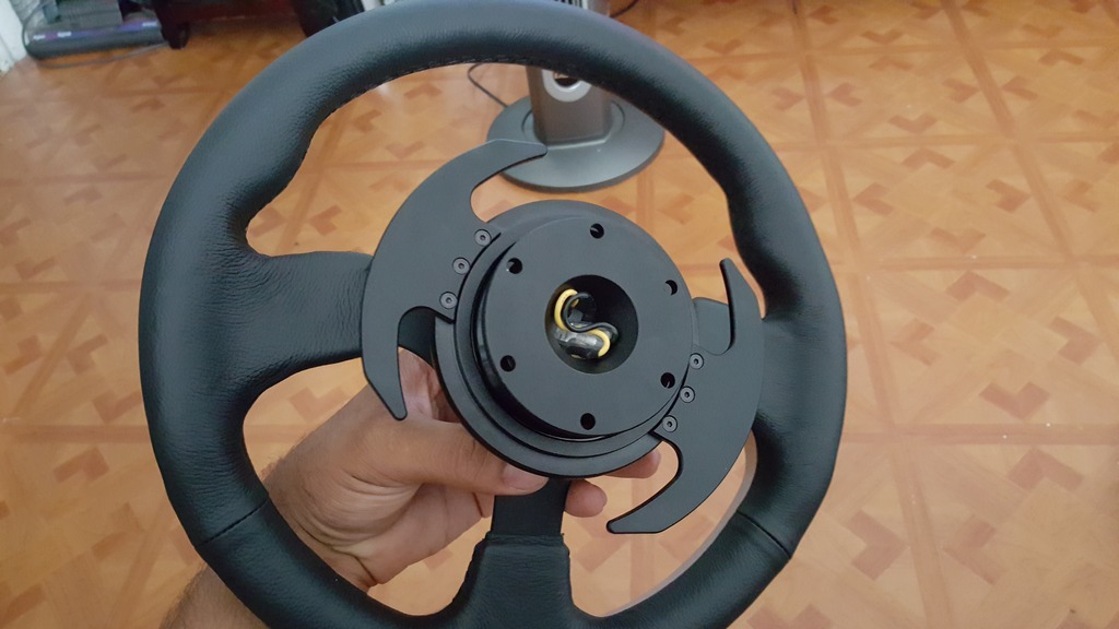

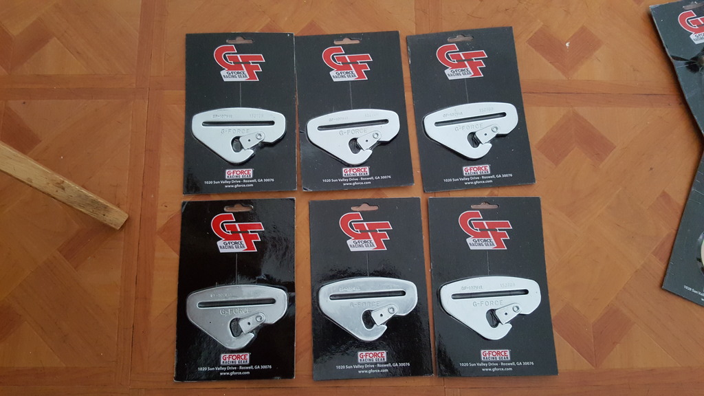

Goodies that have come in still waiting for others to come in. Too bad lots of them are going to come in on Friday, but ill be away on a business trip.
Harness and hardware
One Seat came in waiting for the other
Steering wheel/quick release, waiting on the MOMO crush steering wheel adapter.
Waiting for it twin to come in.
