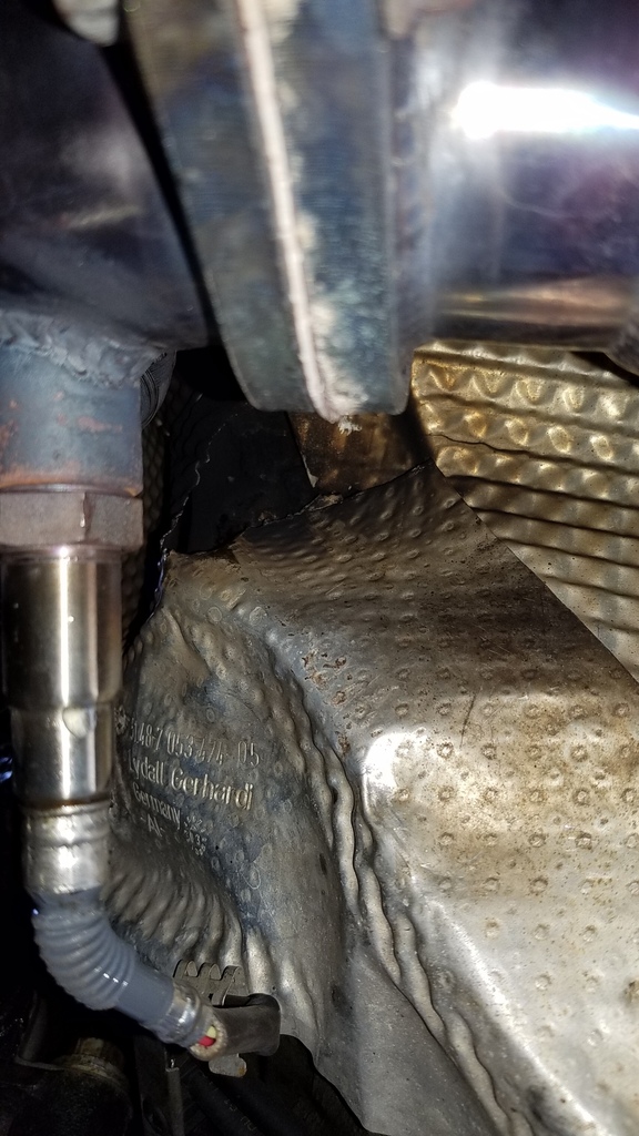

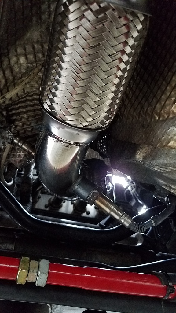

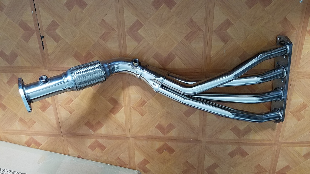

Finally got the exhaust mani. got the Bung installed. Installed everything yesterday and today i installed the motor mount that i had since like April or May. Broke the stock trying to press out the rubber bushing, But had other waiting.
Got the exhaust manifold
Took it the same day to get the bung installed

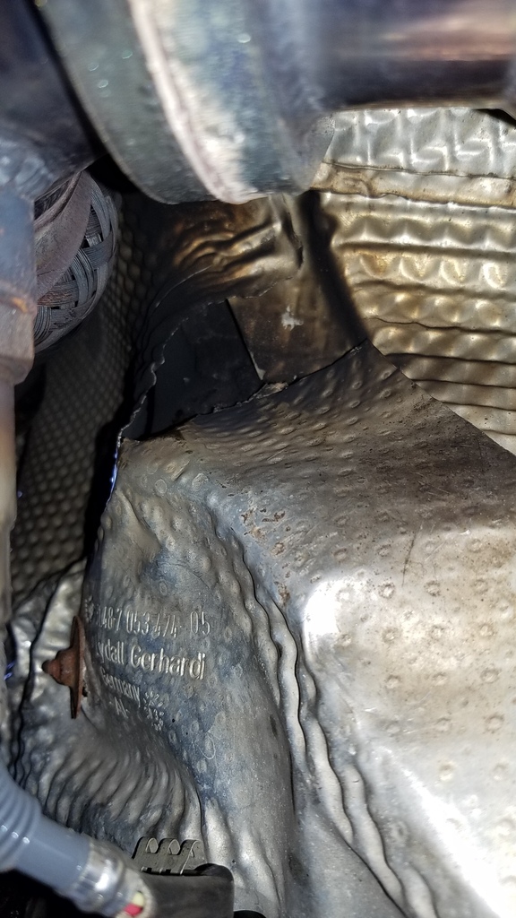

Here is the damage and what cause the smoke from the engine bay side. The AC drain was the victim.

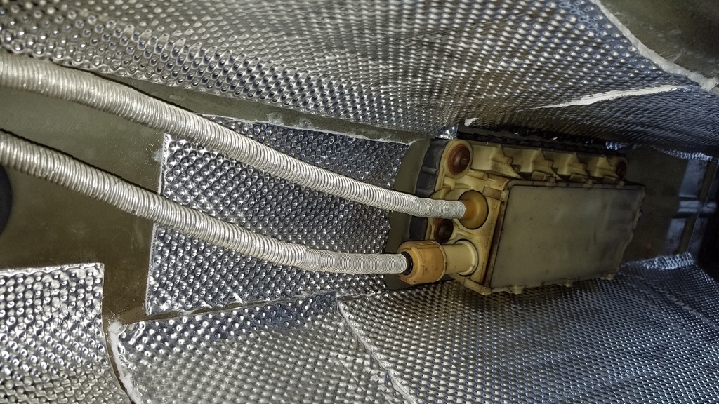

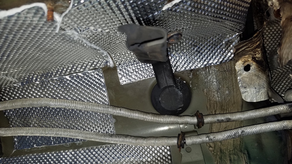

Got some of this to cover the Fuel lines that are right there really close.

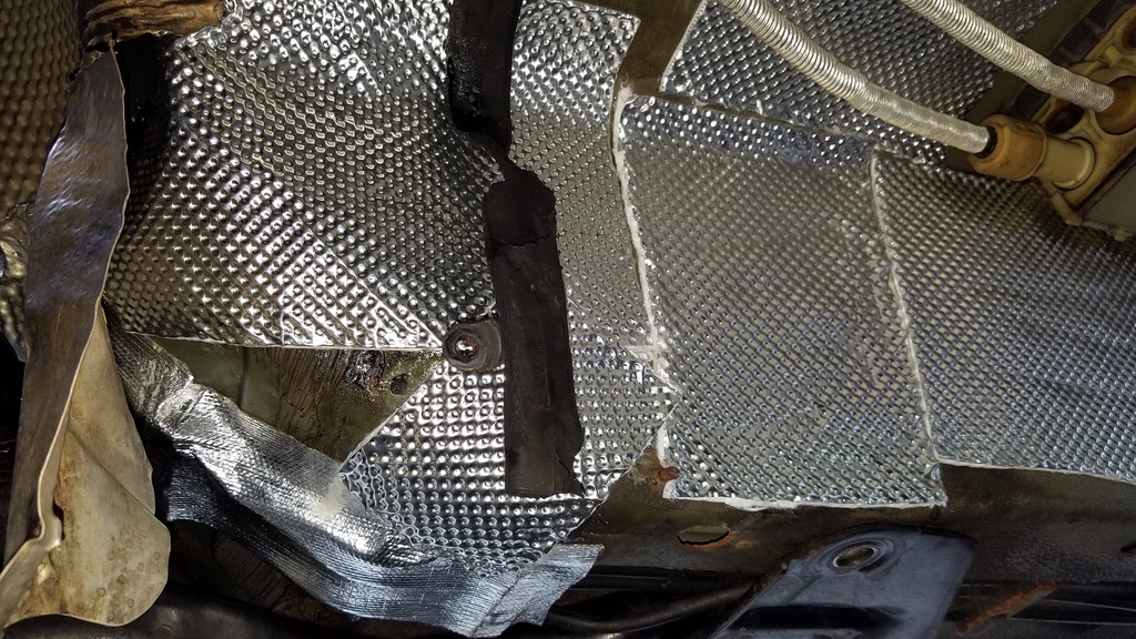

DEI Floor and Tunnel Shield (THIS SHYYT is expensive damn), But i got it anyway. the Tunnel inside the car was getting hot anyway. I have a feeling this was going on even before the track just that at the track it gave up.

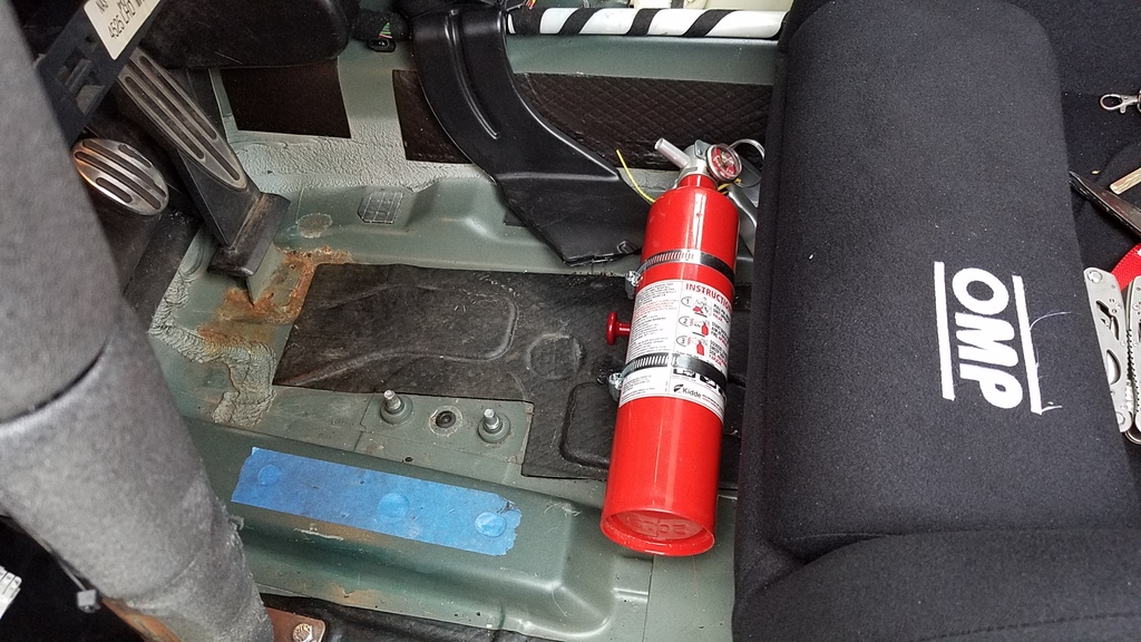

Fire Extinguisher Installed using a Drake Fire extinguisher mount. Alittle disappointed with the Drake, because it kind of shakes and all. not too much just thought it would have been a tighter fit.

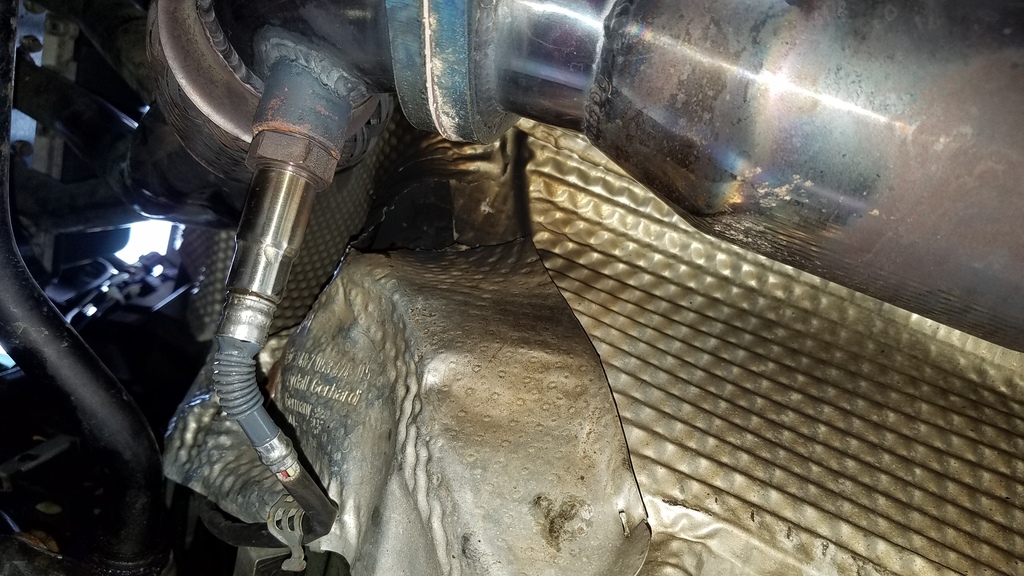

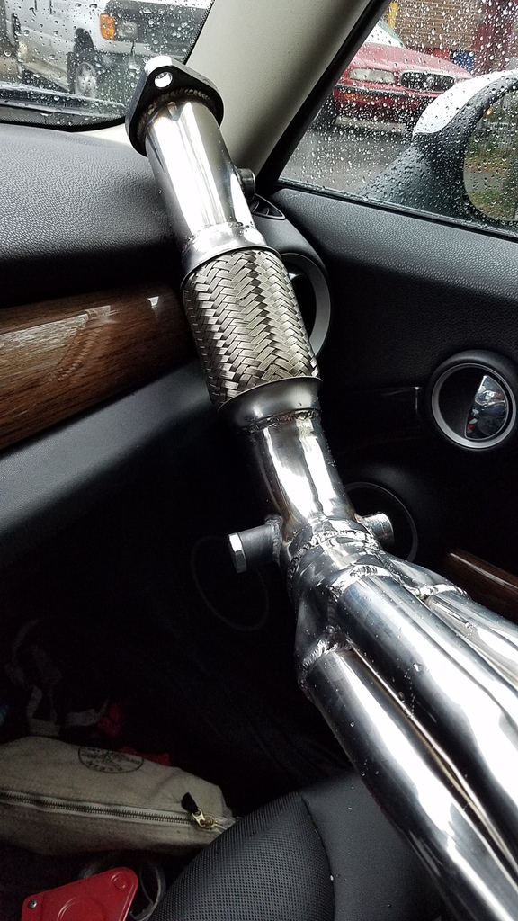

Here is the exhaust mani up

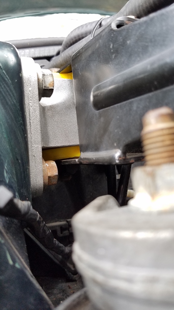

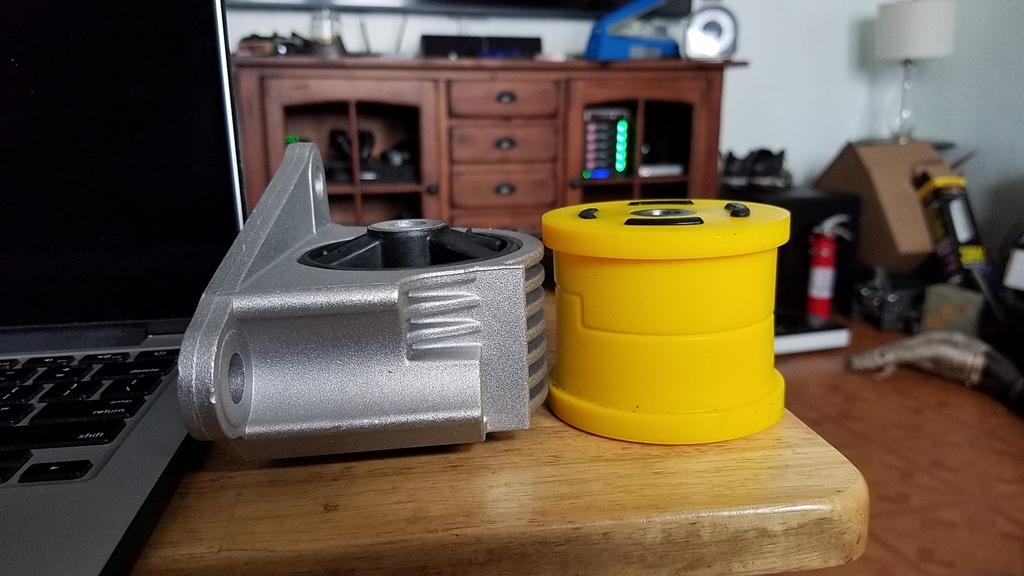

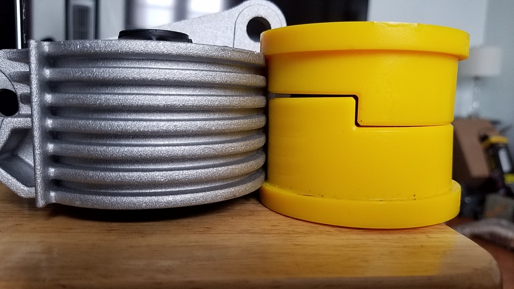

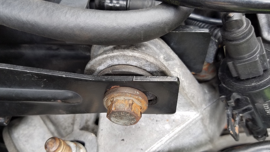

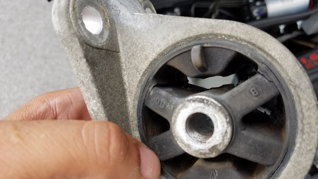

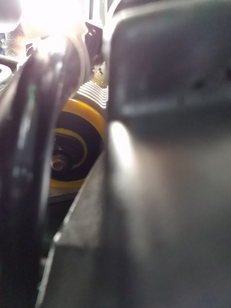

Today took the time to install the top motor mount/Torque arm and the Powerflex i had there for like ever lol.

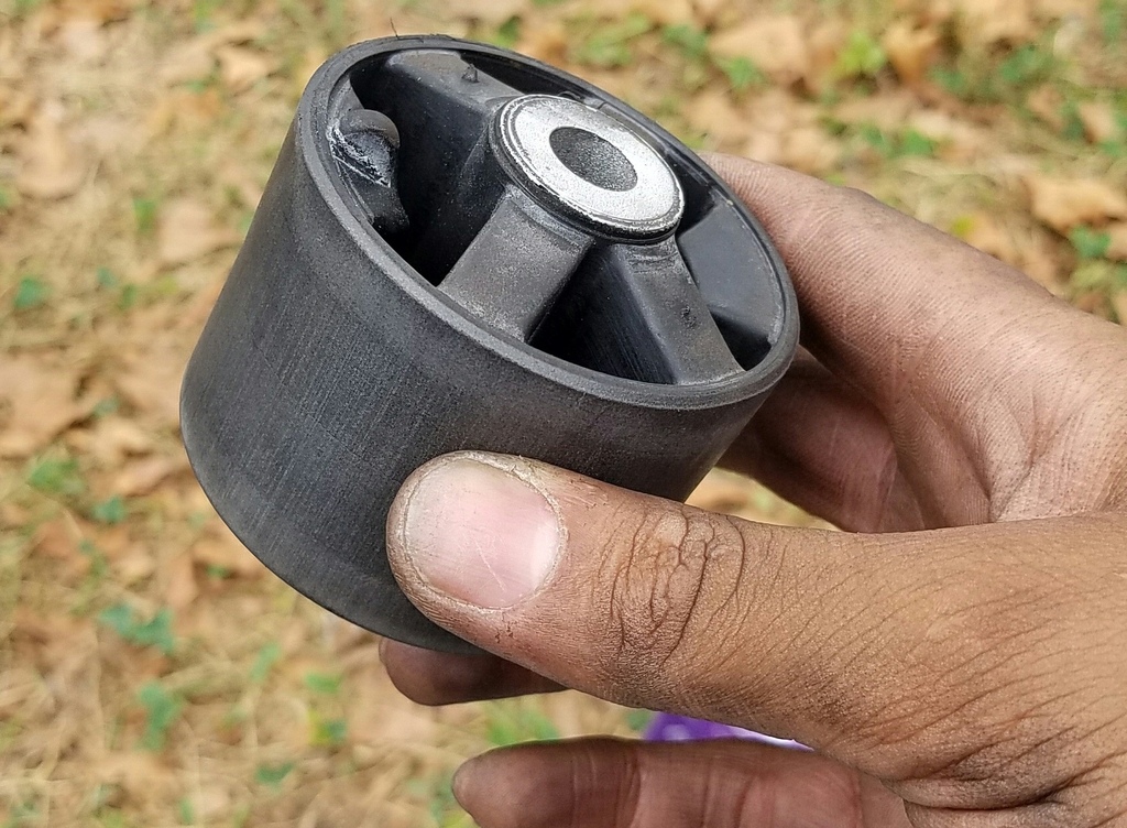

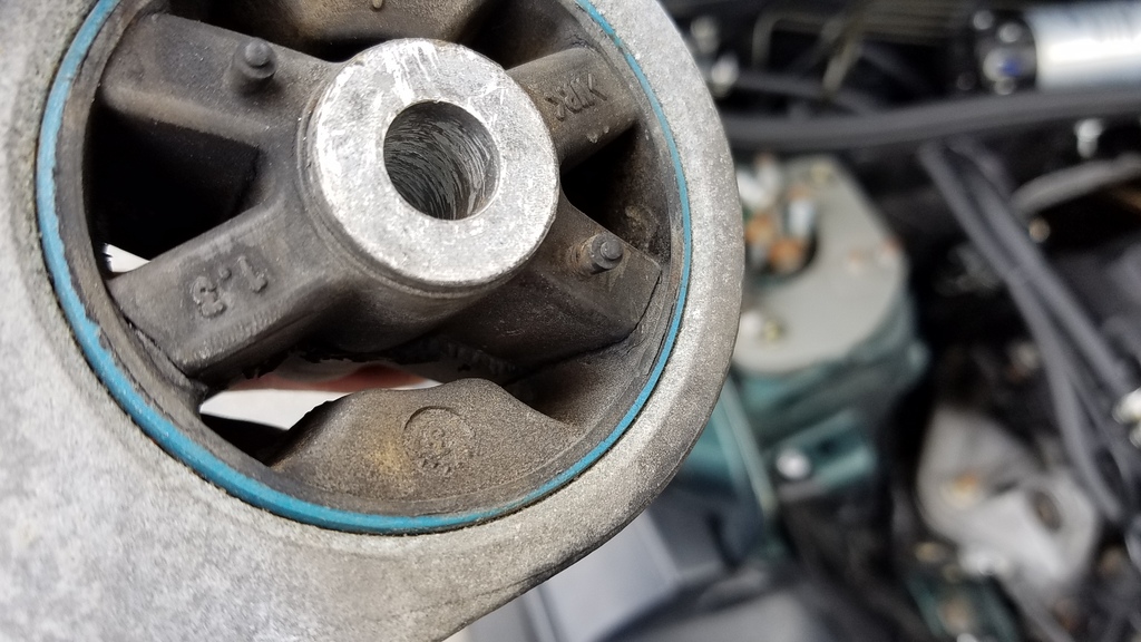

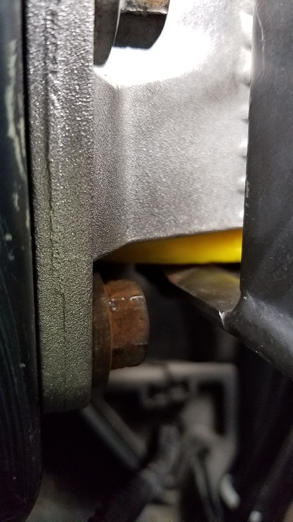

Little accident trying to press out the Old bushing.
I have a bushing for this end as well, does anyone have any idea how to take it off with out using fire or removing the motor mount. I mean i could take a Saw saw to it or something like that. (hope someone actually replies).
The bushing i took out If anyone want it just pay for the shipping and it yours free

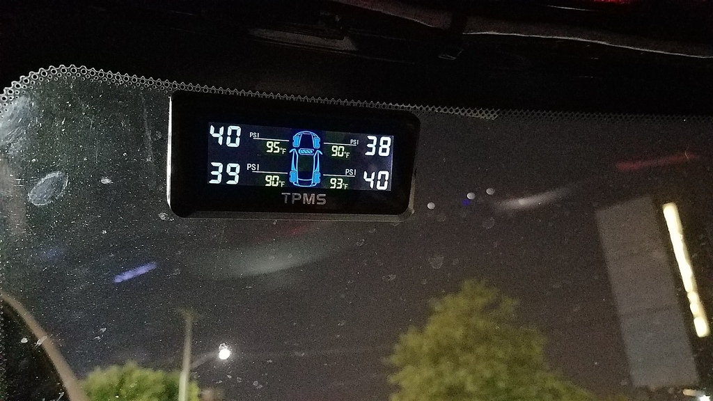

Forgot to mention. also installed this TPMS sensors.

So detailed with the job. I'm sure everyone here appreciates that, makes things alot easier for everyone else that will attempt some of these mods.
As for that last bushing it looks like with simple hack saw or sawsaw the job can be done in no time. Assuming the upgraded bushings are going to just push in like the others by hand.
Hey Tank - tell use more about this; like what TPMS reader are you using and where you got it, what sensors you are using, etc. I would love to have something like this.
BTW - I think your pressures are a bit high. I find anything over 39 psi is too high and the tires loose traction. I am down to 37 - 38 psi, hot, with the Re71s. I am even lower with the R888s.
Old Sep 4, 2016 | 10:39 AM
  #184
HaveATank's Avatar
HaveATank
Joined: Jul 2015
Posts: 460
My tires are all inflated to 38 psi and i keep them there while at the track and haven't has a problem with traction yet and while street driving they go up to 41psi you see in the picture, so a gain of 3 psi when at street driving temp. When at the track with a different set up (the sensors go on your valve stem mounted externally) the temp got up to 43-44 psi and after checking the psi after the session it was very accurate, My tire pressure gauge showed the same as the screen. So i decided to give this a try since they are installed internally. What i like the most is the solar panel charging screen (you also have the option to charge it via cable. It harder to see in the day time since the screen has lots of glare, but it does the job and you can still see it.
It something i found on amazon looking around for a TPMS since this car doesn't have one a reliable one.
This is what i got first to test. Similar thing with the screen being very dim in day light, but still visible.
https://www.amazon.com/gp/product/B0...?ie=UTF8&psc=1
This is the one that is in the picture.

I wonder if there is a way to just read the ones I already have. I know some of the BMWs can do that. Hmmmmm?

Eddie This is what it looks like at night
