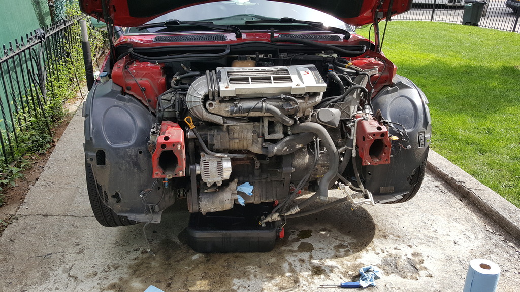

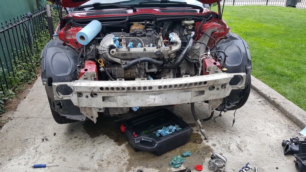

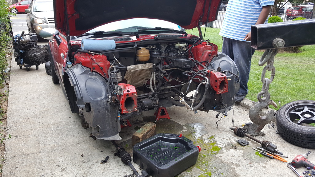

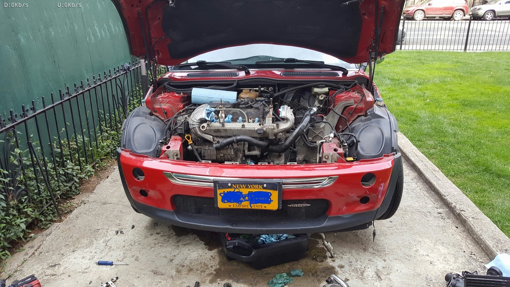

Pulling Engine

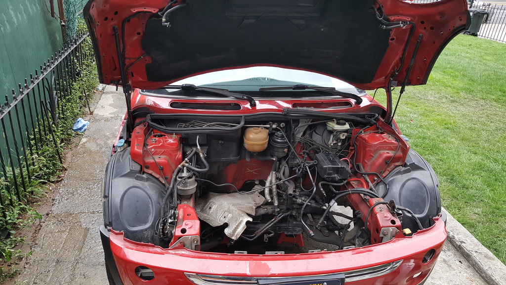

So today i started to take off everything to pull engine. Everything is disconnected and
READY FOR PULL.

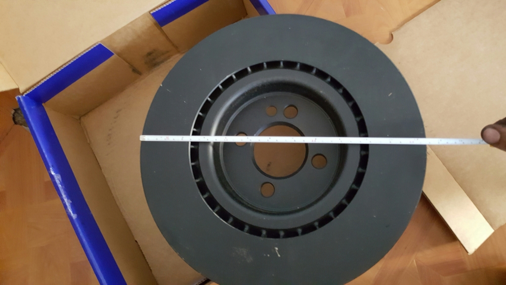

Eddie if i remember when we were talking you mentions that the JCW rotors are not 12" but it actually bigger it a 12.44" (316mm) for the R56 Brembos.

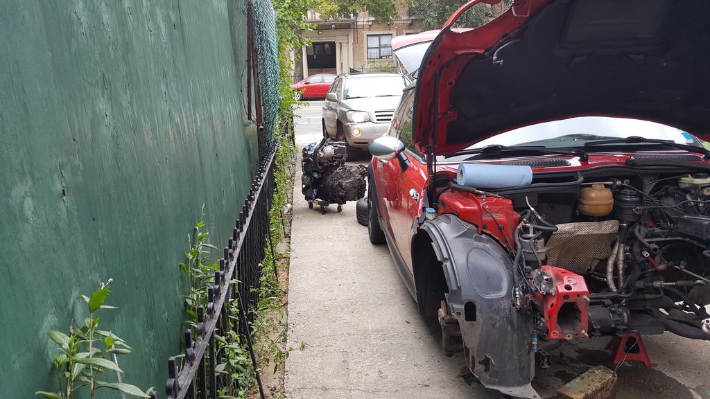

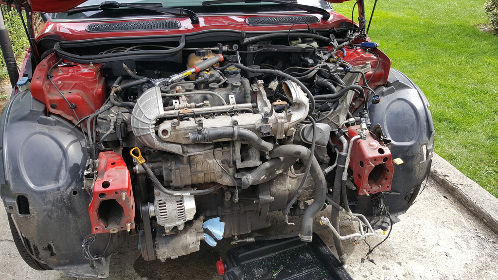

So engine is out. Need to separate the trans from engine. Guess ill start by cleaning it. it pretty dirty LOL. Got some help from a friend.
Strapped to a Dolly

Those JCW rotors are a pretty decent size.

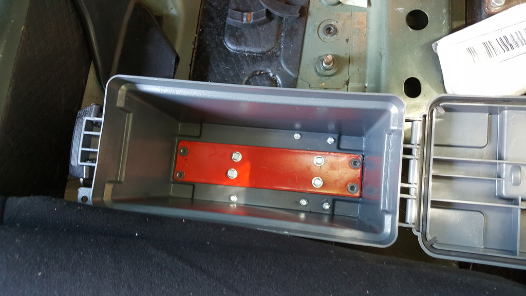

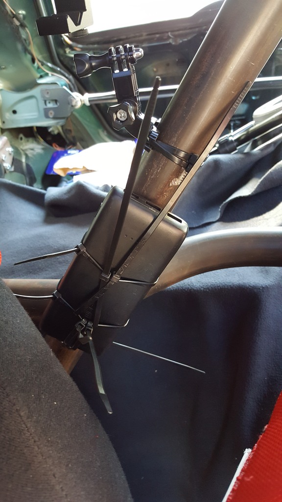

Swapped the tires and wheels. Going to the track this weekend. Also a little bit of mods. Made myself a Glove box, since i don't have one anymore and mounted a power bank to the bars to keep the cameras charged.
Glove box
No more door panels. had to secure the lock rod.

Got to love zip ties.
Have fun on the track.

Best ways to make a mount. I put some double sided tape and zip. No way that is going anywhere even if the worst happens.
