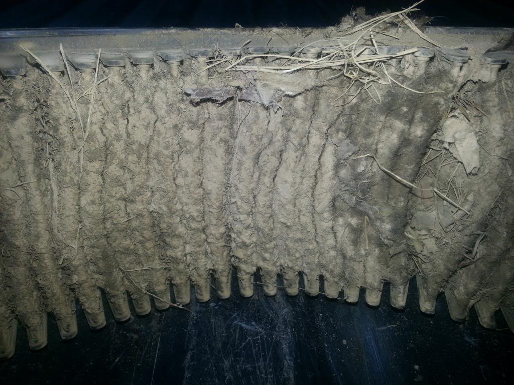

Hello ALL! This being my first post I thought I would see if anybody could top this!
This is the Cabin Air Filter and crapload of junk from my 04 MCS JCW. I bought the car last Oct. and have been working on it since. The AC was not working very well and air flow was minimal at best! Guess what? I found out why! It now blows like crazy.
Now for the problem! When the AC is turned on (equipped with ACC) I only get cold air from the 2 passenger vents, I get air from the driver vents just not cold. The rest of the system is working normally just no cold from driver vents.
Any help would be appreciated!
Thanks for looking.

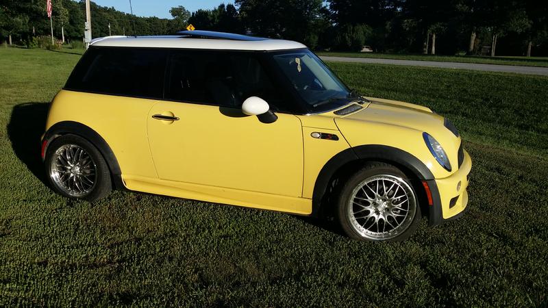

Here is the car as it looks today.

well, you have an 04, so taking the entire dash piece off should be just literally a few screws. maybe you can get to more of the vents that way, see if they are clogged.
looks like a neglected mini, sadly. on the plus side, you have a JCW with the aero kit!

Wow!!! The car must have been left unused for a long time for that much crap to accumulate! The interior also looks way too dirty, maybe they also left the windows open while it was seating there??

There have been a few posts of rats/mouse nests in/on the filter......
I would clean like heck.....your airflow issue might be resolved....if not...it might reach further into the ducts looking for more blockages....might have a nest or critter nest up there if the filter looks that bad....

And I thought my cabin filter was dirty when i picked up my 06 MSC. Check out the link. And boy did it smell in the cabin. My wife told me I'll never get the smell out. Ha, clean cabin filter some jars of oder out under the seats for a month and smells like NEW. Good luck with cleaning all that out. Get up in the vent with some bleach or cleaner and clean the vent tube good.

Wow, that's pretty bad, I have seen dirt and animals nesting, that must be from driving down a " dukes of hazzard " dusty road all the time. Must be original or just never changed.

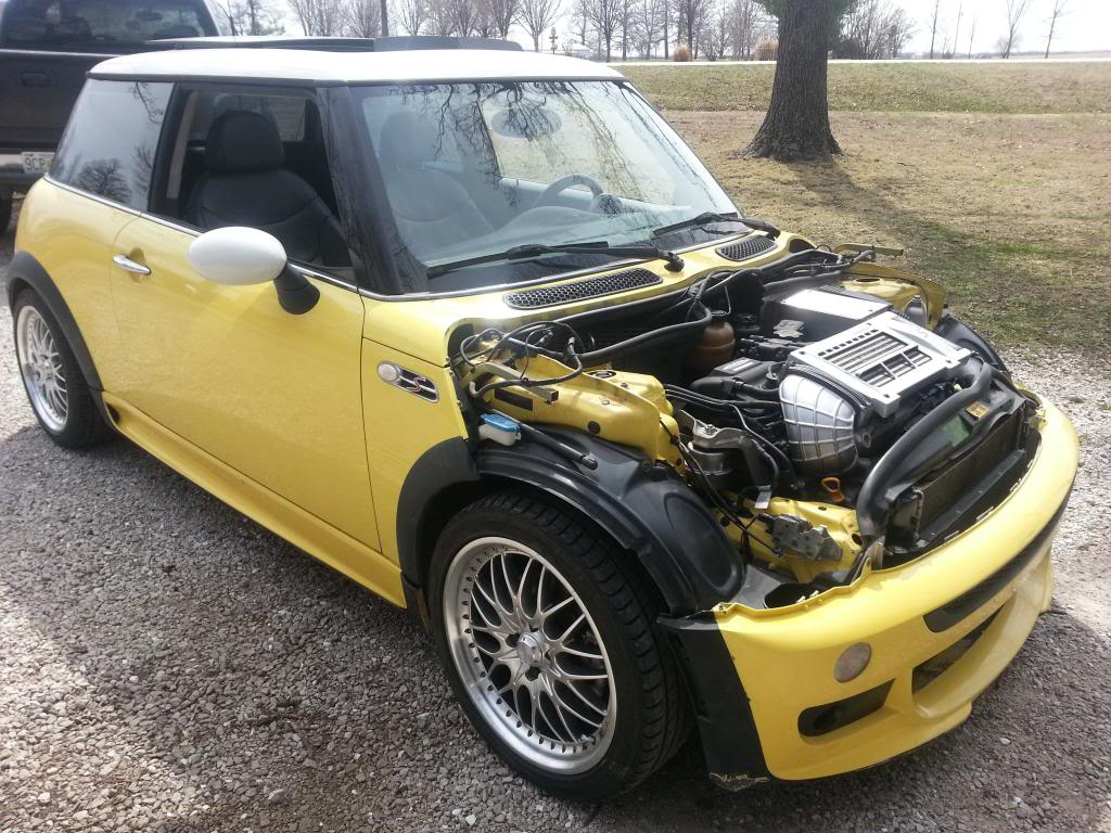

Just a couple pics of the progress on the JCW. Just have to add the factory hood stripes and the exterior will be complete. Just have a few interior issues to fix and the car will be complete!

Wow , looks good. Had to repost this a little bigger for you.
