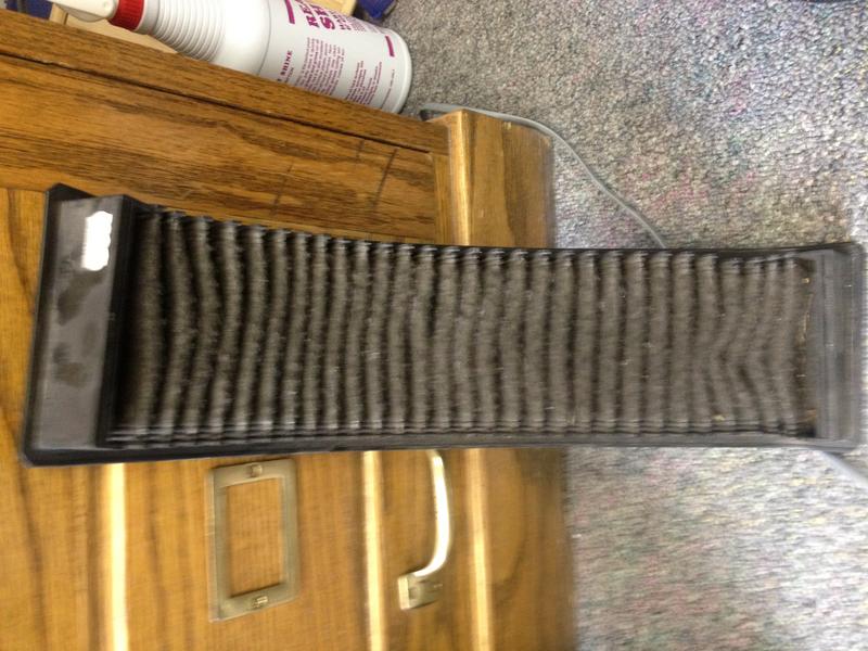

First Hello everyone. My name is Greg and I just recently bought my 1st MINI Cooper S. Love the car! I live out on Siesta Key, FL (West Coast-Sarasota), and I found my MINI down in Miami. Everything except NAV and Harman Kardon. It has the Chrono Gauge Pkg. I have to say I'd rather have the Chrono Gauges then NAV. It also had a Borla Sport Exhaust (aggressive) on it - didn't know that till I got there.
Anyway, road trip to Miami over Memorial Day Weekend. Bought the car and very much enjoying it.
First things First - flush all fluids and change all filters.
1st the Cabin Filter - You won't believe this, but look at the picture. The air in the cabin did have a smell to it. Couldn't figure it out what it was, but thought maybe the cabin filter is dirty. Well Dirty was NOT the word - how about a complete cesspool of garbage!
2nd the Air Filter - the car under half to full throttle felt a little sluggish at times. Well, opened up the air box, removed the filter and - yup - another complete cesspool of garbage in the air filter. I put in a K&N Drop-in Filter for the replacement and OMG - it is like a brand new engine and supercharger. My MPG went up by 3mpg. That is just crazy.

Those cabin and air filters are pretty common....

People tend to forget about that filter and don't change them. Mine was pretty bad too when I changed it last year. I'm about due for a new one...
