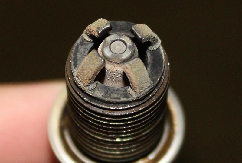

I bought my '02 mcs with 85k miles this week and decided to do a home service. This is basically an inspection 1 and 2 plus some very important fluid maintenance not covered by 1 and 2 such as bleeding clutch, brake, changing coolant, etc...
First thing I changed was the cabin air filter. Took about 15 minutes. Here's a pic of the old one. Yikes!
Also, the air filter was just as bad. The spark plugs (probably original) were not too shabby considering how many miles they weathered.
Attached Thumbnails Reminder to change your cabin air filter-cabinfilter.jpg   Reminder to change your cabin air filter-airfilter1.jpg   Reminder to change your cabin air filter-img_2293.jpg
