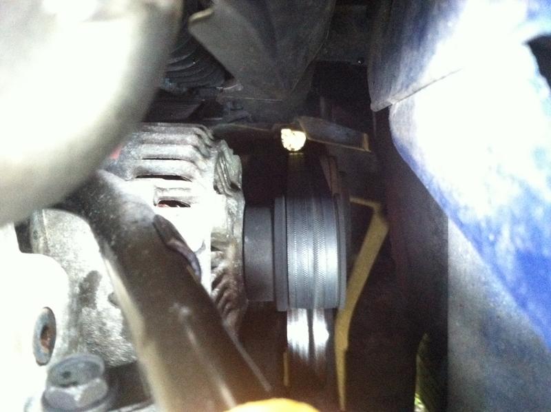

So here’s the deal, I just recently purchased an ’05 MCS with 72,000 miles. I am thinking that the SC belt should be changed. I believe it should have been changed at 60,000 –but it doesn’t look very new to me, and I do not have much for service history of the vehicle.
Previous owner put an ALTA CAI on it, and a Screamin’ Deamon Coil Pack. I’m not sure if he changed the pulley or not. Very difficult to take photos in there but I tried.

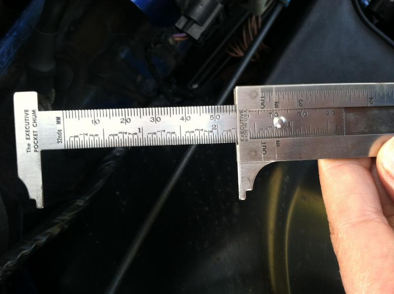

The pulley doesn’t look like anything special,.. I mean it’s not a machined billet aluminum or anything that I can tell. It looks like a basic typical common steel painted black by manufacturer. I tried to reach in to measure the outside diameter of the SC pulley. I get a little over 65mm, but with it’s location as I tried, I couldn’t tell if the inside of the caliper was catching on the edge of the pulley on the far side, or if it was up on top of the belt… so could be error a little.
What do you think, is it original, or did the previous owner put a smaller pulley on it?
Also, what are your thoughts about this belt? I wonder if this cross-hatch diamond pattern as observed on the alternator pulley is an indication of wear. Was the factory belt smooth, and this is showing the nylon cords coming through now?

cant tell from the pic....
But the OEM is a hot pressed steel pulley. Factory belt DOES have a bit of texture..it is a cont-tech belt, 1388 MM for the stock if I recall right.
Most every aftermarket pulley is CNC machined, with bolt holes...colors vary, but better ones tend to be stainless steel.
Determining from measurement is hard cause the guide groves on the side of the pulley stick up....

Yes, that is stock. If you were going to install a reduced size, then go with Cravenspeed or Alta.

Yes that pulley in your pic is the bone stock non JCW supercharger pulley.
The 15% 16% 17% sizes of our aftermarket pulley represent the % smaller than your stock pulley, and in tern spins the supercharger that % faster.
The stock belts NEVER had a cross hatch pattern on them, I tend to avoid those cross hatch pattern belts as they tend to wear and crack sooner.

Tab32 is right, that is stock. The percentage is the percentage smaller over stock, so a 15% is 15% smaller than stock etc...

Originally Posted by AlexQS
CONFUSED NOW
Anyone else have a comment on weather or not the factory belt had the cross-hatch marks?
Zippy was refering to the texture on the back and he is correct.
I was refering to cross hatch patter on the belt grooves themselves.
That belt on your car looks to be the original conti belt.

Good News: I visited MINI of Portland, they did a quick 10 minute visual inspection of top side of engine for free. That was nice of them.
-I made the trip mostly, because of the clutch chatter noise. I suspected that it was the dual-mass flywheel I had read about, but I wanted someone with experience to listen and confirm. This being my first MINI I wouldn't know if I had been hearing the throw-out-berring getting ready to die. -So they said the noise is all normal and fine. The piece of mind is priceless ot me.
Also they looked at my belt. It is the origional, showing some signs of wear, but no cracks on the grooved side. I plan to do something about it in the next few weeks or month or so. I don't think it's so urgent that I have to do it tomorrow.
