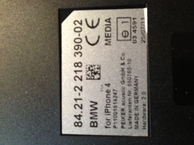

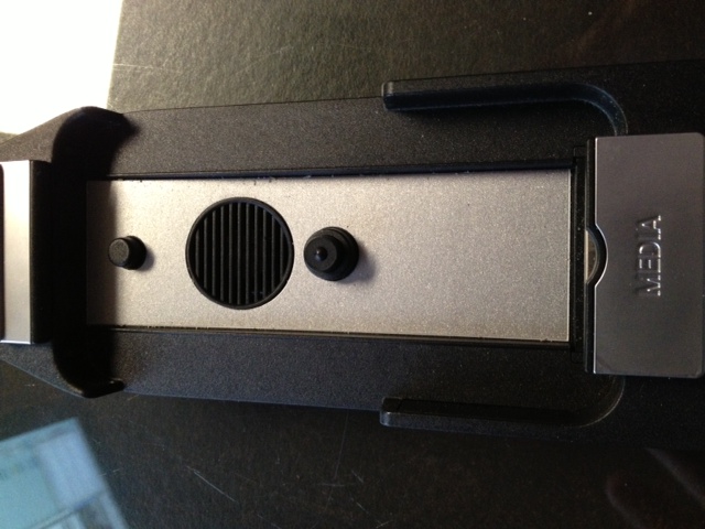

MiniDan…. That's a looooong story. But to keep it simple & short. Yes it does. Ofcourse with vehicle at stand still and E brake engaged. Hoping the prochip from the guys in Germany will otherwise allow it. Not sure if it will be through the cradle but sure sounds like it will with the provided Y cable. As far as the cradle. with the help of New Country Mini, both service & parts, especially Parts Mnger, Darin Stricker, I've purchased, tried and returned every possible cradle out there. I've been using the existing one for just over a year now. No problems going from the 4 to my current 4s including all IOS updates/upgrades. This is the one that will charge, supply Album Art and provide you video, take calls..even siri works but you need to get to the phone to activate. Hopefully sooner than later there will be some type of update to use the phone button on the wheel...…I've attched a few shots of the Snap in Cradle PART # 84.21-2 218 390-02. There may be a new model out there. But this one does it all. Obviously nothing for the 5 as the physical dimensions have changed, and it sure sounds as Mini/BMW have no interest re-tooling for the 5, probably close to a 6 later this year.
Attached Thumbnails Is it possible to mirror iPhone display to mini connected?-photo-101.jpg   Is it possible to mirror iPhone display to mini connected?-photo-102.jpg

Thanks, Flyer! I do recall reading that long thread where you were trying all the cradles, but I couldn't see for sure that the one you finally settled with really supported video.
I actually have an iPhone 5, but I presently keep my old iPhone 4 in the armrest, connected via the Y-cable. If I can get the same functionality with a snap-in adapter then that makes everything a bit cleaner.
I have found the video functionality to be useful while waiting in the car with the kids, or even by myself.

Yes…you should have no issues with the 4 and that cradle. Start the mini connected app prior to popping the phone in the cradle and you'll get google search. google send to car(my favorite) ofcourse FB and all those apps as well. Still waiting for my chip from Germany…that will supposedly let me watch videos any time. Purchased a Proclip that snaps on to the dash to the right of the CD Player…made just for the Countryman, looks great. and a 2' extender for the Y cable. So i'll have both options if doesn't work via the cradle…it's been proven via the Y cable. I was thinking of doing the same…keeping the 4s as it fits the cradle and get the 5 or hold of until the 6 and use it via the cable…..
