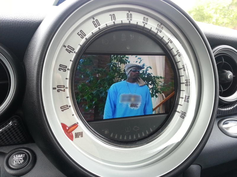

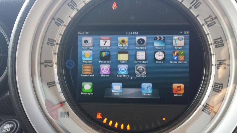

mirroring and video in motion off my itouch
Attached Thumbnails Is it possible to mirror iPhone display to mini connected?-4149433188524978717.jpg   Is it possible to mirror iPhone display to mini connected?-img_20121024_112828.jpg

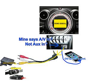

Hello!
I am trying to pretend to "play a video" and then use another video cable, not the one from the Iphone.
I tested with a backup camera using this setup:

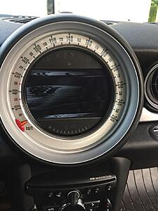

But the result is this:
What can be the reason?
Maybe the display thinks the resolution coming in is same as the video from the iphone? So it has problems showing it?
Camera is: 628 x 582 PAL Signal System (I live in Sweden.)
Thank you very much for support!!
Take care friends.
