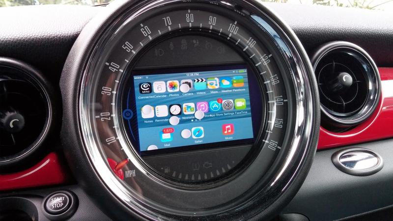

here is mine with iPhone 4, iOs 7 and 2012 jcw with connected and nav package...connecting using the usb and aux port.
Attached Thumbnails Is it possible to mirror iPhone display to mini connected?-mini-connected.jpg
