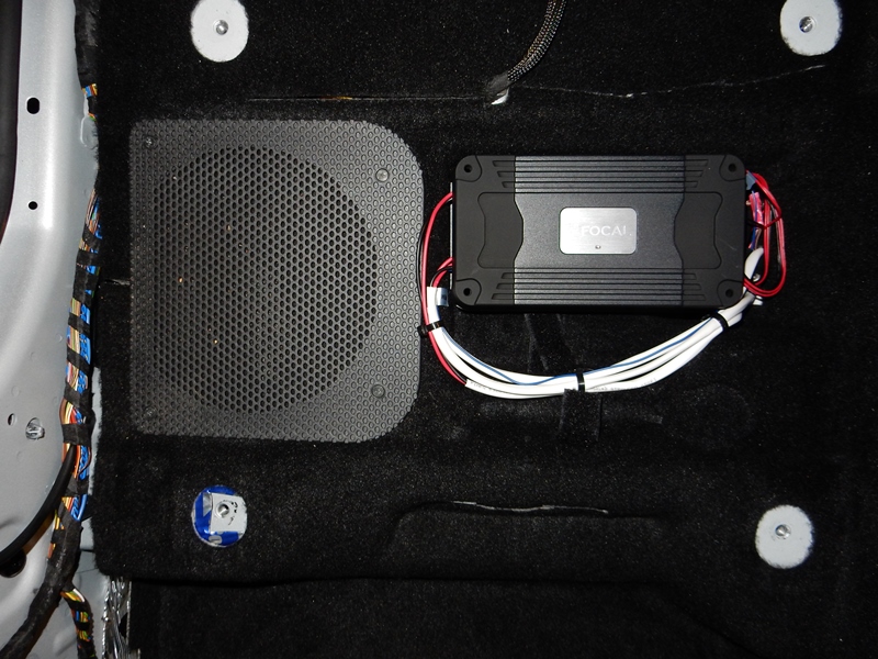

Which amp is that?
Focal 4ch amp:
http://www.crutchfield.com/S-LECmZQV....html?tp=35782
Small size, decent power, crossovers, and high and low signal inputs.
Oh, and its a Focal.

Picture worth a thousand times more than two figure typing. Pardon the poor picture and the filthiness of the car. The amp is bolted to a plate that is bolted through the carpet to another plate I installed on the backside of the carpet. When I turned in the car, it all came out and it looked as if nothing was ever there. 100% factory look once removed...... no cutting.
