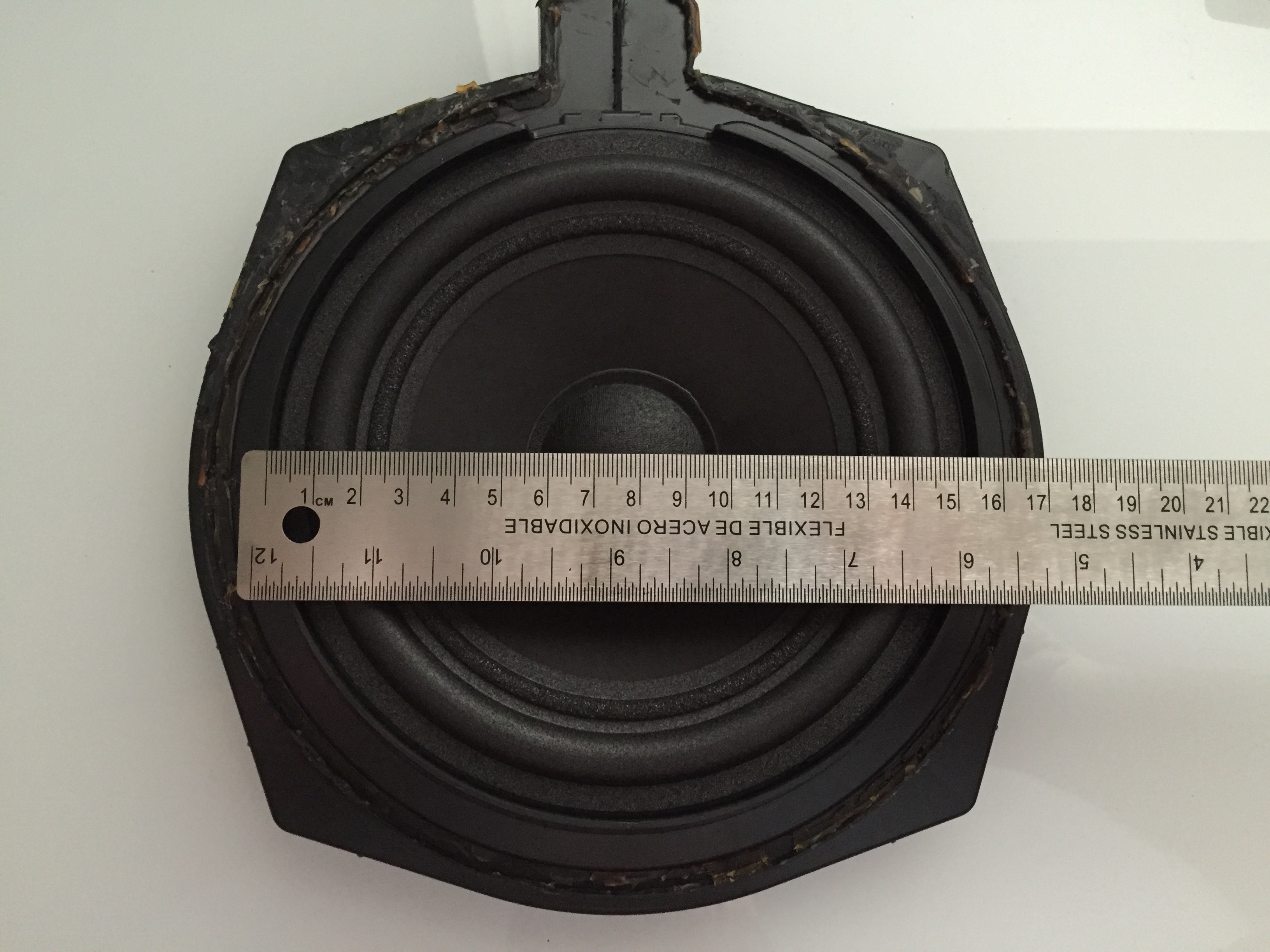

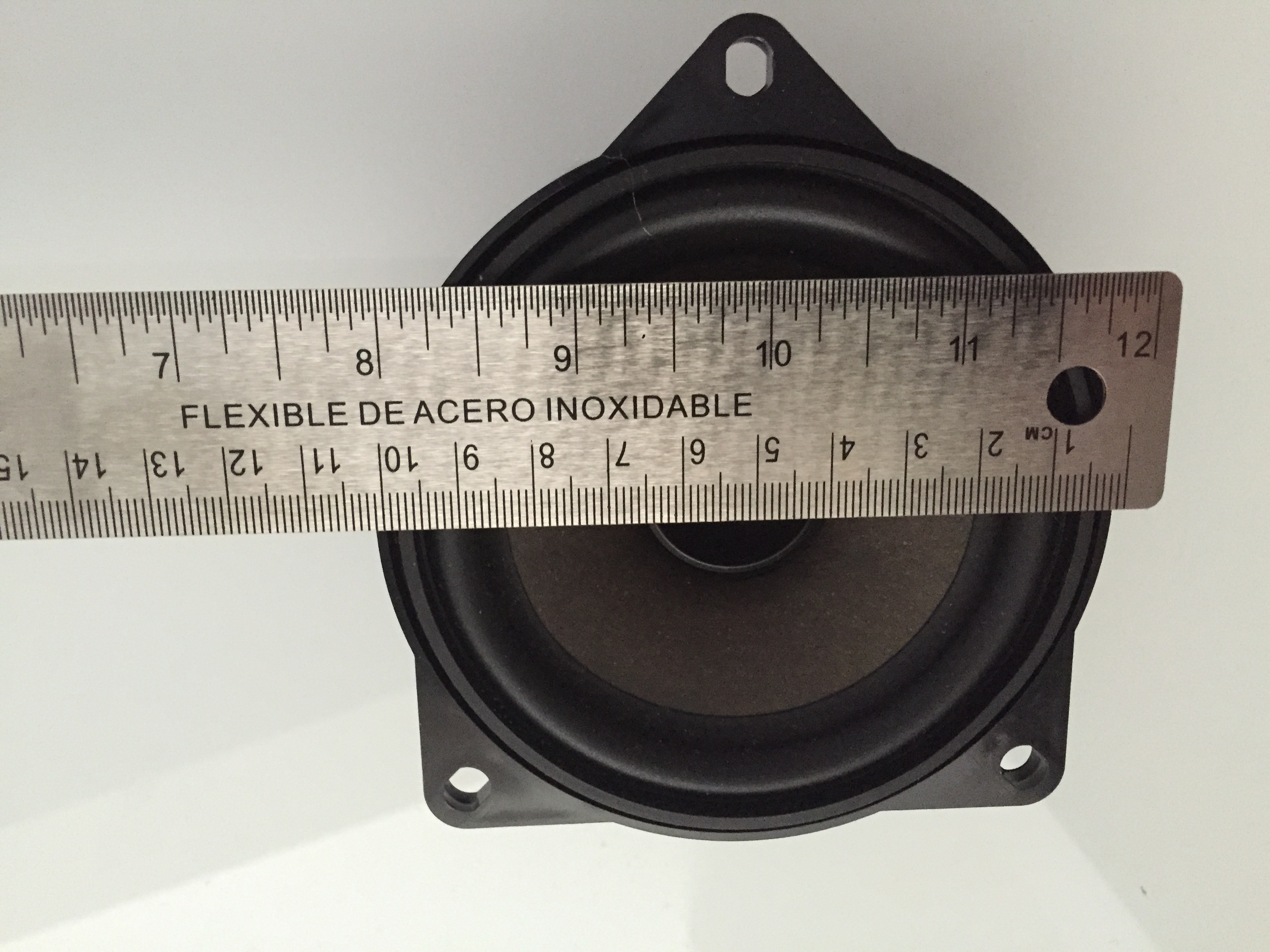

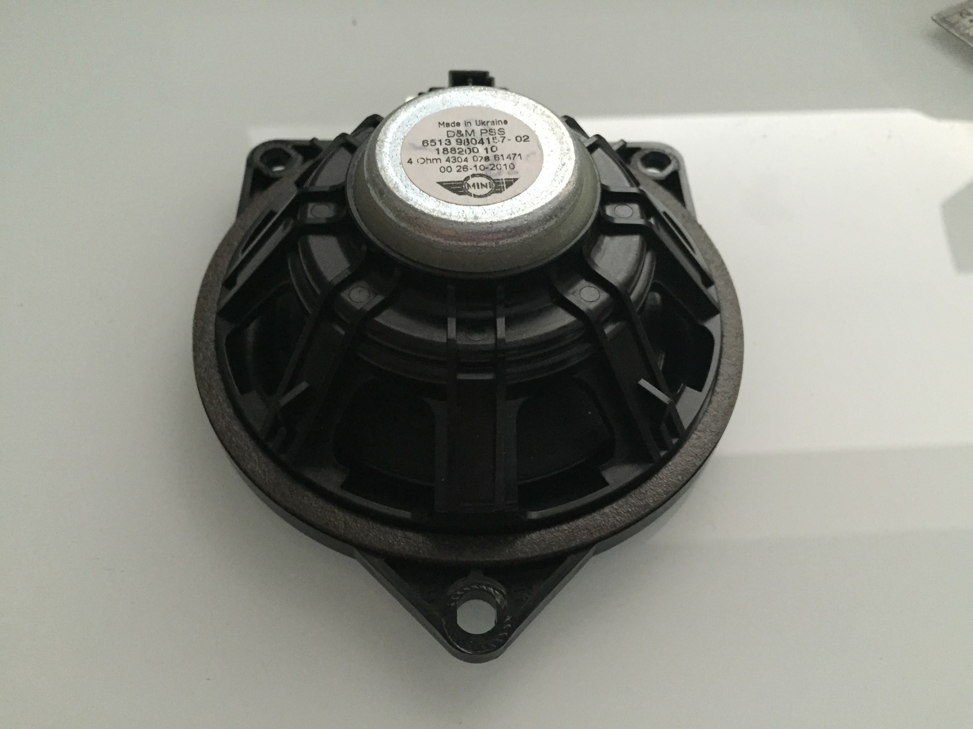

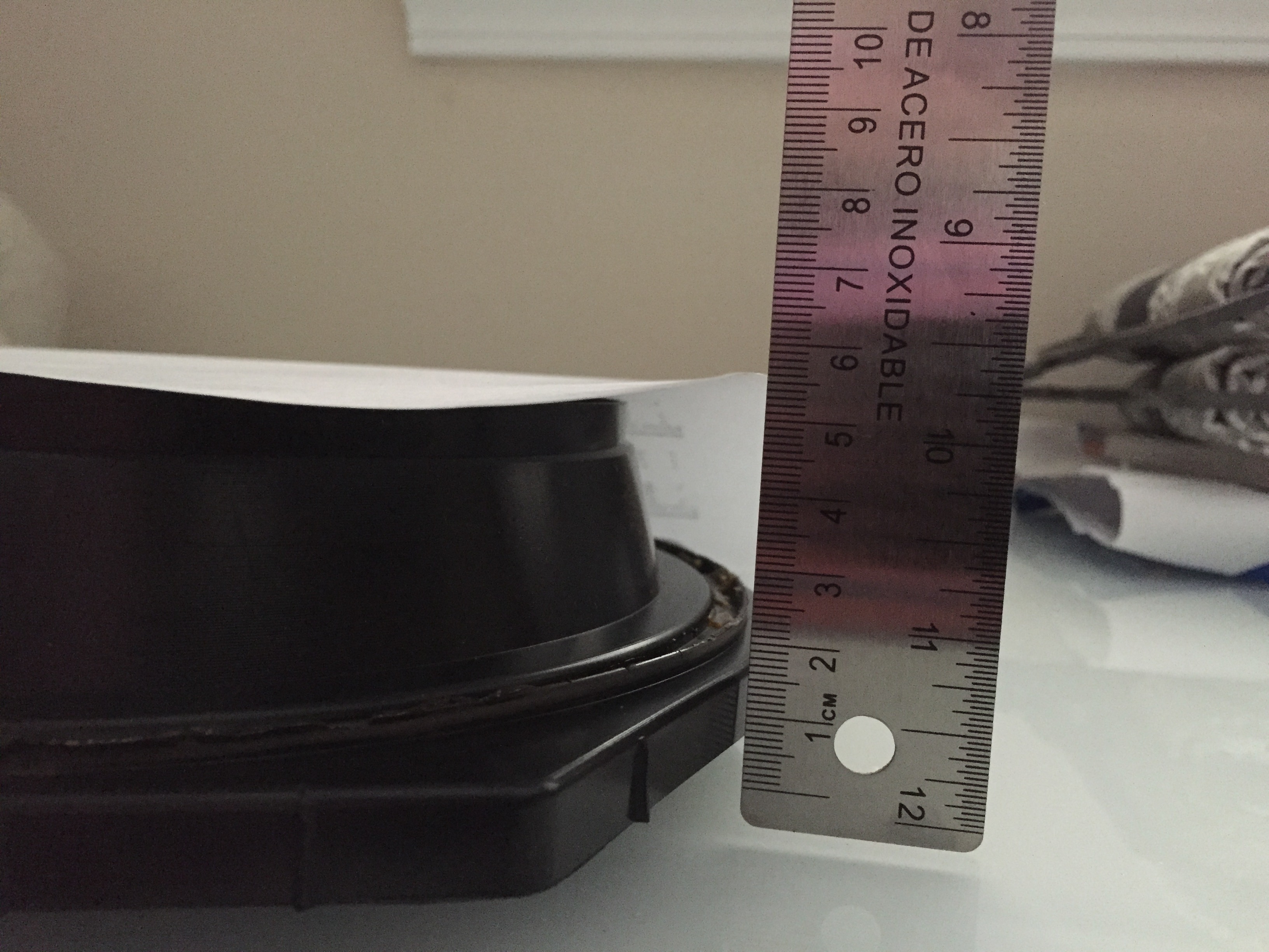

MINI Countryman R60 Door Speaker sizes, pictures, and measurements
I used this post to order the HK pillars. Thanks they came out great. I wanted to post the sizes of the stock speakers that came out of the front and rear doors and the under the seat woofer. I also attached the replacement set that I used "MB Quart QM200.3BMW 8.5" 4 Ohm 3-Way Speaker System For Select BMW Vehicles". I does say BMW but it is correct and the 8.5 fits.
Thanks for the great info on this post, it help a great deal. Be careful when ordering replacements, the fronts are SO SHALLOW but the MB Quarts worked great. I was able to install "Focal Access 100 CA1 4-Inch" (refer to pic) in the rear, BUT THEY DID NOT FIT IN THE FRONT.
