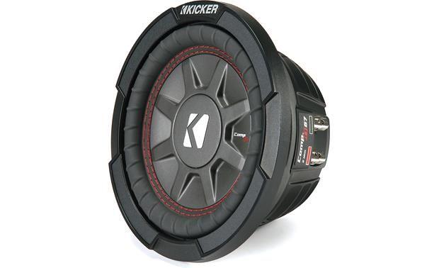

My thoughts, for R56, are to put a pair, L&R, 6.5" Subs in place of the 6x9's in the back in place of the factory 6x9" ... Then.... Put some really good sound damping on the body panels (inside and outside).... and run those with a decent amp.
Will it be as good as a sub box in the back... probably not...
But I'm not looking for true audiophile quality sound... not really... but, IMO, it does not have to be "All or nothing"
If used with a good crossover in the amp... will it give some really good bass and NOT take up extra space in an already small car ... definitely.
Kicker CompRT 43CWRT672
https://www.crutchfield.com/p_206CWR...72.html?tp=111

Actually I have a r52 convertible, so it should be easier for me if I want to go that route. I'll definitely do sound deadening. I don't need a lot of bass to be happy, just enough for it to sound full. Are you saying that an external subwoofer maybe under the seats wouldn't be practical? I was really hoping to improve sound quality in the backseats, it sounds awful back there right now. I build stereos like boomboxes and stuff as a hobby, so I wouldn't mind building an thin enclosure for a sub or two under the front seats, but I have no idea as to how much room is really under there.

If I could go with thin subs under the seats... that's how I'd go.... this seems to me to be the best route and not have stuff taking up already small space in the car.
This is actually what I prefer to do, I have no problems building a custom enclosure so it can slide under there, I just have no idea how much space is truly there under the seats.

Not enough space for a sub there... a thin amp (2" thick) and only with the 2" if you cut out the carpet and ALL the padding down to the bare metal.
