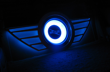

trunk ideas
I did a quick flip through the pages and there are some good ideas out there. If you are looking to keep some trunk space, then building up the trunk floor a bit would be the way to go. You can probably fit an amp under the new flooring with a sub to the side. I got done last year with a 10" Image dynamic sub in a fiberglass enclosure with 2 Alpine PDX's, a Stinger cap (in pic below) and under those, concealed, is the component crossovers, ground block and fuse block. I am currently working on painting the amp enclosure red to match the exterior and an carpeted lid with plexi glass. Not like I would probably put anything in the trunk but at least I know I can.
Has anyone had issues with the inside front door panels rattling no matter how much you dynamat it? I had to fashion a bracket out of MDF and noticed the rattling after install. Then I took them out and fiberglass them to make them more rigid, then dynamated them and still rattle (pic below). It does not rattle as much when it is hot out but it is definitely the door panel because when I push it in near the speaker it subsides. Has anyone relocated their front components to another location like on top of the dash?
