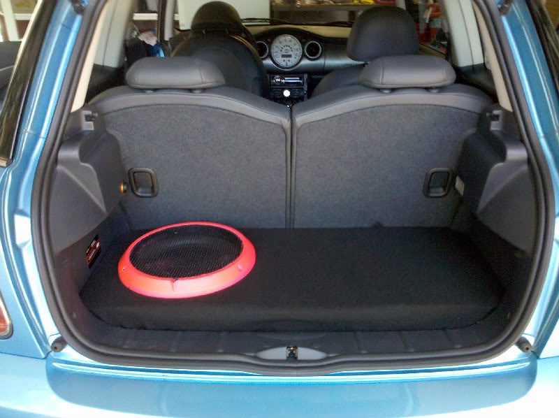

I've been waiting to show this off for a while the sub is a Rockford Fosgate P3S412 a 12 inch shallow mount. We built the box so that it has 1.1 cubic feet of air space, the amp recommends .7 or 1.3. We erred on the side of caution, but probably could have gotten it a half inch shorter and still have been good. It sits flush with the rear seats went folded down. I painted the sub grill hot pink for fun.
Box pre-false floor
Finished product
With the privacy shield down so you can see how much space I still have

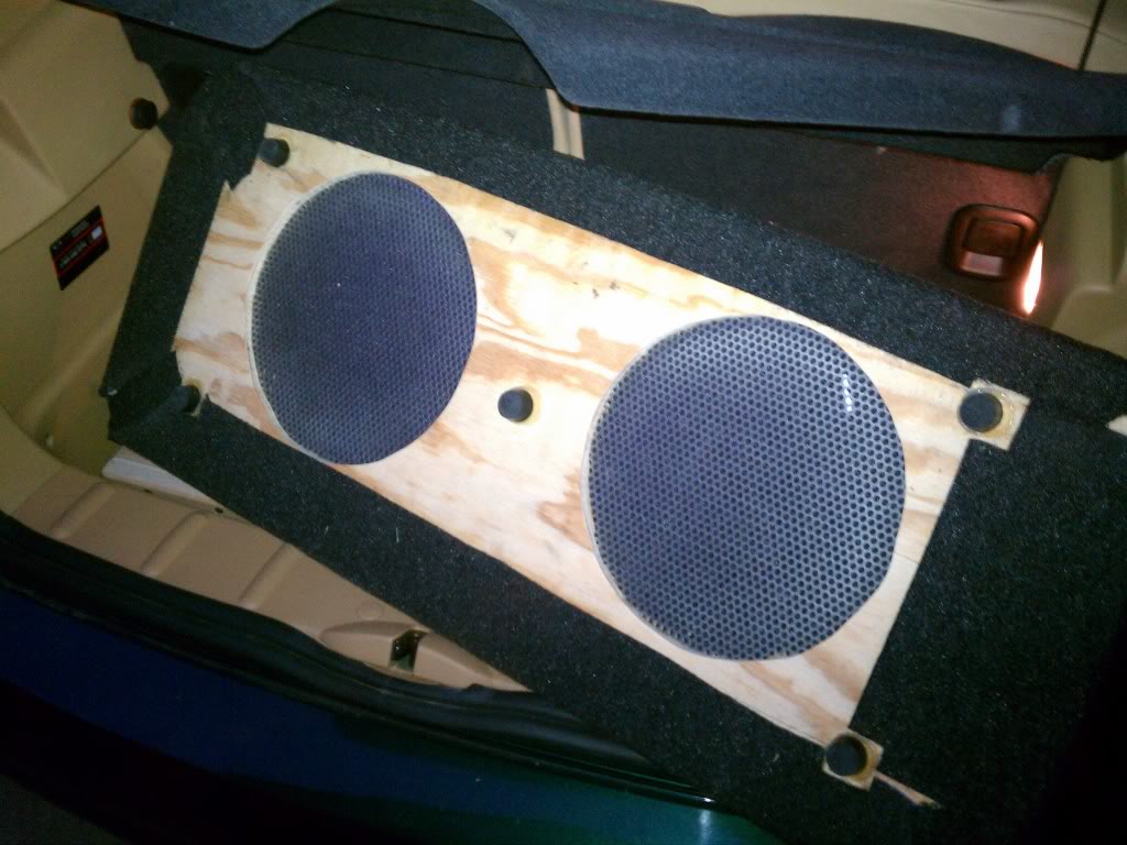

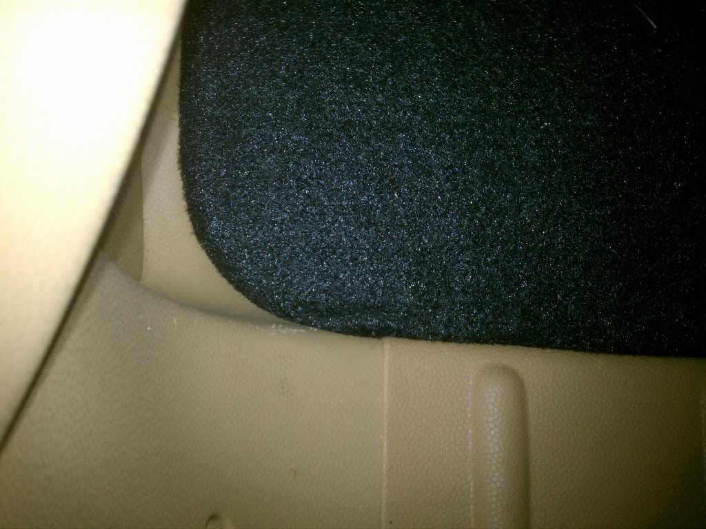

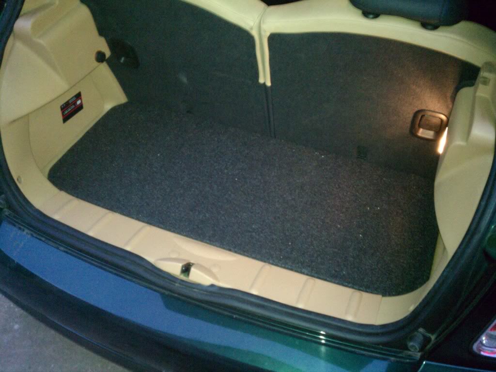

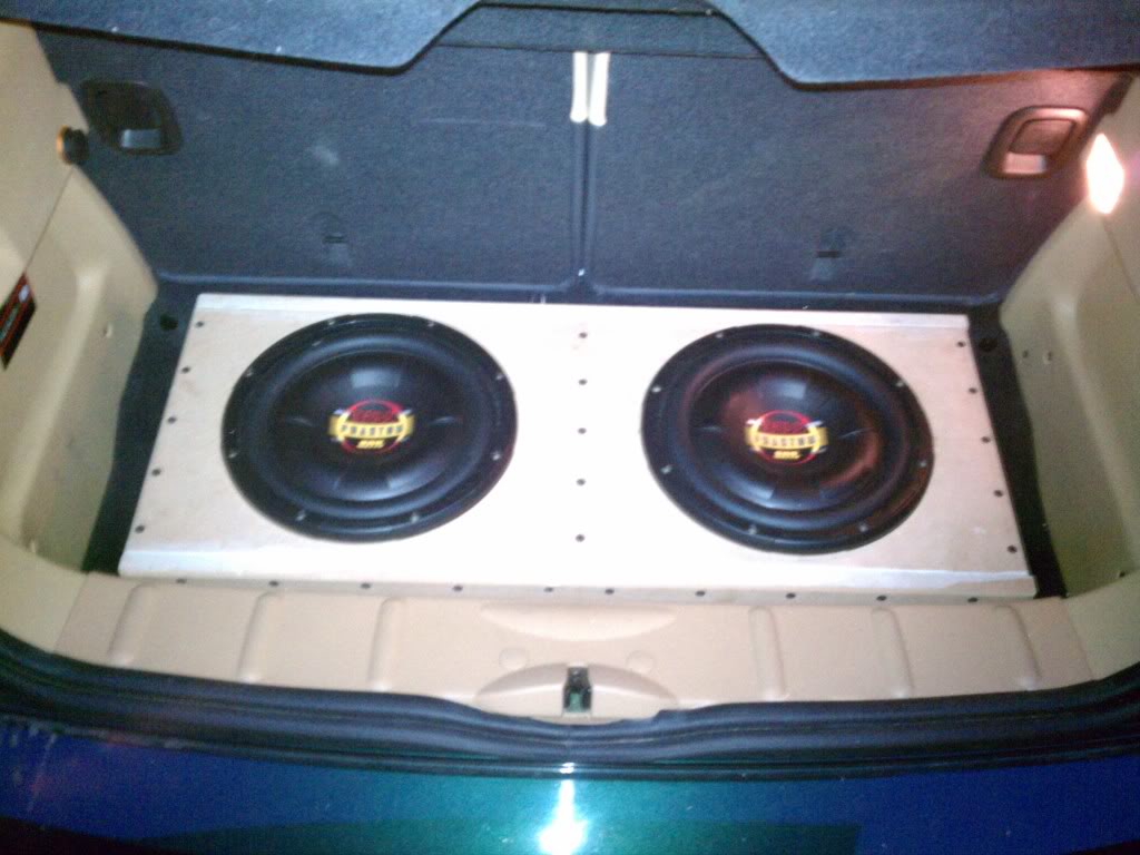

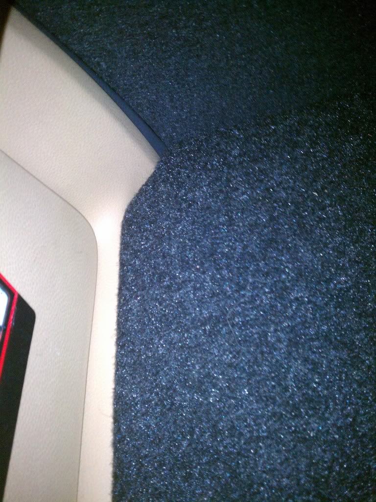

This is my first post on the forum. I just bought an 06 R53 MCS and this is also my first custom sub box ever. I liked the idea of Integral Audio's box plus top but just couldn't bring myself to pay that much for it, so I designed and built my own version. The amp is a HFi1000.1D and it's installed under the driver seat. I am 6" tall and wouldn't be able to scoot much forward anyways to allow a passenger behind me so I figured on the floor would be fine. The speakers are D10F Boss 10" Phantoms. They are a shallow mount sub with a depth of 3-3/8". The corrugated sheet metal is 16 gauge, liquid nails fastened and is inset in the 1/2" plywood the thickness of the sheet metal so when it's carpeted you wouldn't see the 12" by 12" squares. The edge of the board on top has weather stripping around the edge to make it soft and give it a snug fit in the back so it doesn't move around much when the subs are thumpin'. It's 16 gauge sheet metal so I don't have to worry about things puncturing the subs if tossed in the back. Anyways, enjoy the pics. Any questions about the build I will try to answer.

I decided to keep the head unit. If you keep it you have to splice a line convertor to your speaker wires heading out of the head unit. The lije convertor takes regular wire and converts it into rca. I took the rear left and rear right speakers and added it to them. Aftermarket head units have sub out already in the back in rca form.
