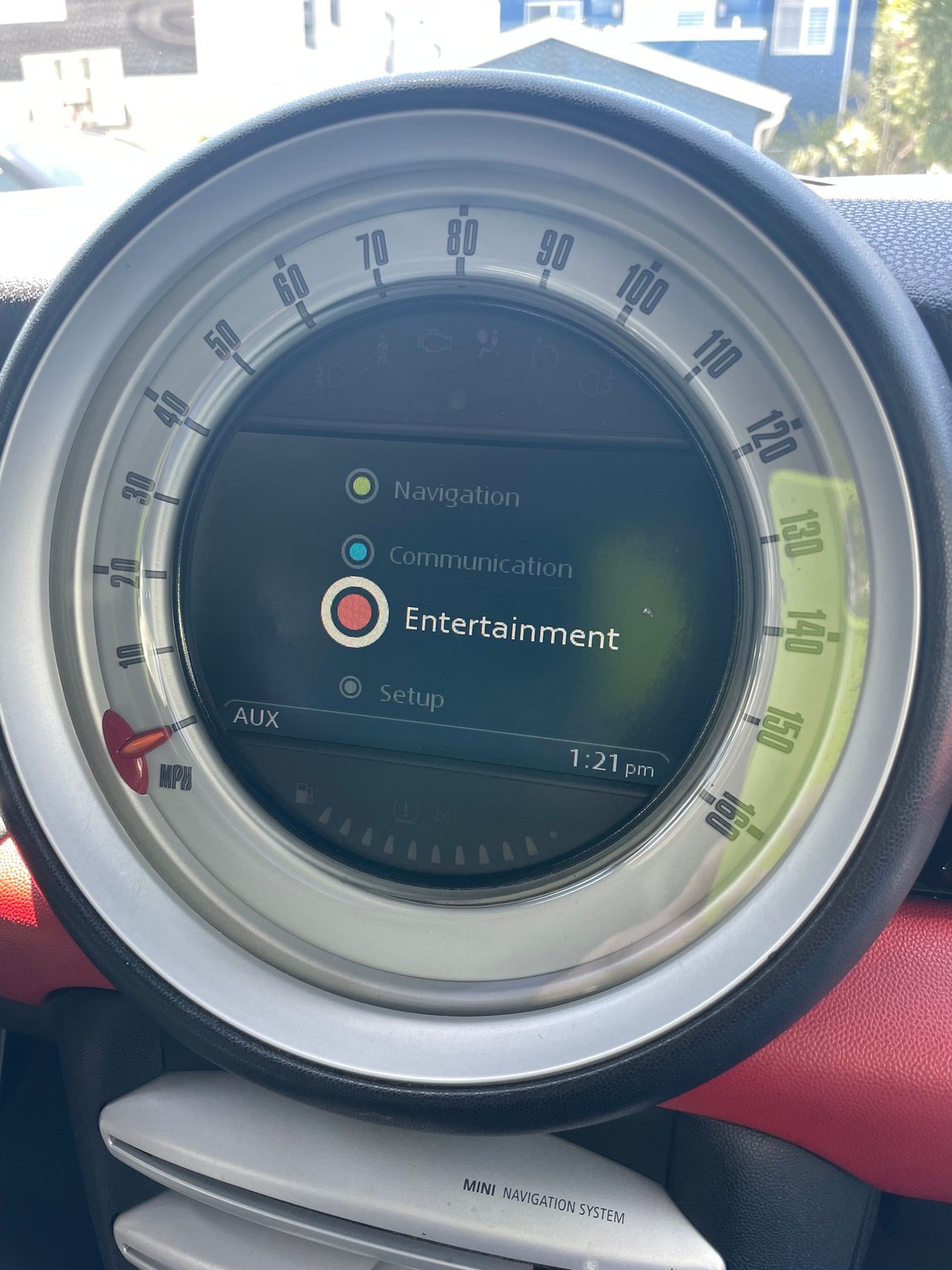

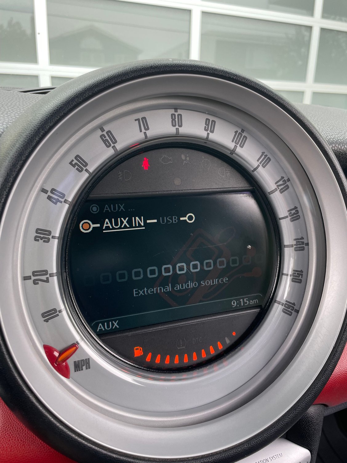

Well - I did it ! Used a Chinese unit with its own amp, and it works. Steering wheel controls work, voice control, decent sound (no sub).
Added a rear camera too. It’s given this 11 year old car a new lease of life.
I found a salvage center dash trim that had just the single ‘CD slot’ and took the whole of the old two slot audio/nav unit out.
After a quick reset with the scan tool, I have no warnings/codes.

Factory amp doesn't get used. You lose HK. All the speakers work, apart from the sub. But you gain so much more than you lose, in my opinion.
https://www.ebay.com/itm/274021925565
Seller is pretty responsive. Make sure that you tell him that you have HK, and send him photos of your current setup. He will send you the right cables etc with the unit. You will lose the mph speedo, but you can use the one in the steering wheel display instead. There's no way to switch the new unit from kph unfortunately. If you don't have factory nav, your install will be easier than mine.

I used one of these units on my 2010 CCC car and gave up. A few things to bear in mind if you have that vintage of car with the double slot CD and DVD players :
1. The resolution of the original factory display is terrible. You will never have seen CarPlay look as low-res and blurry as it does on that screen.

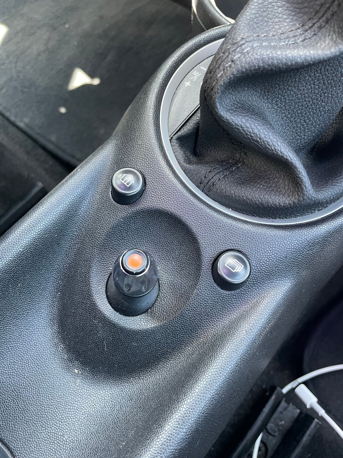

2. The original factory display is not a touch screen. It’s not a great experience when you are trying to move through the icons using the factory ***** located down by the gear shifter.
3. There is very little space left behind the original head units. Squeezing the CarPlay box back there is very difficult. Installing it in the upper glove box might be possible but the supplied cables have large plugs on them and they are quite short, so good luck with that.

I chose this one because the seller said it would work with CCC and HK. No others I found that would do this, although they may be out there. I did not replace the stock speakers, and they all worked plug and play with the cables that were provided out of the box. Except the sub, as previously mentioned.
Audio is ok, not stellar. But it's my daughter's car, and she couldn't be happier. It's plenty loud enough for here without any distortion. Definitely NOT for audiophiles.
I've mounted a small GPS antenna behind the dash, and it works fine, but it's not really needed if you use Apple CarPlay as you are using the GPS from your phone. I could not get the factory roof mount GPS antenna to work with this head unit, even tho it did work with the old factory nav unit.
You do lose all the original functions that are controlled by the joystick next to the transmission shifter, but the warning lights on the new head unit all seem to work. Fuel gauge, seat belt etc. Parking sensors work perfectly, as does the backup camera that I added while I was doing the work.
I use the speedo (MPH) in the steering wheel cluster, and that's fine. It does not default back to something else when the car is turned off, so it works well.
I have a scan tool, and there are no codes after clearing everything out post-install. I'm relaxed that I haven't lost any important CCC functionality that I couldn't get to via steering wheel and/or scan tool. Maybe I lost accent lighting control or something like that. I don't even remember what's in those menus anymore.
