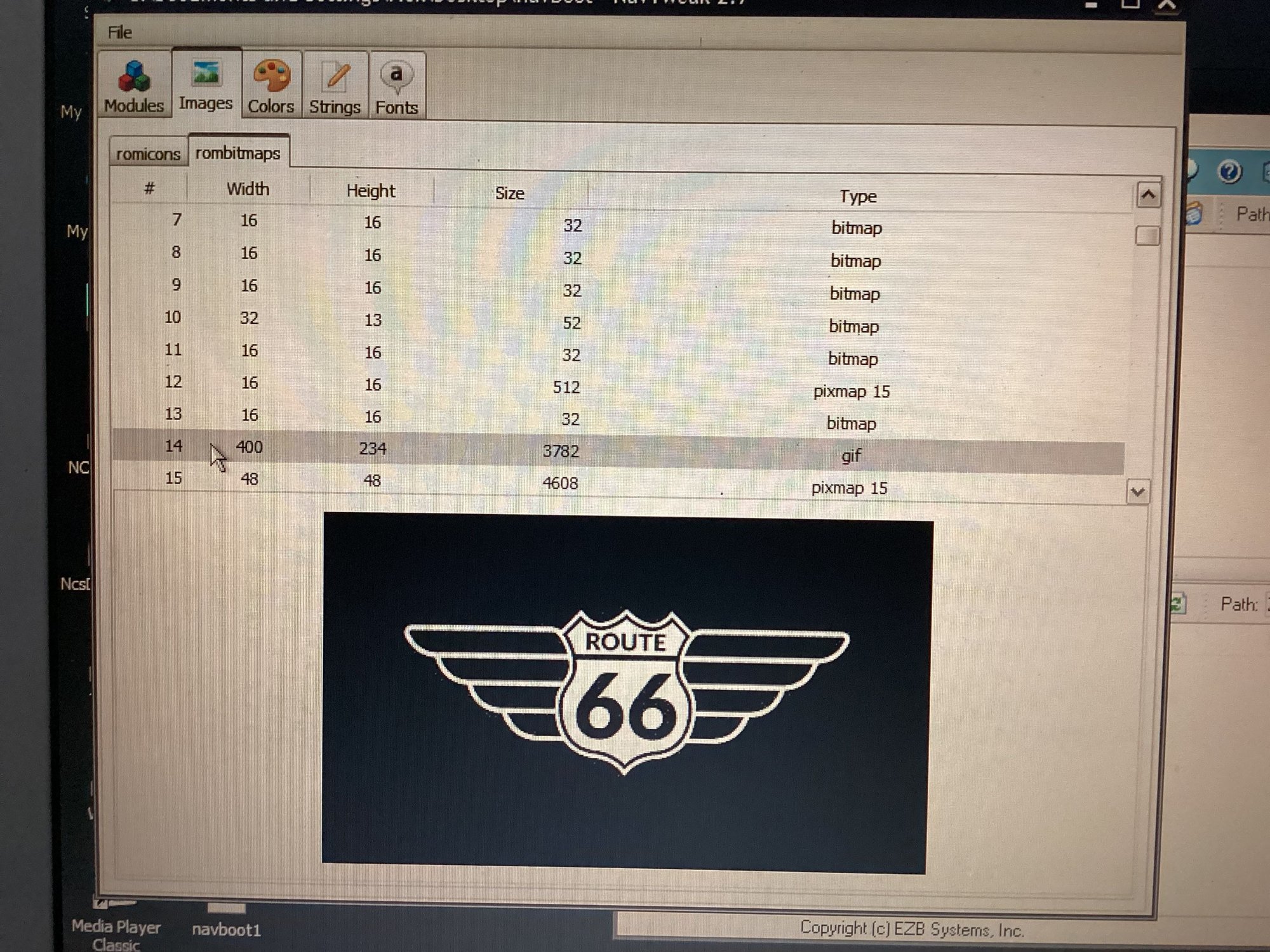

Btw, you don’t need to muck with modifying discs to get GB female voice. Nor nav coder. It can be changed in Inpa. But you do have to have th3 OS disc as after you send the change, it asks for the disc so it can load the voice from it.
Old Aug 14, 2023 | 11:07 AM
  #254
Onizukachan's Avatar
Onizukachan
Joined: Oct 2017
Posts: 571
Likes: 369
From: El Paso TX
Also, if you want to change splash screen, follow bmw directions, but instead of modifying 14 and replacing 400x234 bmw gif, go to 110 and replace the 400x234 mini gif
still need windows computer, som3 sort of iso program, and navtweak.
This was the bmw splash screen on 14. Didn’t realize that mini was located elsewhere (110)
Here is location of mini splash screen, option 110 instead of 14.
