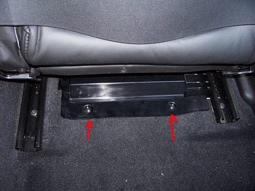

Hey hope u stil have mini info I have a 2005 sat nav is 4-1-00 seems like a old version here is the prob I don't have a CD ROM under any of my seats the GPS have maps a bit old is there any other place the sat nav CD ROM could be
It should be underneath the passenger seat towards the rear. I own a 2005 and that is where mine is located.
Attached Thumbnails How to: Update Nav software/enable British voice-image.jpg

  #219
RB-MINI's Avatar
RB-MINI
Joined: Oct 2009
Posts: 2,424
Likes: 516
There should be a plastic flap over the slot for the disc and eject button. No need for tools to access the disc on my 2005. If you have a convertible the NAV is supposed to be under the drivers seat instead of the passenger seat.
Old Jul 27, 2015 | 03:20 AM
  #220
jcwjohnson's Avatar
jcwjohnson
Joined: Jul 2015
Posts: 3
thanx got it
Old Jul 27, 2015 | 03:21 AM
  #221
jcwjohnson's Avatar
jcwjohnson
Joined: Jul 2015
Posts: 3
hey thanx for the pix i would never seen it if it was not for the pic and mine is under my driver seat have a right hand drive mini
Old Jul 27, 2015 | 04:28 AM
  #222
actulsiz's Avatar
actulsiz
Joined: Jun 2012
Posts: 331
No prob. Glad I could help!
