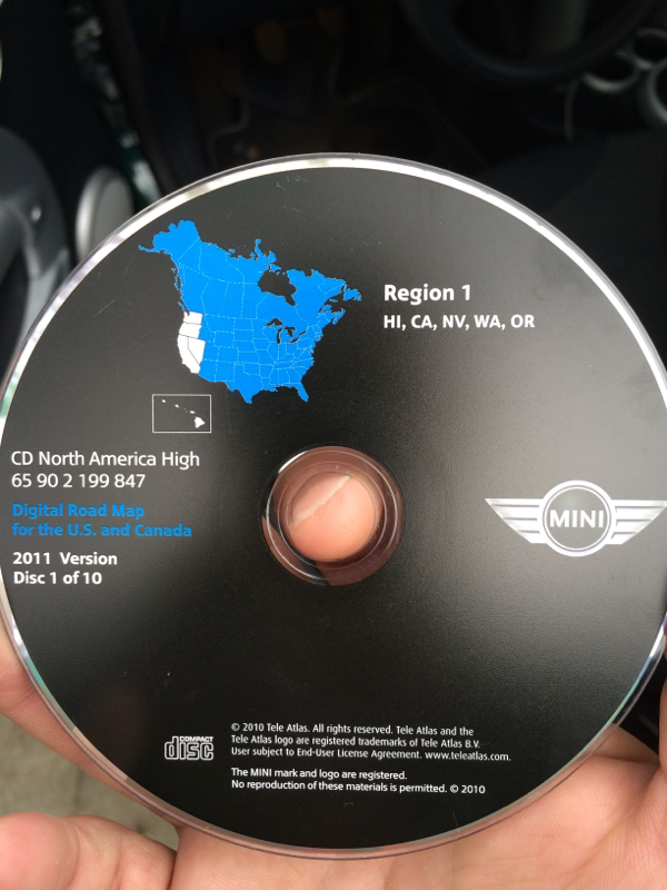

Can you post a pic of the disc?

Here you go. So now I have a blank screen. Pulled the fuses so will try again later.

Hmm. Our disks are slightly different. My disk actually shows the Part# and the manufacture date. Are you sure that your disk is a original and not another copy? My was ordered directly from a BMW dealership. Look at my attachment.

Oh, so I purchased a copy then, could that be why it ejects?
So I need to order from BMW, I did asking mini and they stock it anymore.

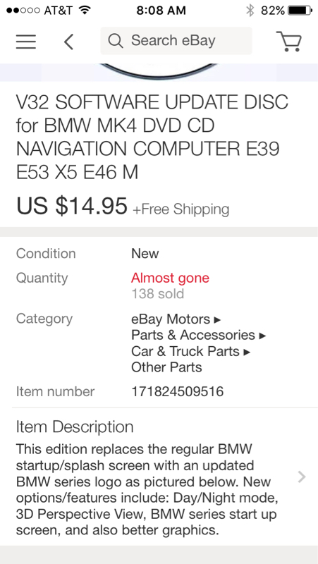

Ah, I see. So what would be my best option at this point. Here is a screen shot of the item number.

Do you have the MK4 nav? What year is your Mini? This update disk that we are talking about only works for Mini's that came equipped with the MK4 ie 2005/2006.

Mines a 2003, has the same unit as the item description picture, and the Service Manager at Mini it was to. Is there any where safe to download a copy?
