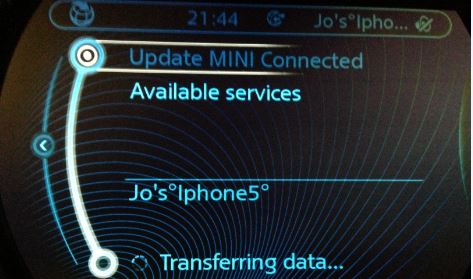

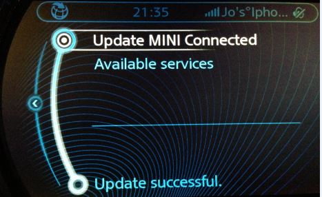

progressing a bit further I could now update mini-connected! I enabled the bluetooth datatransfer and now by clicking on Update i saw the system connecting somewhere and something was downloading ....
After around 10-15minutes i even got a "successfully updated" message but then still no sign of success and i still can't pair the app and the mini .
is this update process something you have with the connected somewhere, and what needs to be done next?
Attached Thumbnails Official MINI Connected Thread-switchon-data-service.jpg   Official MINI Connected Thread-transfering-data.jpg   Official MINI Connected Thread-updatesucessfull.jpg

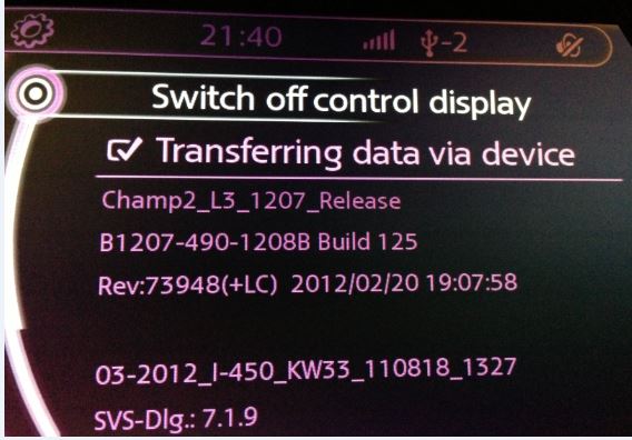

Ooh, haven't seen that before. Can you share what you did to enable that option?
Old Mar 7, 2013 | 12:48 PM
  #409
JimmyBlunt's Avatar
JimmyBlunt
Joined: Feb 2013
Posts: 18
From: Sydney
Hi cactusbob
actually you get to this menue by enabling in the CHAMP2 Module the ENTWICKLER_MENUE
I then enabled bluetooth data transfer as this was for sure disabled in my car as well
... as soon as this was active i have the data option in every menu ... can chose to tick.
the god thing is since then i got SMS displayed and read on to the mini boost radio .. just new ones though , i mean that you get while you currently drive...
so far no progress on how to get this bloody connected working??????
Code:
ENTWICKLER_MENUE
	aktiv
BT_DATA_SERVICE
	aktiv
Old Mar 17, 2013 | 01:56 AM
