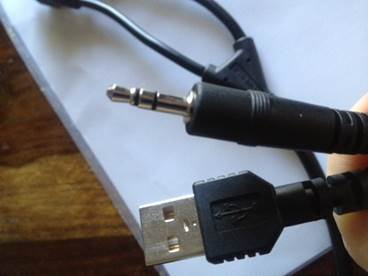

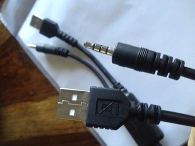

I took delivery of my Mini yesterday and I simply cannot connect to Mini Connect. I receive the "No plugin compatible device connected" message for the Mini Connect. I have the Y adapter I received with my Mini to MiniConnect.
After scouring internet it looks like my issue is with the Apple Lightning 30-Pin to 8-Pin Adapter for iPhone 5. As best I can tell, it does NOT support video thru the adapter. So is anyone actually using an iphone 5 for Mini Connect App with an Iphone 5? (MyBluetooth and Audio works fine, but
From Apple Supportsite: "When you connect an iPod or iPhone with the Lightning to 30-pinAdapter, the iPod or iPhone will be treated like an iPod that does not supportiPod Out. You should still be able to navigate through and play your musicusing the vehicle's built-in user interface.
iPod Out is a vehicle-integration system built in to somecars that allows the user to experience Apple's own user interface by pushingvideo to the car's display screen. It is not supported over a Lightning 30-pinAdapter or Lightning to 30-pin Adapter (0.2m).

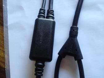

Thanks! I am grasping for answers. According to the Mini Connected App it states that Y cable required is 61 12 2 179623 (or a plug in adapter) not what they provided me 61 12 2 338491. After scouring forums it looks like the one I have is for sound ONLY. I posted photos of where the Y looking one is the connector I need not the rectangular one. I asked my MA for the correct one. For those with working Mini Connected, which cord do you have. Part number is on the Y branch. Much appreciated!

Mini Connect is working for me and I have the "Y" shaped connector 2 179 623-01 i=on the "Y" molded part. I'm using an iPhone 5 with iOS 7 and the apps like Audible still work and non-connected Aps like Downcast also work and even send album art to the display.

Is your MINI new? The correct cable should have been in your MINI when it was delivered if it was new...
The correct Y cable is 30 pin out of the iPod and then splits to USB and audio to connect to the MINI's Aux in and USB ports...

The dealer agreed that I have the wrong connector. Funny that it came with the 2014 I picked up yesterday. Since the dealer is a two hour drive--they are mailing to me. I will keep everyone posted. Thanks!

Voila! I received the correct Y Cable from the dealer and the Mini Connect works with my iphone 5 with ios 7. Funny that I had to inform the MA on a brand new Mini that the cable they provided was wrong. Of course I also figured out I needed to install a new software upgrade. Easy to do. See attachment.
