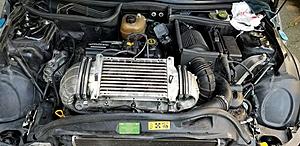

Is this a JCW Mini or not? (Yes, it is)
I found a 2006 JCW Mini convertible for sale local to me.....owner says it's a JCW car.....says engine was replaced with a 70,000 mile one.....I asked him if the engine was replaced with a JCW unit, he does not know.....I asked him to send me a pic of the engine, which he did.....I'm still unsure....
Picture of engine below......I also got to see the VIN number on the left strut tower....I ran the number and it didn't say anything about being a JCW car....the VIN is below, can anyone tell me if this is a true JCW car or should I run away very fast? Owner says no spark to plugs
VIN -> WMWRH33596TJ42618
Thanks for any help here
Attached Thumbnails Is this a JCW Mini or not?-36432375_2031125446931719_1962956099023798272_n.jpg

That VIN does decode to a factory JCW as it has the S3ALA code. The engine in the picture does appear to have the JCW valve cover sticker but the JCW airfilter box was removed and some type of aftermarket unit is installed.

Running the vin shows the JCW package and lsd differential. As a factory JCW, it should also have the red JCW front brake upgrade.
With the motor swap, it’s not so clear if it has a JCW motor without seeing the exhaust ports on the head. The pulley can be measured, or might not matter if replaced, and the injectors can be seen below the intercooler. If they’re blue they should be the JCW 380’s. The valve cover is there, but could be from the old motor, and the exhaust isn’t visible from the pic. The JCW airbox is missing, but doesn’t necessarily mean anything unless you really want the factory JCW airbox.
The biggest thing is if it has the JCW head as that was the only difference on the longblock.

Yea, I saw the aftermarket intake box & filter assembly.....I also was wondering about the intercooler on top of the engine.....the JCW valve cover could have been added at one point.....

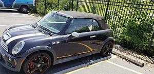

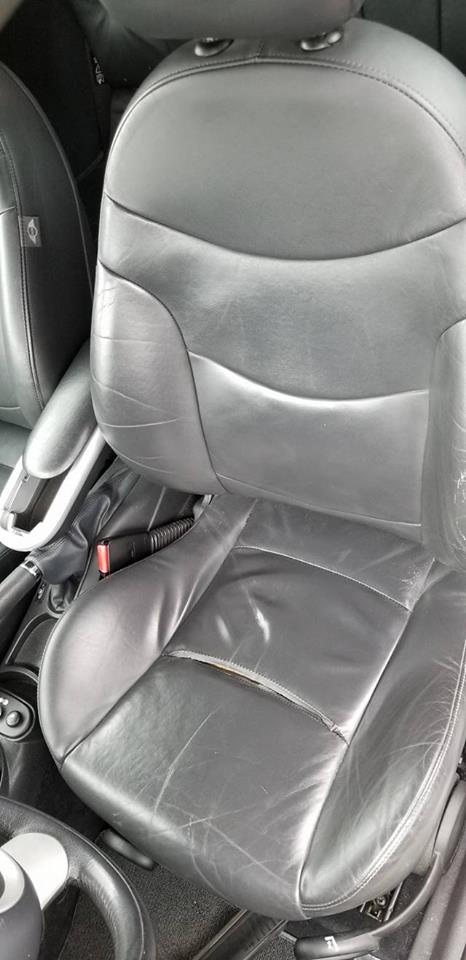

Here are other pics
Attached Thumbnails Is this a JCW Mini or not?-35634060_2009250389119225_148798244321755136_n.jpg   Is this a JCW Mini or not?-35726183_2009250689119195_2074111089594859520_n.jpg   Is this a JCW Mini or not?-35758421_2009250532452544_6693521589524234240_n.jpg   Is this a JCW Mini or not?-35768477_2009250462452551_152391834868383744_n.jpg   Is this a JCW Mini or not?-35810589_2009250779119186_6133819640696012800_n.jpg
Is this a JCW Mini or not?-35849132_2009250595785871_8859500178449629184_n.jpg

The intercooler is the same on the JCW as the S, but the plastic diverter was silver with a JCW emblem on the right. Only the GP had a larger intercooler. The only way to really tell if it has the JCW head without removing it is to remove the header to see the exhaust ports. From the factory the head were supposed to have a small red(?) dot painted on the head, but that could be added, cover with oil/dirt, or just worn off over time.
In the front drivers side view you can see the JCW brakes with what looks like the correct carriers, which are different than the R56 “Poor man’s JCW” upgrade.

Poor R52, hope you can bring it back to life. Looks like the JCW calipers and with the options back in the day that was a pretty expensive R52. I always thought it was a green dot on the head?

There's mold on the inside of the convertible top, drivers seat is torn. The silver intercooler cover is in the back seat.
