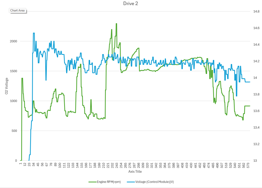

So currently having some problems with my cable for ISTA, should be getting a new one today. I did get some logs from TorquePro that shows the Fule pressure PSI, engine rpm, and O2 downstream voltage. I compiled into an excel file with 2 charts with graphs. If you could just glance and it and tell me what you think, it seems really weird to me that my O2 voltage and Fuel Pressure both drop a lot. The voltage for O2 seems to be like all over the place.
File Type: xlsx

Your data are more consistent with an electrical issue than an HPFP issue.
Focus first on a possible wire harness issue.
Inspect the wire harness that runs behind the engine and behind the vacuum pump. The issue could be oil contamination or wire damage. For the former, the oil pressure solenoid seal can fail, allowing oil to wick into the wires and travel all the way to the DME. So also inspect the two large 53-pin DME connectors for signs of oil.

Can TorquePro monitor "Control Module Voltage"? If so, repeat your test by substituting the downstream O2 sensor signal voltage with Control Module Voltage.
Of course, if you get a working ISTA cable, the ISTA tests would be an even higher priority.

In the data tab with all the values I do have voltage for control module v but idk what exact module its coming from if it is the dme or like the footwell module
In essence, the control module voltage is equivalent to the voltage supplied to the DME by the Main Relay (terminal 87). Terminal 87 is more relevant to your issue than the downstream O2 sensor signal voltage because the Main Relay supplies voltage to the O2 sensor heaters (circuit source for code 2c01).

Looking at the data it looks like the voltage for whatever control module it is looking at does decrease with rpm, but when the fuel pressure drops the voltage drops by like .2 ish
