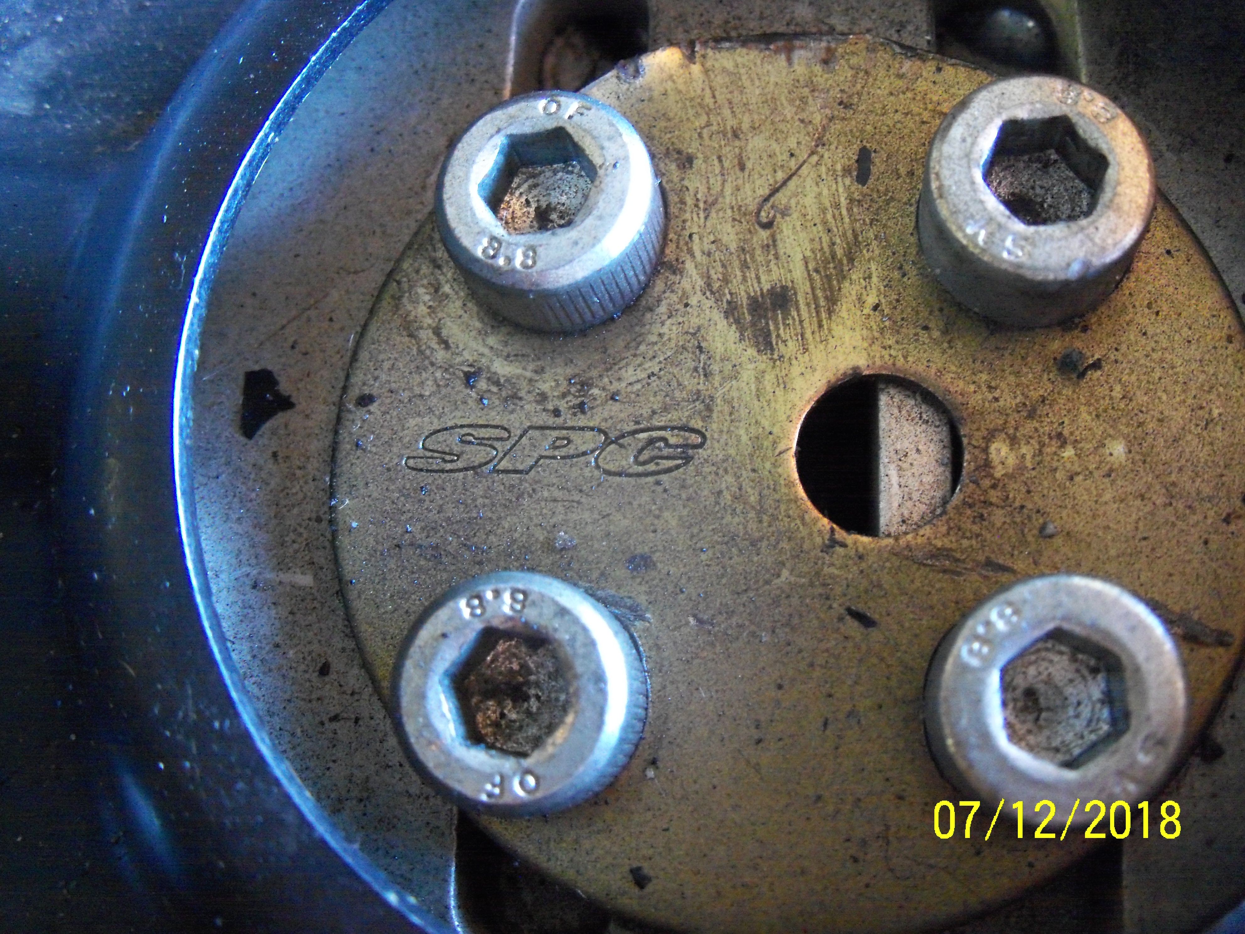

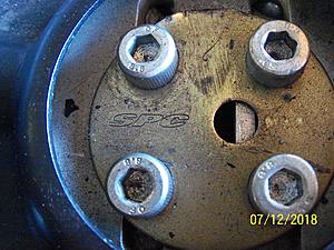

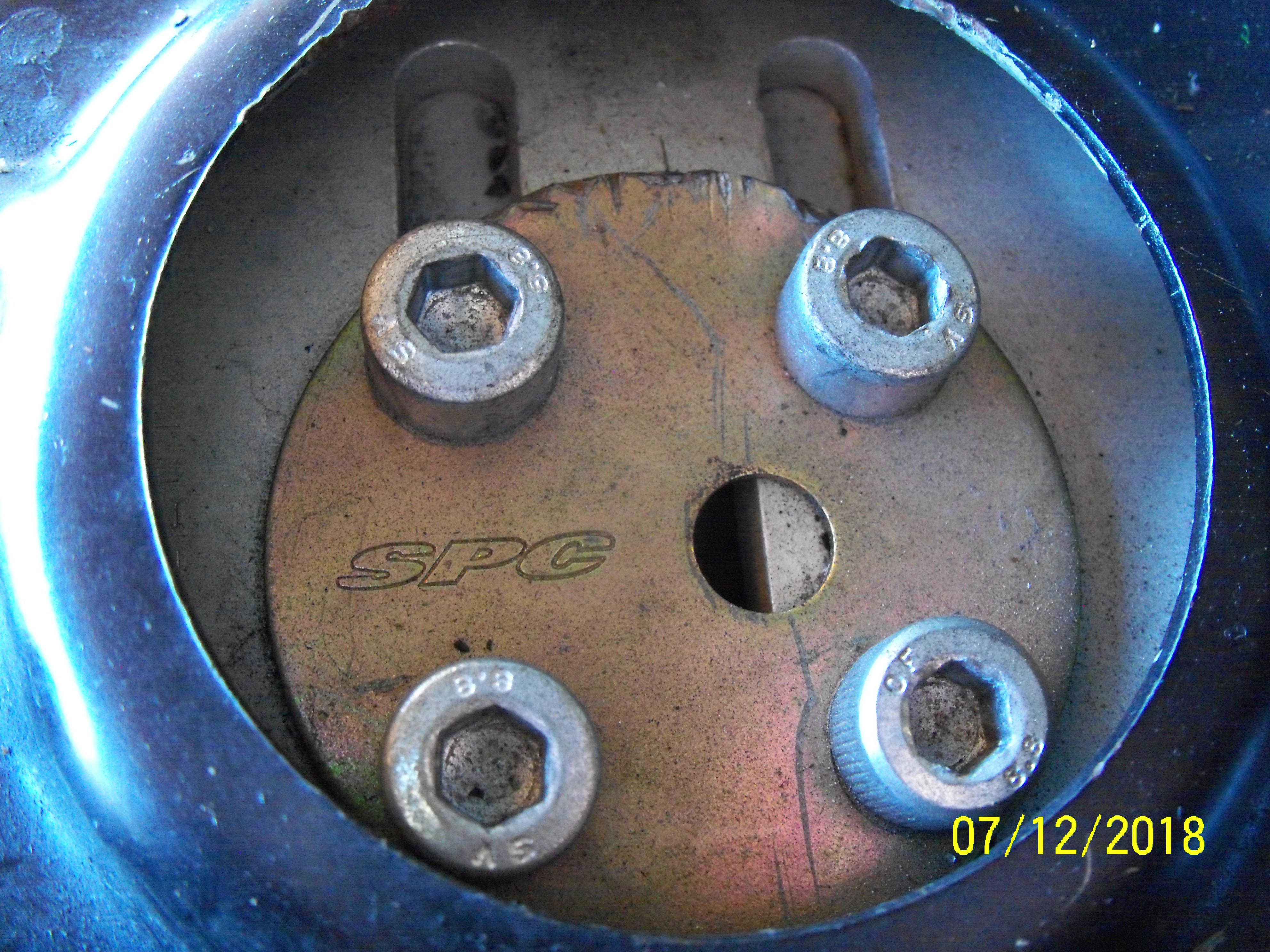

take a pic of the shock towers and struts, we'll tell you what they are.

If those camber plates are red, they are probably Madness Motorworks strut tower plates. Look something like this?
Subw00er, those are my calipers for sale haha. A383, start spraying the ebrake cables NOW with WD-40. When I did my brake upgrade I hosed down the left side early and the thing slid right out. I had problems with the right side, was just about to cut the parking cable, when I used a 5lb sledge and a metal wedge on the round part of the cable protruding from the caliper and was able to break it loose.

I did take pictures, but never got them uploaded to my computer. The top of the struts say SBC on them. Looks to have 4 Allen head bolts for camber adjustment. Will try to get pictures loaded tomorrow.

Not familiar with SBC but yes to SPC that makes the Eibach plate as well.

if they have red poly monitor for cracks, I've had 2 sets fail, one set failed so bad when I put the car on a lift the front shocks fell out

Yea, yer right, they are "SPC"......I was trying to remember without looking at the picture.....my bad......
This car and the heat up here is getting to me.....
Here are pics of the upper mounts

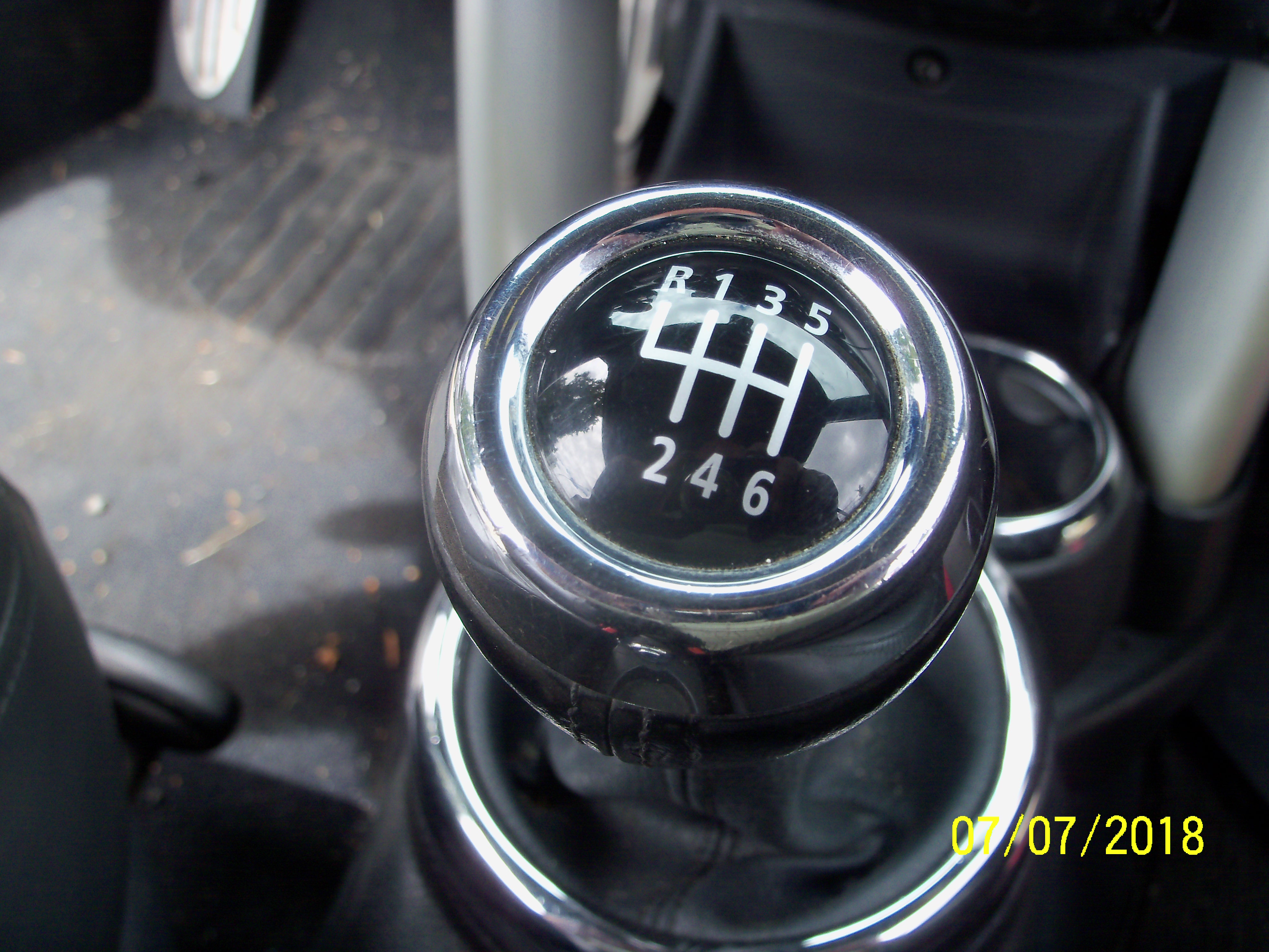

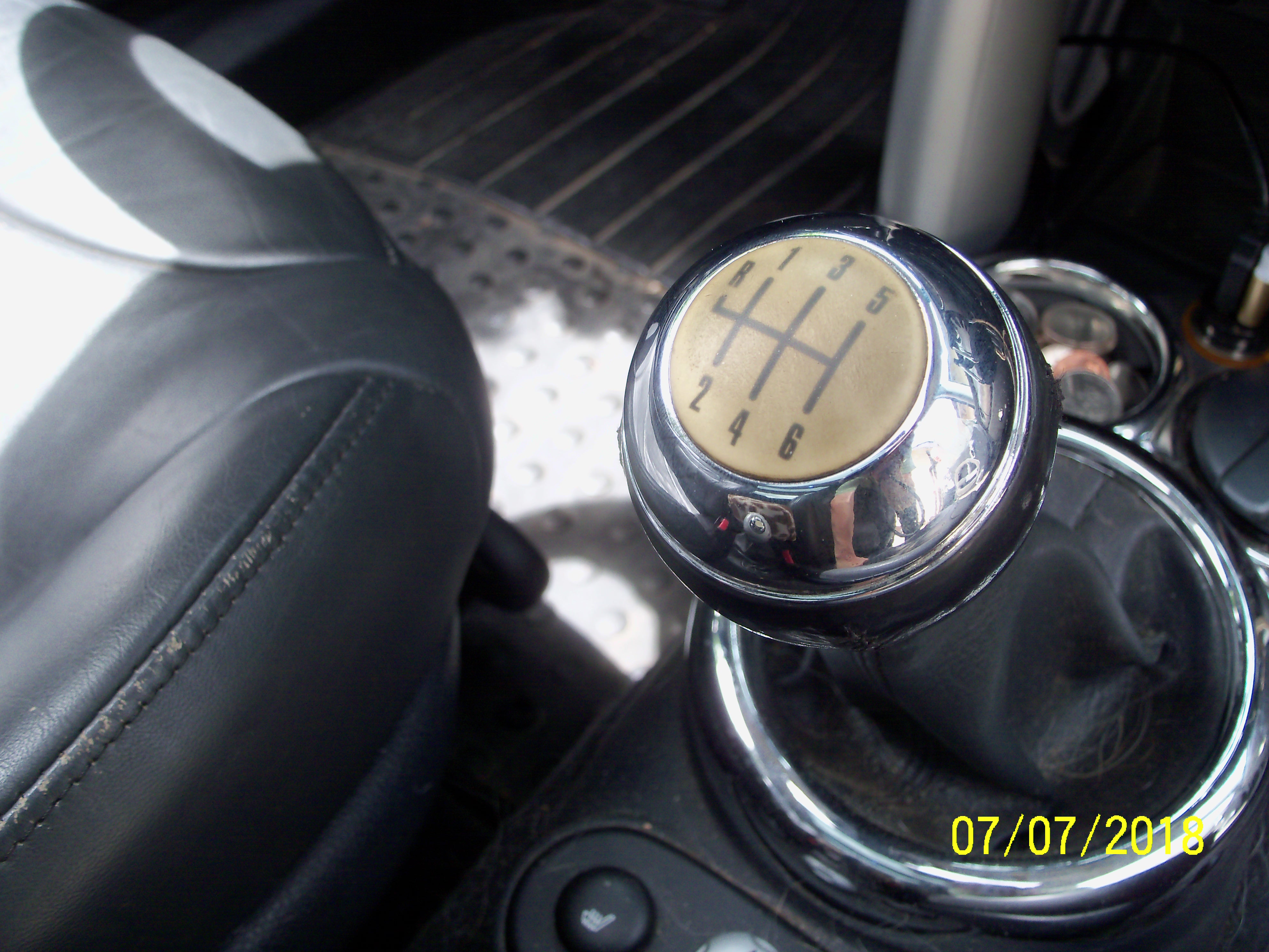

Curious....what year gearshift **** is this? (first pic)
It's different than my '04 R53 ****......I like this one better than what I have on my R53 (second pic)
Wondering how hard it is to swap these out

They took a Gen 2 stock R56-R59 **** and stuck it on there R53/.
Does the Gen 2 **** just pull up off the lever liked the Gen 1 ***** do? Or do I have to swap out the entire shifter assembly?
