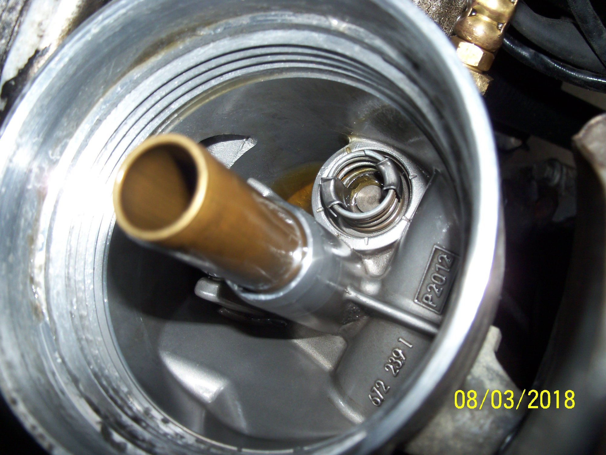

Well crap.....pulled the oil filter top off and found metal shavings inside the filter housing......not good

There is a couple items in the bottom of the filter housing......one is swedged into the bottom of the housing, and the other is next to it............pics of inside the oil filter housing below....I can push both items and they spring right back

It all looks good to me, as the filter keeps them closed. The (the housing too maybe be new and this is older damage.. Check as stated above and let is know what you find!
