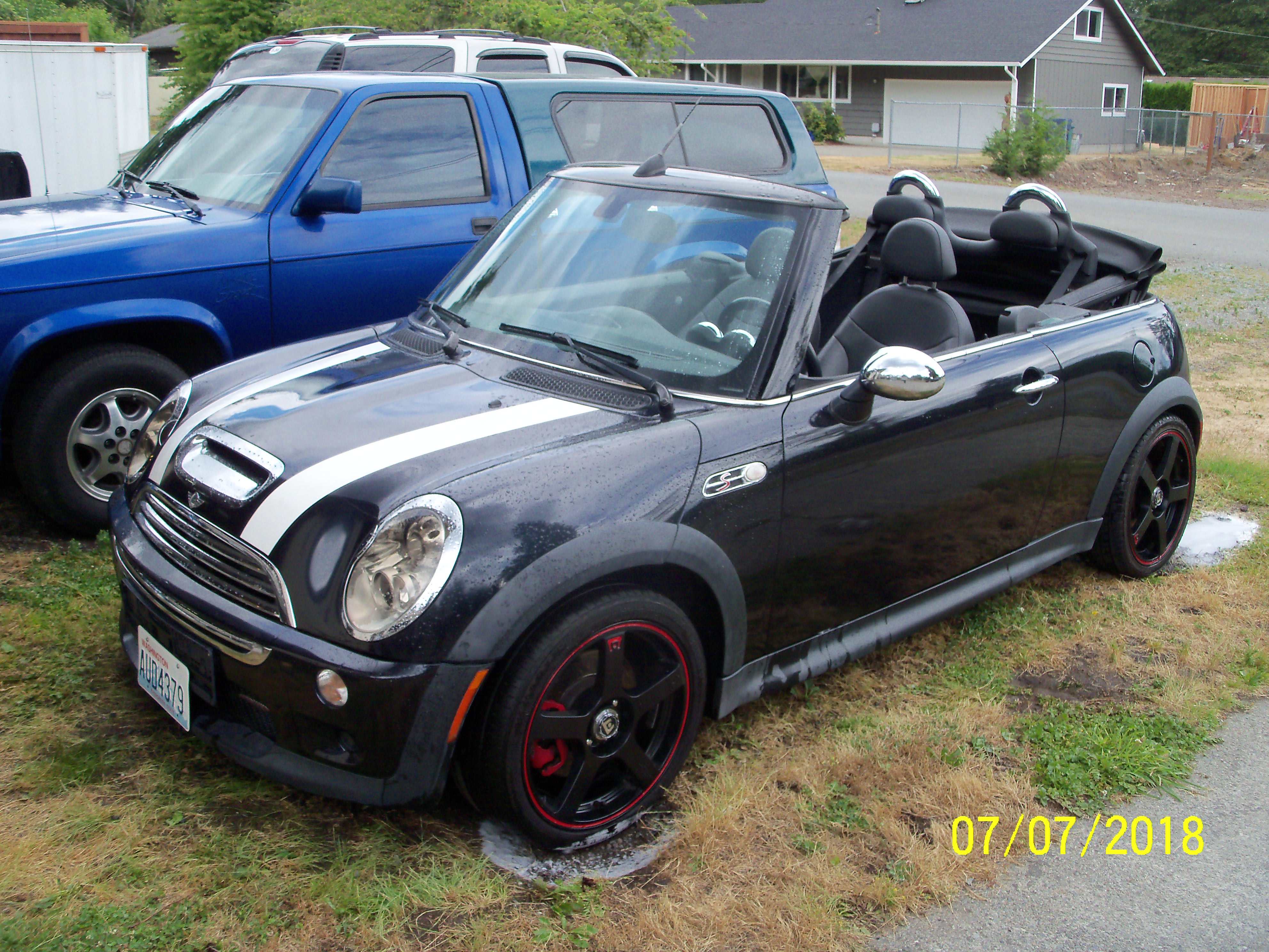

Is this a JCW Mini or not?

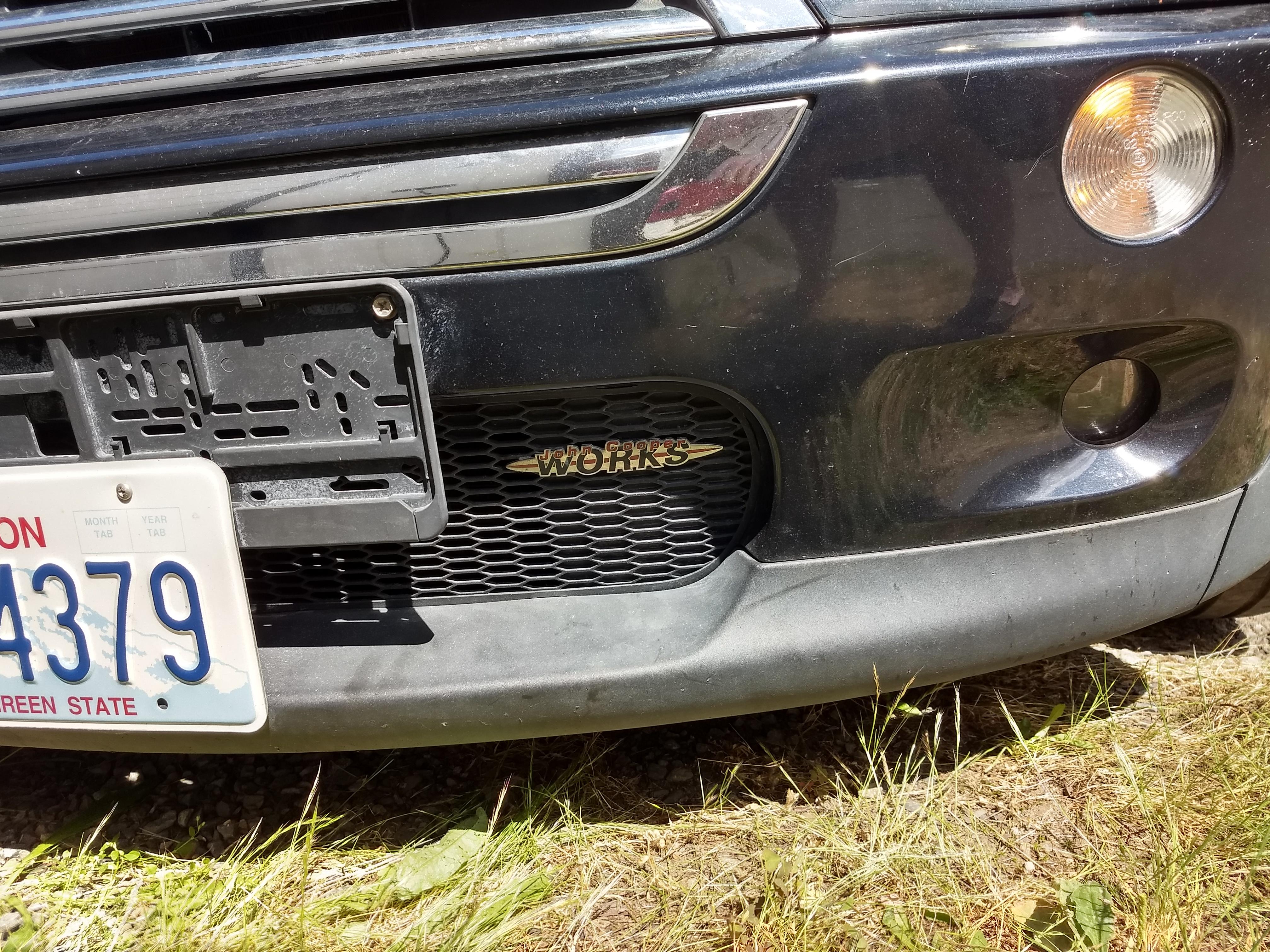

No red brakes on the 1st gen rears. The rear parts of the JCW kit were only different pads for the stock calipers and rotors.

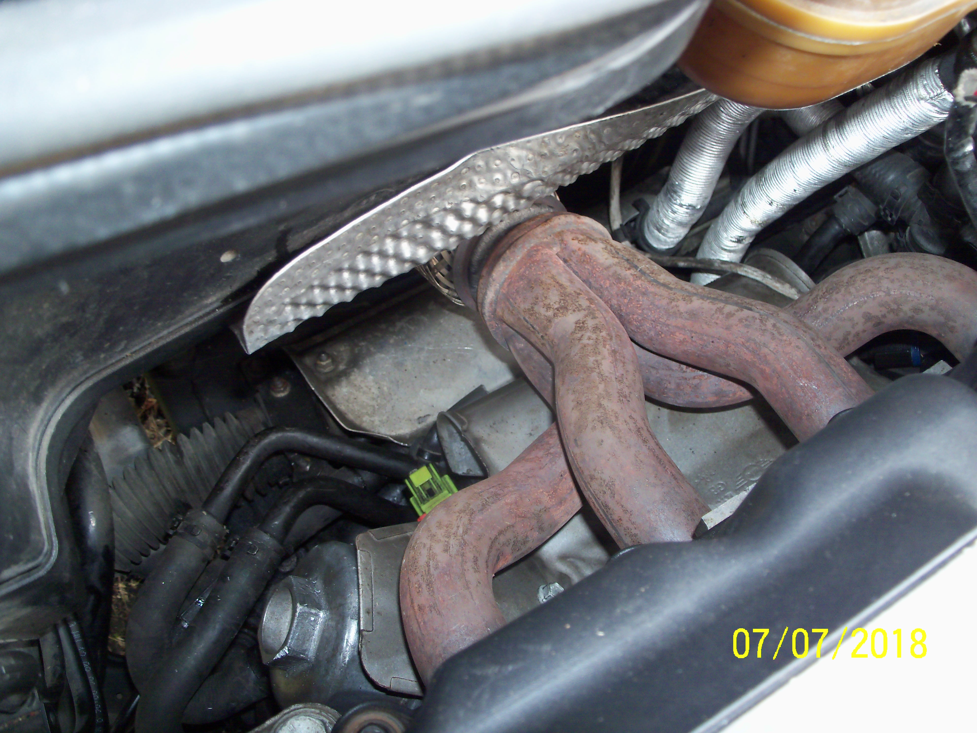

The 421 header is most likely an OBX, a SuperSprint knockoff. Really inexpensive and sometimes had fitment problems, but a really popular mod and once fitted had good performance.

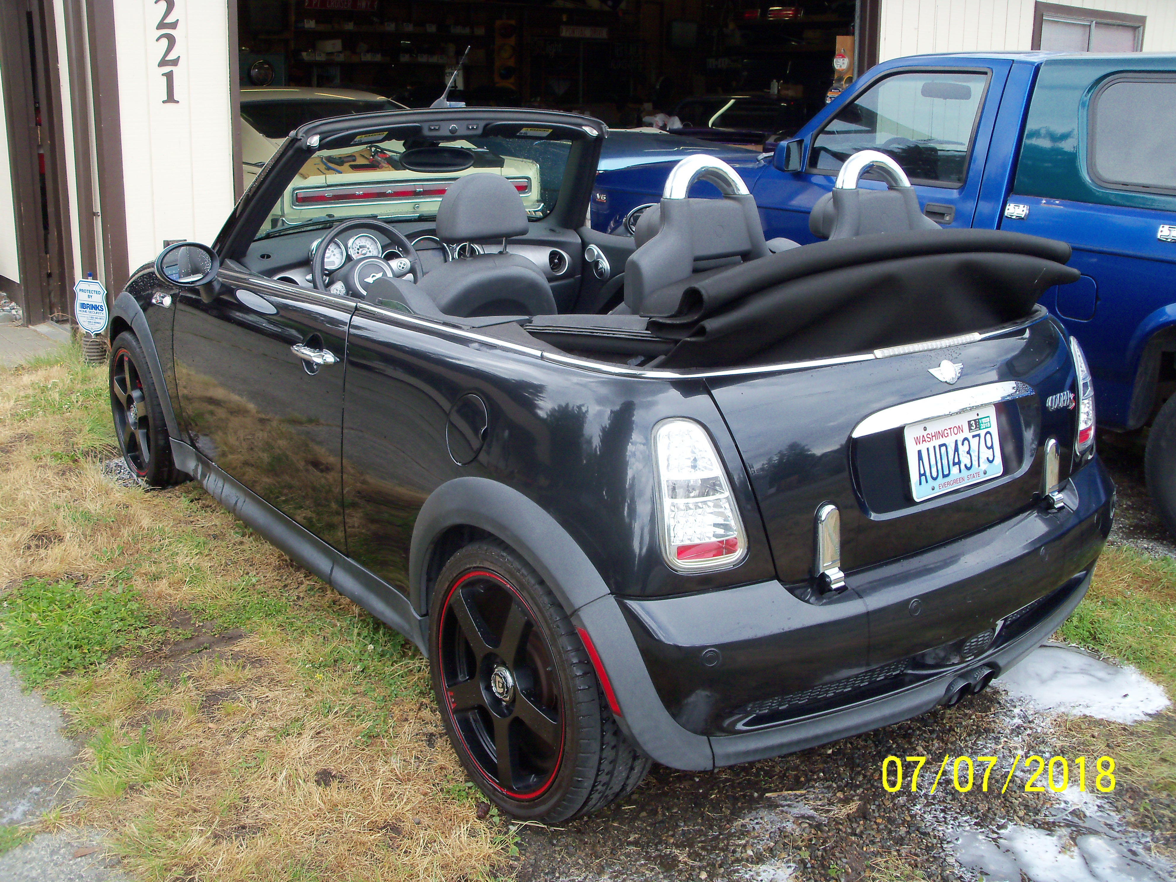

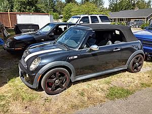

Well, the car is home here....my little '94 Dakota hauled it really well.....was about an hour trip home with the Mini on the tow-dolly. We had some trouble getting the car off of the dolly....man that R52 weighs a lot.....either that or the brakes are kinda frozen to the rotors....will dig into that as well

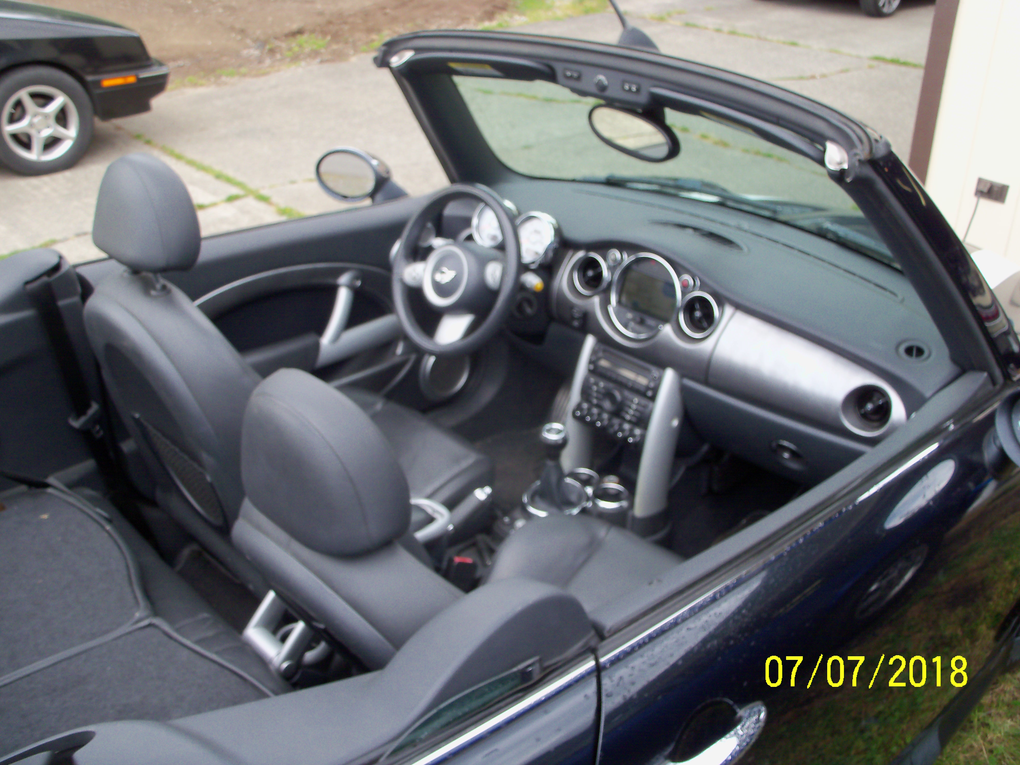

Not much works on this car....radio turns on, no sound from any of the speakers.......I can't get the convertible top to work at all....not sure if the engine has to be running or not....which it doesn't run at all....one reason why I got it so cheap.
All 4 of the power windows do work, as does the power mirrors.....not real crazy about the cheap LED rear tail lights and turn signals....very hard to see in the daylight....Has Motegi wheels....just wish they weren't scuffed up on the outer rim....also has 2 different tire sizes from front to rear....
I'm also not crazy about the chrome mirror caps and the chrome supercharger inlet slot on the hood....I don't like the white hood stripes either.....
Guess I got my work cut out for me on this one.....first order of business is to get the engine running if possible....then try to fix the stuff that doesn't work......a few pics below......

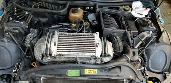

What does the engine look like?
I don't like the tail lights either.
I think the car stands out better with stripes.
The wheels can be sanded and repainted.
The top will not open, if the rear lid is open, or the shelf is absent. Both can be worked around.
You can remove the chome overkill and use colored ones in their place.

I think I would rather have the factory JCW air box.
Did you not get the intercooler cover?

The engine cranks over fine, it just won't start....I have the ECSTuning scanner here I was going to plug in and see if I have cam & crank signal to start with....
I would rather have the factory air box & filter as well, but that's way down on the list of priorities right now.
I did get the silver JCW inter-cooler plastic cover, it's in the back seat

Is this a JCW Mini or not? (Yes, it is)

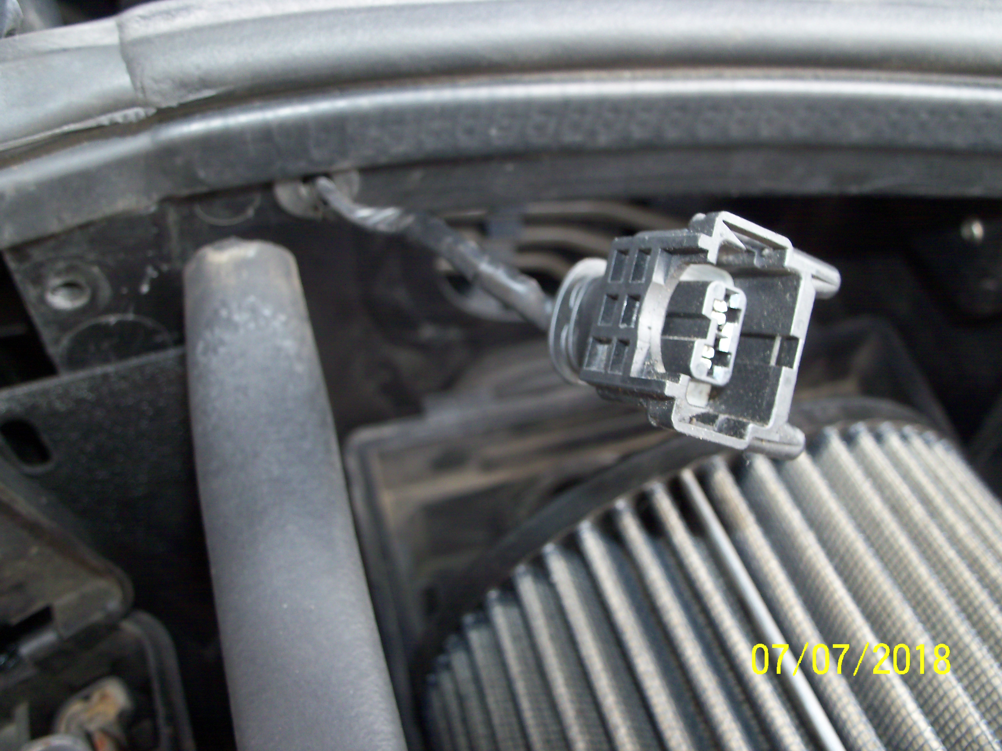

Where does the two wire connector plug into shown at the aftermerket air filter box? My '04 R53 does not have this connector, This is an '06 R52 JCW car.

Here are a few more pics of this car I just got....the first pic is of the wire connector that I can't find a home for, and what is the yellow end on the wiper stalk do? (second picture)

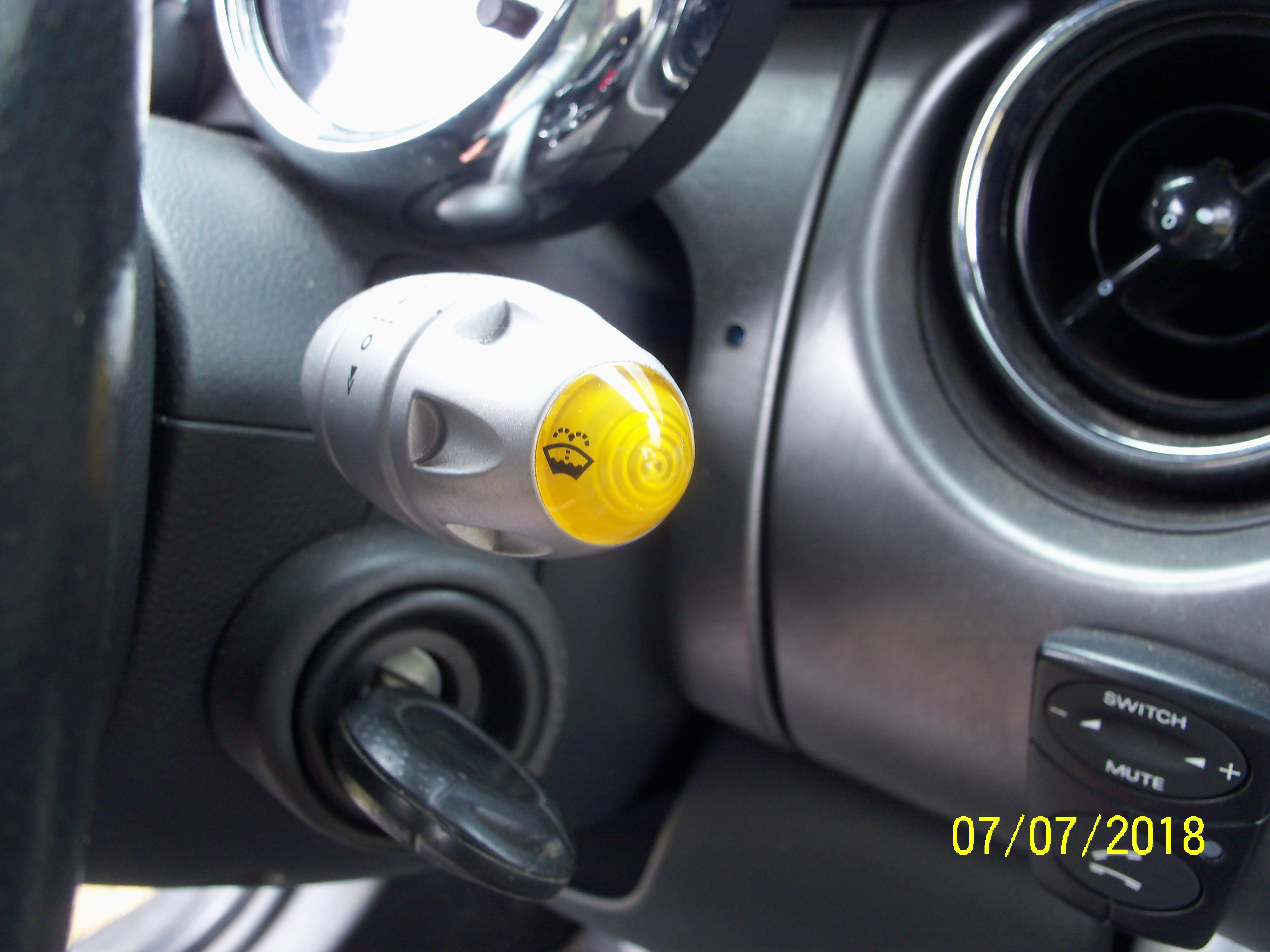

The yellow end of the wiper stalk lights up when you are low on washer fluid. I will check that wiring connect later. My wife is currently out shopping in the car. For the immobilizer have you seen this tip?

The small connector by the airbox is probably for the factory JCW airbox which has been replaced. It had a flap that opened at 4,500 rpm with electrical and vacuum connections.
The header looks like the stock header. Also looks like you have the Harmon Kardon system and the amps are problematic which could be the reason for no sound. The broken dipstick is a common MINI thing. There’s an aftermarket dipstick for about $75, but some people say the reading is off. I would just get another stock one or equivalent.

Thanks for the info on the connector at the air box......as long as the connector is not causing the "no start", I'm fine with it just laying there

It may be in mobilizer mode, but I was thinking it would not even turn over.
The cam position sensor would be the thing to look at on the spark and injector action. Without it working properly (or in this case at all, it will not start)It may possibly have corroded connector plug.
