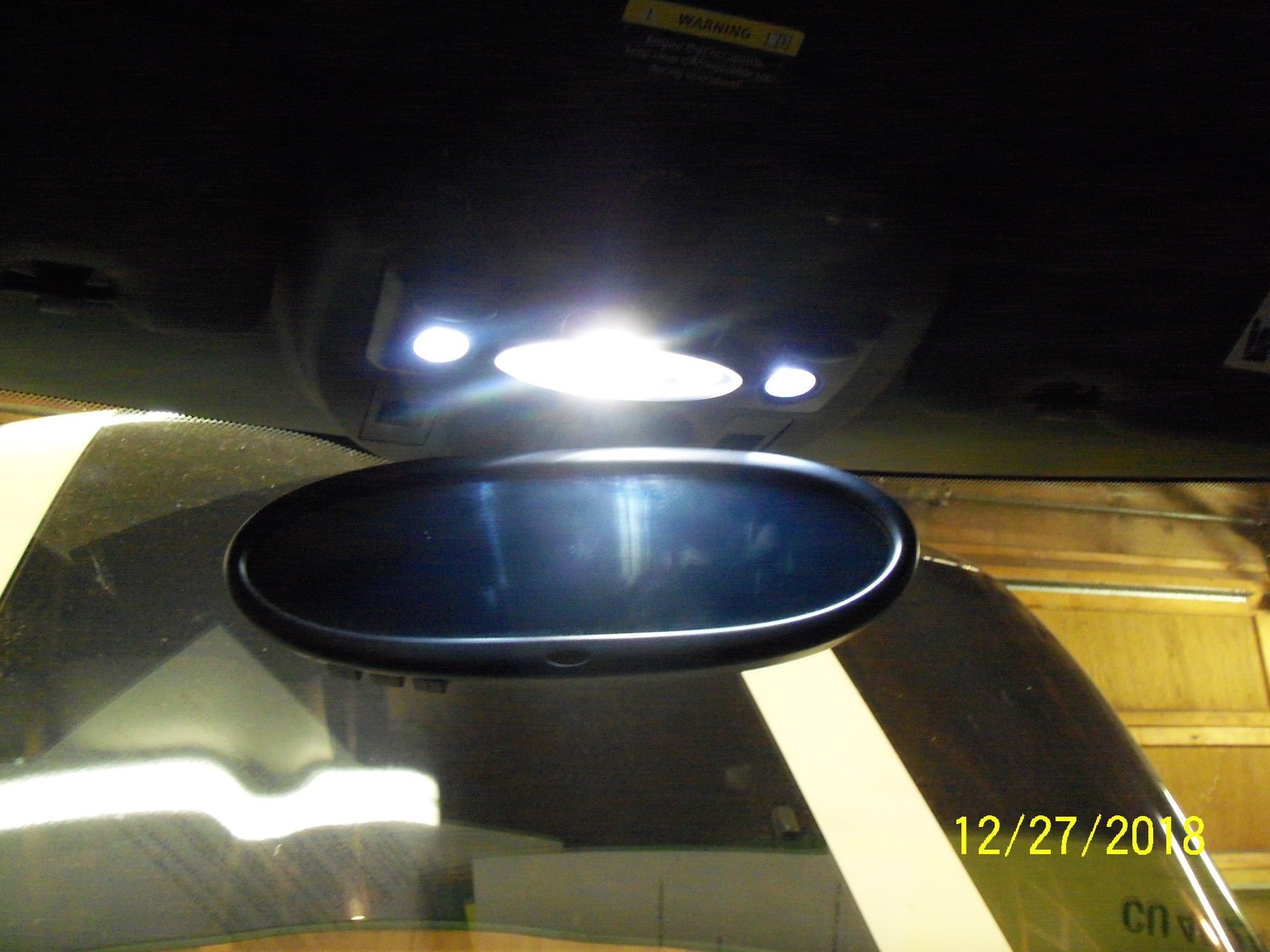

Update: 12-27-2018
Wife is home after spending 5 days in the hospital, surgery went well. Now it's just recovery time and taking it easy for a while.....no date as to when she will be able to return to work, it all depends on how she's feeling. I took her to the grocery store this morning, she needed a few things, we got home and she's back in bed, she's running out of steam.
So, I tinkered with the LED interior lights today. I got my LED footwell lights the other day, figured I would like to see how they work......MAN, what a difference......the first pic shows the different style lights I have here, regular #194 bulb, flat LED light, and the new 18 LED light with housing at the top. The trunk light is the same as the footwell lights, at least on my 2006 car, so I put the new LED housing in there also.....these photos have not been edited or adjusted.....these new LED housings are really bright
The puddle light housings are the same as the footwell lights, I'm still waiting for those to arrive, will post pics of those when installed as well
(I just ordered another set of footwell lights for my '04 R53......I knew I was gonna like these)
