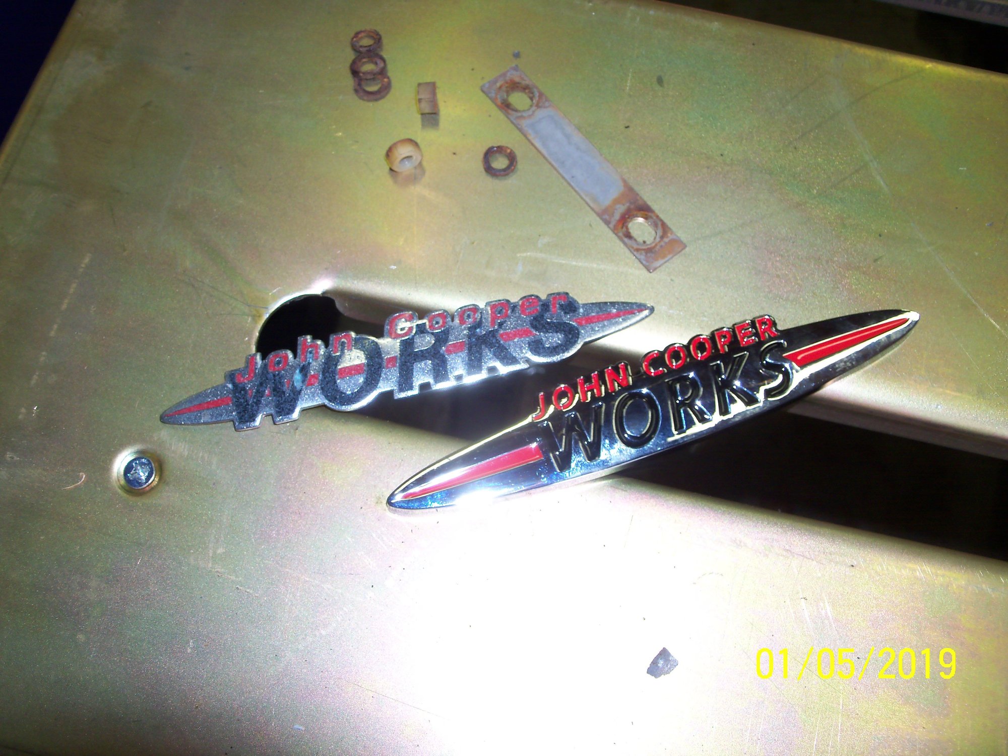

Update: 1-5-2019
Got the front calipers & pads on, bled the system, pumped up the pedal, and now the front calipers release off the rotors as they should......
Got the inner fender-well plastic panels back on, installed the new JCW badge in the front grille, (I know the badge is the newer style, but it was all I could find. The OE one on the car looks like it went through a sandblaster) installed the front bumper cover and found out I'm missing the lower part of the bumper cover that attaches the cover to the radiator support. It looks like it has the little spoiler air dam on it......I don't remember taking this piece off, I bet the kid that had this car before me either lost it, broke it, or just fergot it or threw it away......so now I'm on the hunt for that piece....I'll place a "wanted" ad in the classifieds for it
I decided I will take the new rear calipers back off and paint them red to match the fronts.......I think it will look better and balance the looks of the car when viewing it from the side
Bryan
