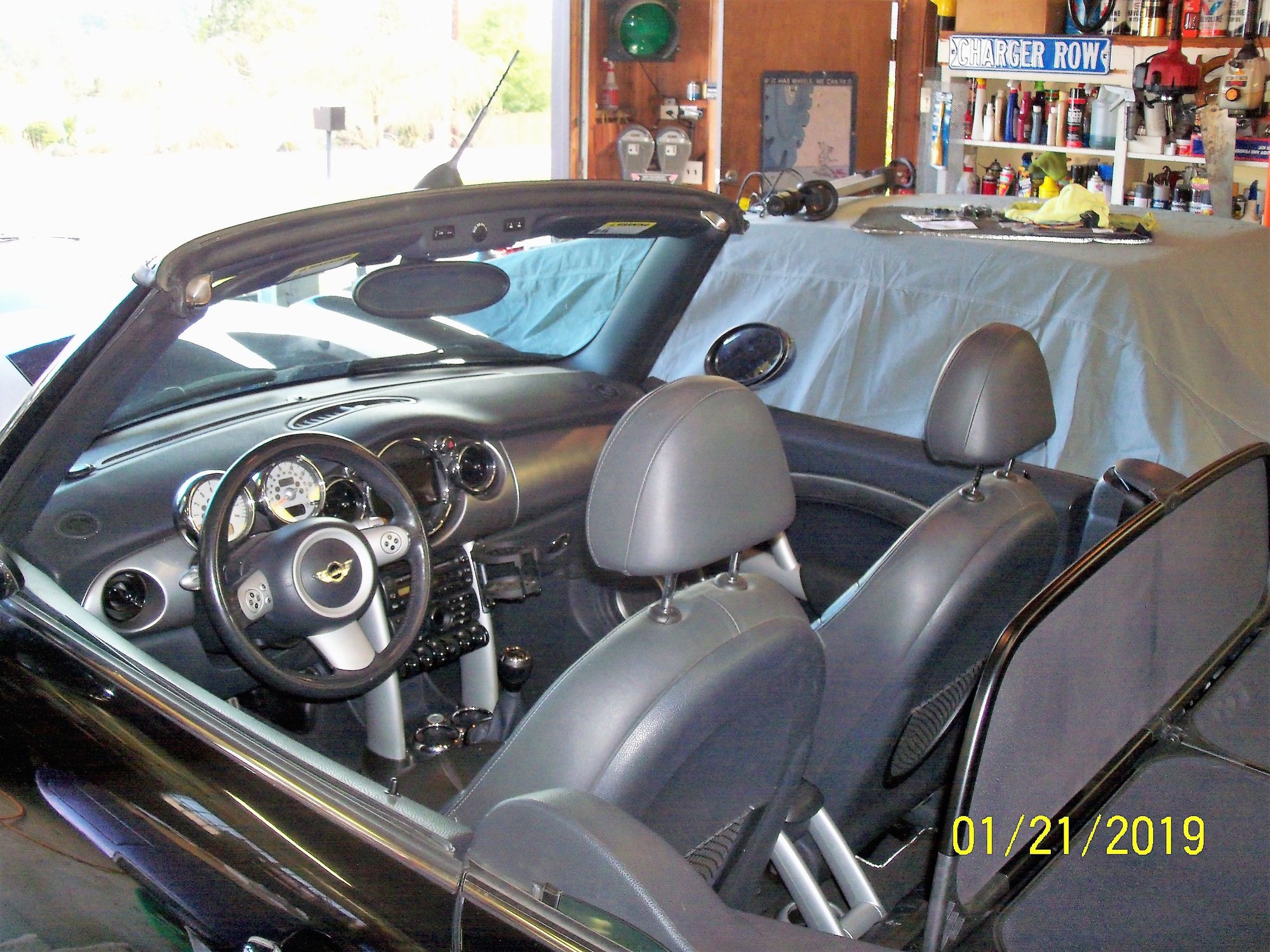

Update: 1-21-2019
Drivers front seat repaired, picked up & installed today.....very happy with the stitching repair....can't even tell that it was repaired......cost me $165
Need to find my replacement decals for the front & rear MINI wing badges that I bought a while back.....looked all over the garage and house today for them....not found........crap!!
I think I can let the car down off the jack stands now.....I can't think of any reason for it to be up in the air anymore....the brakes are done, trans fluid is full, the wheels all turn freely now, both front wheels turn when in gear......and I don't see any drips or puddles of any type of fluid under the front of the car since the engine install......
Getting closer for test drives.......

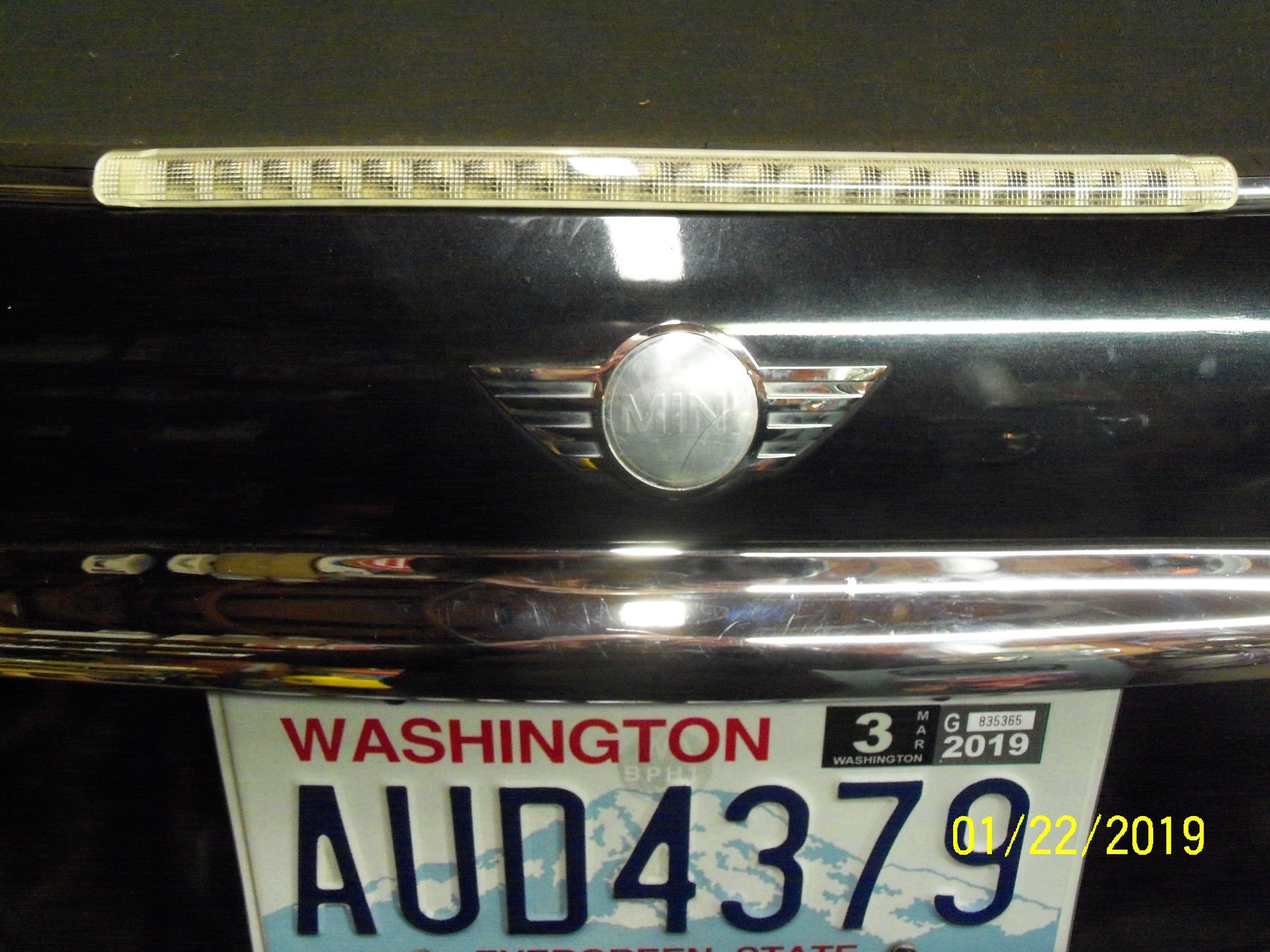

Update: 1-22-2019
Found my replacement stickers for the front & rear MINI wing badges on the front & rear of the car......guess if I cleaned off my table next to my chair I might be able to find the items I have lost.......anyway, the new stickers are on the badges, see pics below

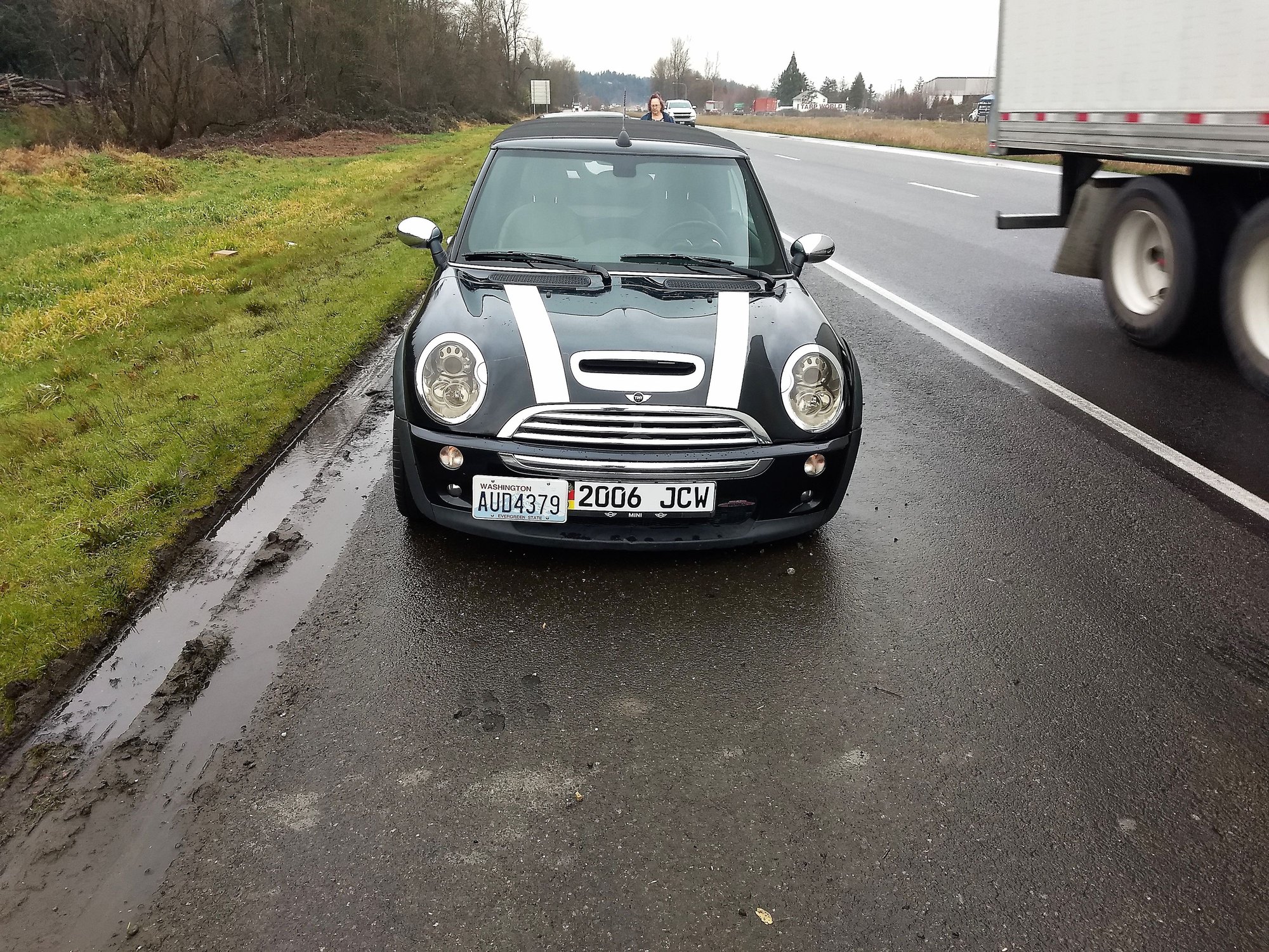

Update: 1-23-2019
WELL CRAP!!!!!
Decided to take another drive today, the only emissions test that has not been completed is the evap system.....I have to have it complete before I can go through emissions to get my tabs....
Had the wife in the car, took her for the drive, it was raining, wipers were on, doing 50mph or so down the freeway in the right hand lane, felt a little vibration, figured the tires were out of balance......then all of a sudden the left front of the car drops to the ground and the left front tire takes off down the freeway and ends up in the grassy median about 1/4 mile away from the car....luckily the runaway wheel & tire didn't hit anyone. I got the car stopped without incident. We are OK, the wife was a little shook up.
After I walked down the median and found the wheel, I carried it back to the car and put it in the trunk, had to fold down the rear seats to get it in
I looked at the wheel and the front hub, all the lug bolts were gone, not broken off, but just gone......don't ask me what happened, I know I hammered them all on with my impact gun.....
.I sat there in the drivers seat for a minute to gather my thoughts......called 911, an officer was there in less than a couple minutes after I called......he asked if I needed a tow truck, I told him no, all we needed was a ride back home to get my floor jack and the other lug bolts. We were less than 3 miles from our house....he gave us both a ride home.....the little MINI sat on the side of the freeway, all alone, in the rain.
After we got home, I tried to find the lug bolts that I took off the car that were on it when I got it.....couldn't find them, I may have thrown them away because they were way too short....Hmmmm......now what.....so I gathered my aluminum floor jack, my breaker bar, socket, and a couple rags, put them in the car and we went back down to rescue the MINI.
I looked at the threaded holes in the left hub, no broken lug bolts in there......OK, so I jacked up the car, took one lug bolt off of each of the remaining wheels and put the runaway wheel back on with 3 lug bolts. Lowered the car back down, and drove home, put the car in the garage, and called it a day.
I took a quick look underneath the car and it looks like all I may need is just a ball joint......doing 50mph down the freeway without a front wheel & tire seems to have ground off the ball joint stud & lower nut......I'll know more when I get the car back up on jack stands and see how the lower control arm is. Ii also broke some of the attaching clips for the plastic arch piece on the hood.....I have those clips here, my R53 needed some
I really hate those European style lug bolts with the threads on them.....it's a real pain to get a wheel attached trying to get the wheel aligned with the hub hole and then get the lug bolt started......my '04 R53 has studs screwed into the hubs with regular lug "nuts" to attach the wheel.......guess I need to find a lug stud set for this R52
Well, that's my excitement for the day.....
Bryan

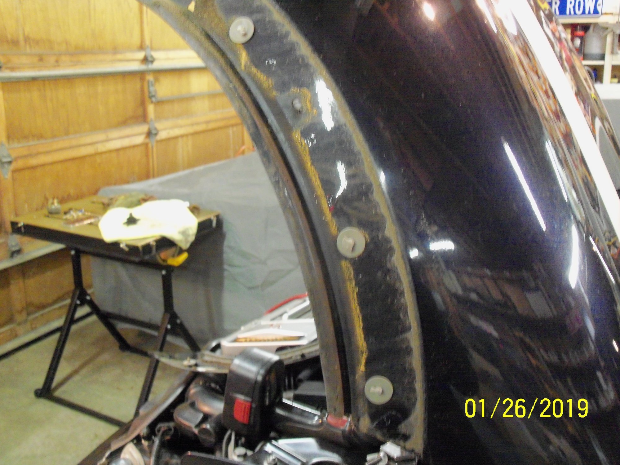

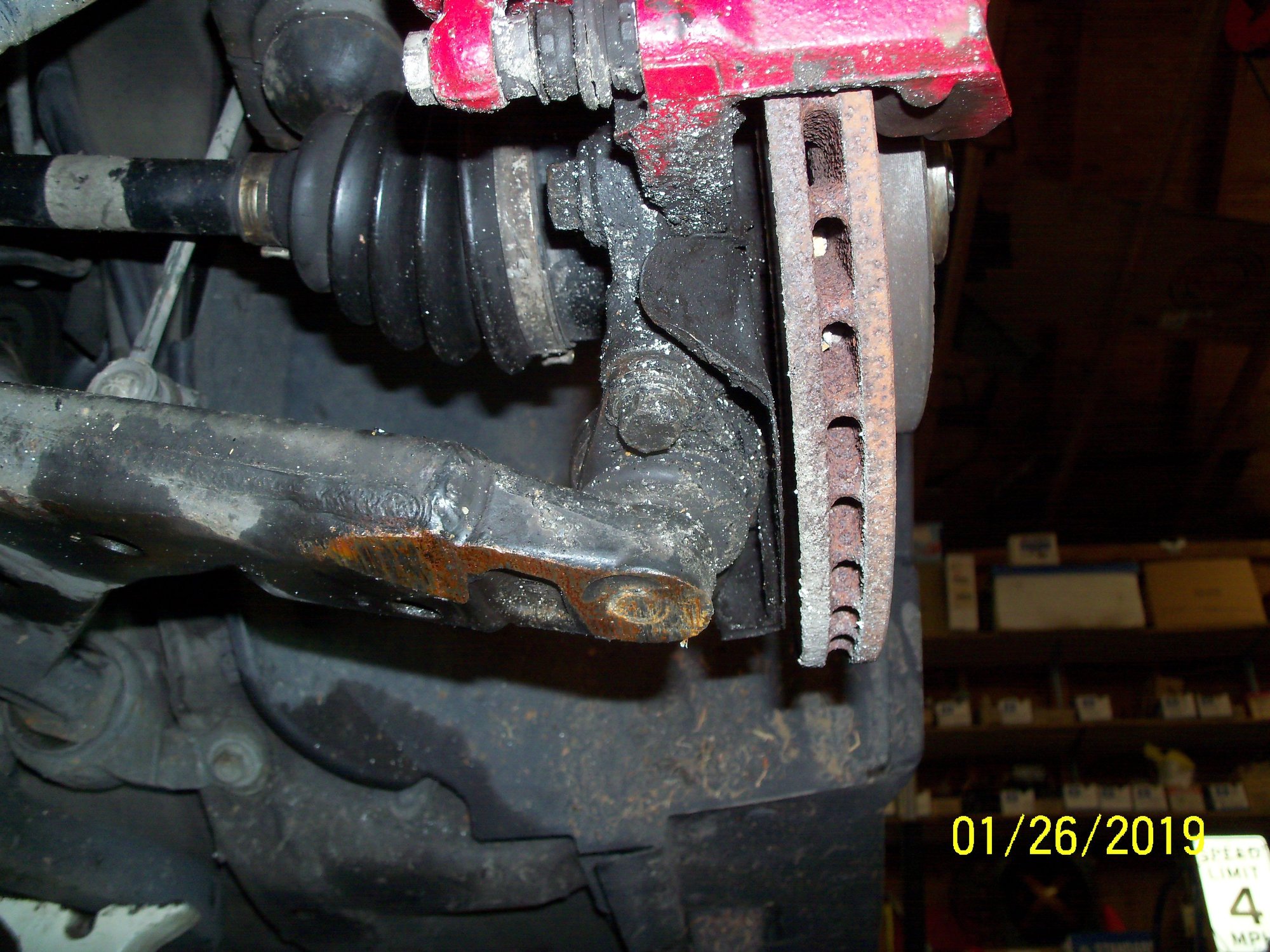

Update: 1-26-2019
Got the car back up on a jack stand.....as you can see, the freeway ground off the lower ball joint nut & stud all the way to the control arm. I think the arm is OK, I'll know more when the ball joint arrives.....I may have to get a hardened washer for under the arm and ball joint nut.....again, won't know until the joints arrive.
I did finally get the ball joint out of the control arm, took off the caliper & rotor, got a tap and cleaned up the threads for the lug bolts.....will see how that goes when it's all back together.....if the lug bolts won't torque down correctly, I'll have to get a front hub.....still not sure if a 2007 hub is the same as my car or not, will cross that bridge later
Got the hood arch re-attached with new clips I had here.....the tire broke all 3 of the plastic clips, the only thing holding the plastic arch on was the front nut.
So, the car is apart and now I wait.......
I'm still not sure what really happened here......either I forgot to tighten the LF lugs, or maybe my impact was set wrong, or the battery was bad......again, I don't know.....and at this pont, there's no sense in dwelling on it anymore.....what's done is done.....
Bryan

Just a quick update from yesterday's post above.....I did chase the wheel lug bolt threads in the hub that was is on the car.....I didn't like how loose the wheel bolts fit into a couple of the holes, so I decided to order a new hub assembly and not have to worry about it again. I removed the hub from the spindle today and cleaned up the mounting hole for the new hub.
I'm supposed to get the new hub and all new BMW wheel lug bolts later on this week, I'm heading to the hospital on Friday morning for cortisone shots in my lower back.....so it looks like it's gonna be a couple weeks before anything gets done on the MINI to get it back on the road.......
