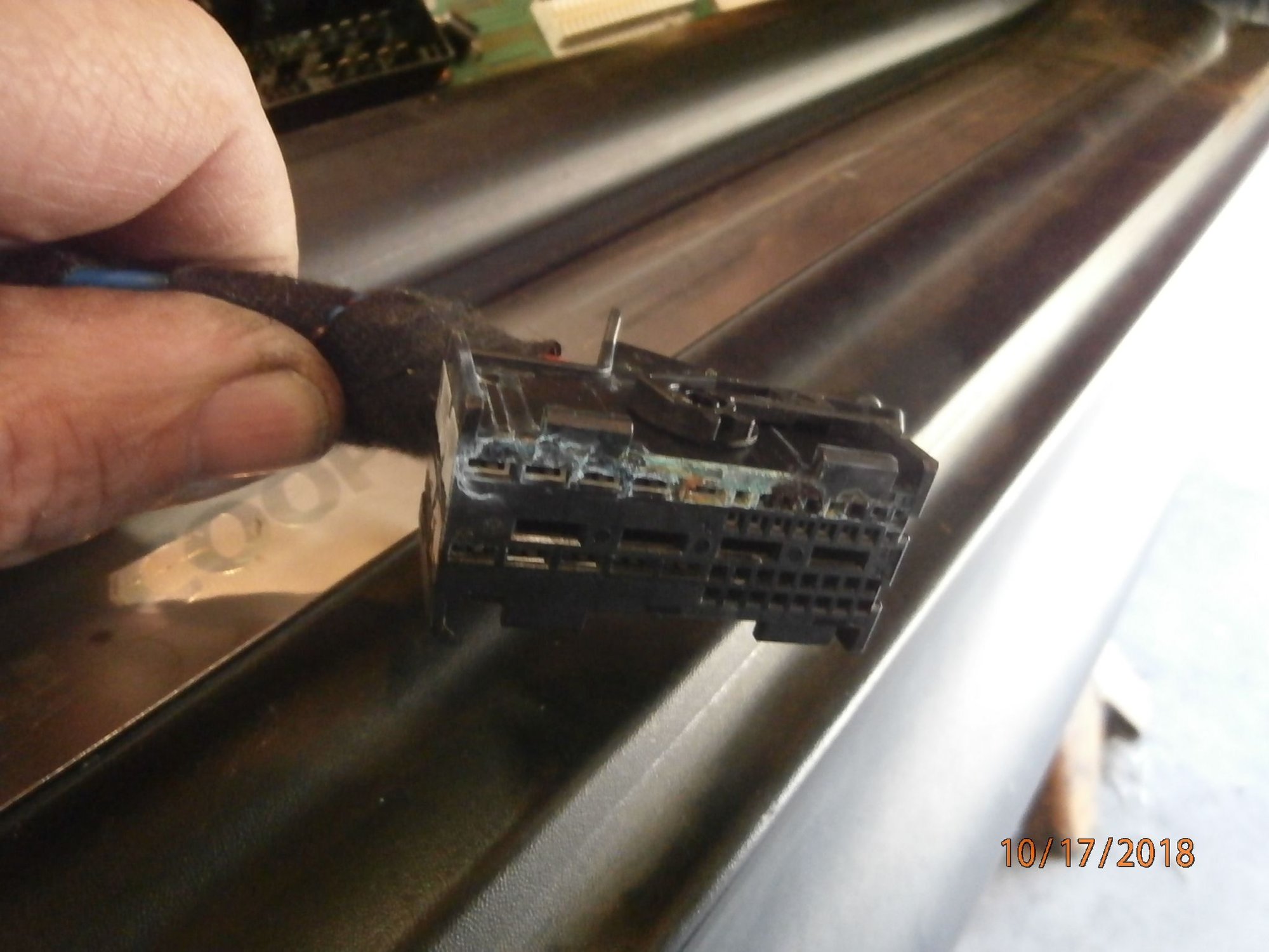

Quick update: 10-17-2018
Pulled the NAV CD unit out from under the drivers seat, the CD is 2006-02 version, it can be ejected and re-inserted back into the player, the power light is lit, but still no map on the dash screen.......
Pulled the H/K Amp out from under the passenger seat, lots of corrosion on the harness plug & pins.....I cleaned them up, but it still does not make "noise" out of the speakers.....I kinda figured it was dead
I got the convertible top up today, but not with the buttons above the mirror....had to release the catches and unscrew the brass fitting in the hydraulic pump motor, then pulled the top up by hand to where the roof rails were almost touching the windshield header....then I jumped the rear hydraulic motor from the battery and worked it up & down, then jumped the center sunroof motor to lock the side rail catches and run the top completely closed....did all the reset tips to try and get the top top to work, still nothing...so I disconnected the battery for the night and will start fresh tomorrow
Bryan

Went out to pull the BCM out of the car if I needed to send it off to have it checked. Pulled the passenger side lower kick panel trim piece off and folded the carpet back to get access to the BCM module......I found lots of moisture under the carpet and padding insulation.....also found a terminal block under there that has many wires broken off from moisture & corrosion.....it's not a "grounding" block to the body, just a connection point for all these wires. I could not save the terminal block, so I cut the remaining 4 wires from the block, and then cut all the wires back far enough to where there was no corrosion in any of the wires. I then stripped all the insulation on each wire off about 1", then twisted all the wires together and soldered the entire end of the wires.
So I reconnected the battery, and now the NAV system, convertible top, and the key in ignition chime all work like they should. Did not have to do any "top reset procedures" at all.......
The HK Amp is still not working, it may be dead as I suspected.....not sure what I'm gonna do about that, maybe just bypass the amp if I can
Most of the interior is out of the car trying to figure out all these issues, still might have to do e-brake cables, so I will wait and do those before the interior goes back in, easy to get to the cables under the brake handle for now.....I have a box fan in there trying to dry out the floor & carpet
Pictures below of what I found and how I fixed it, still need to cover the soldered end with rubber hose and tape
Bryan

Originally Posted by A383Wing
Update: 10-24-2018
FINALLY!!! ......some good news to report.....
Bryan
Wow Bryan, That sure was an ugly mess, but you were on top of it and a fix that will be better than the original way it was done!
