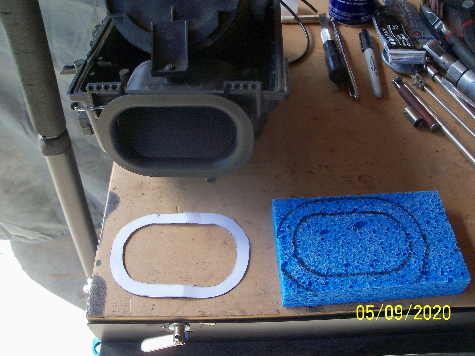

Operation JCW Airbox install
I just remembered that I have not updated this thread about the $75 air box I bought
I could not find the correct seal for the box to cowl....so I made my own out of a sponge and glued it on the snout of the air box...it's not pretty, but it worked
Now I need to rig up a little LED light and run a couple small speaker wires out to the air box valve and see it it's being told by the computer to open at higher RPM
Bryan

glad to hear that the DIY approach worked for you!
For those who come across this in the future and are considering the gasket set, it is part number 13720396433 and comes with both that oval gasket and a gasket for the rectangular section.
links to sites for purchase:
https://parts.miniofkennesaw.com/oem...20-13720396433
https://www.ecstuning.com/b-genuine-...t/13720396433/
https://parts.bmwofsouthatlanta.com/...20-13720396433
