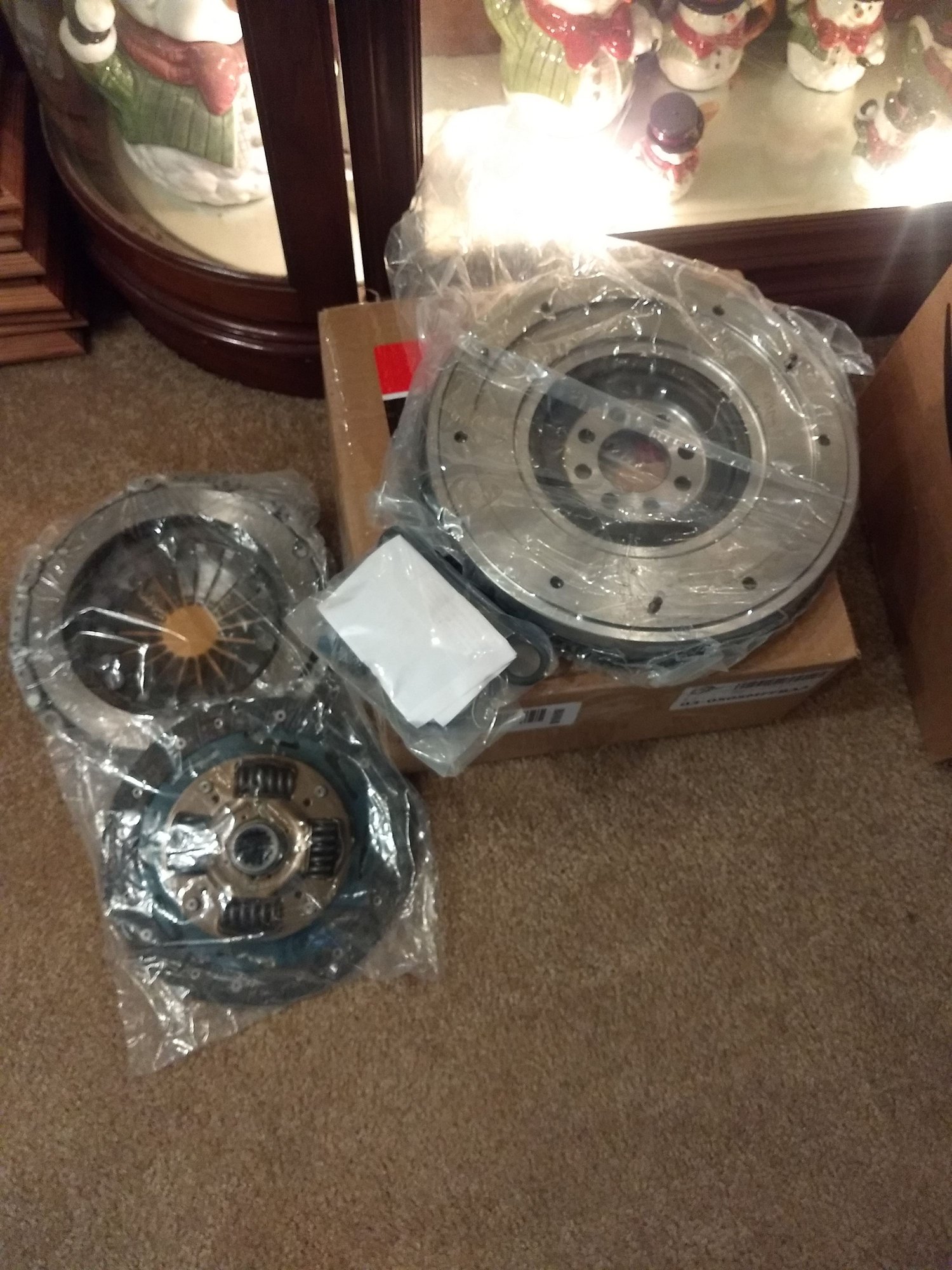

I went with the single style flywheel, it's not the Valeo brand. I found it on Amazon for $275 for the complete kit. Single stage flywheel, clutch disc, pressure plate, throw out bearing, and new flywheel bolts and pressure plate bolt's.
Kit was sold and shipped from Megaparts company. I have dealt with them for a long time dealing with my Chargers in getting parts. Very reputable company.
I can get you the name of the clutch kit and number of the kit if anyone is interested

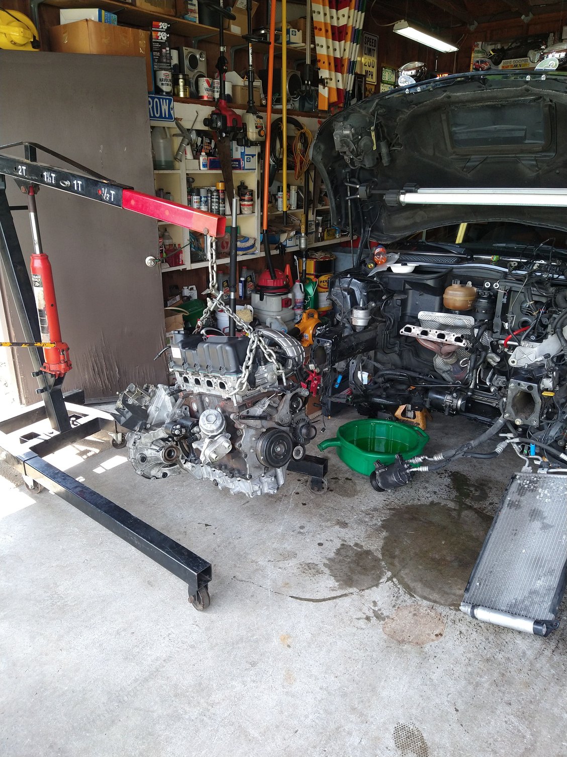

Update: 5/6/2021
Engine and transmission are out, again... broken transmission is on the ground. Will install new rear main seal, Valeo style clutch, 17% SC pulley...... I hope I can remember how it all goes back together
Bryan
