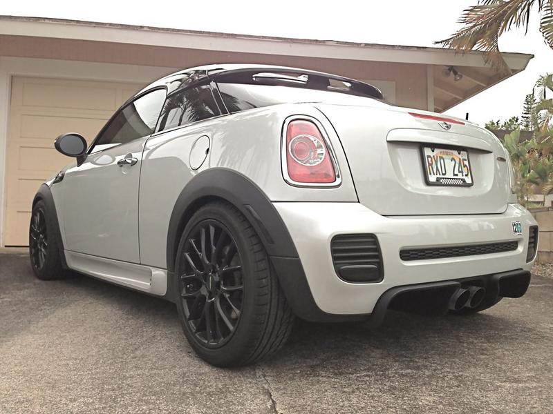

Install took an hour. I'm going to make an install how to, even though it's fairly straight forward, to help the skittish people. I'll post the link when it's done.

Attached Thumbnails jcw gp 2 diffuser-diffuser10.jpg   jcw gp 2 diffuser-diffuser9.jpg

That looks extremely good. The sun is already down here and I was wondering why your photos looked like that. Then I realized you're 3 hours behind, haha.

^ Scooter thanks for the pics...looks fantastic on your Coupe! I have a theory that the Roadster does not come from Mini with the under panels because the Roadster has the extra braces on it which may not clear. I'm still going to try and fit a pair on mine.
