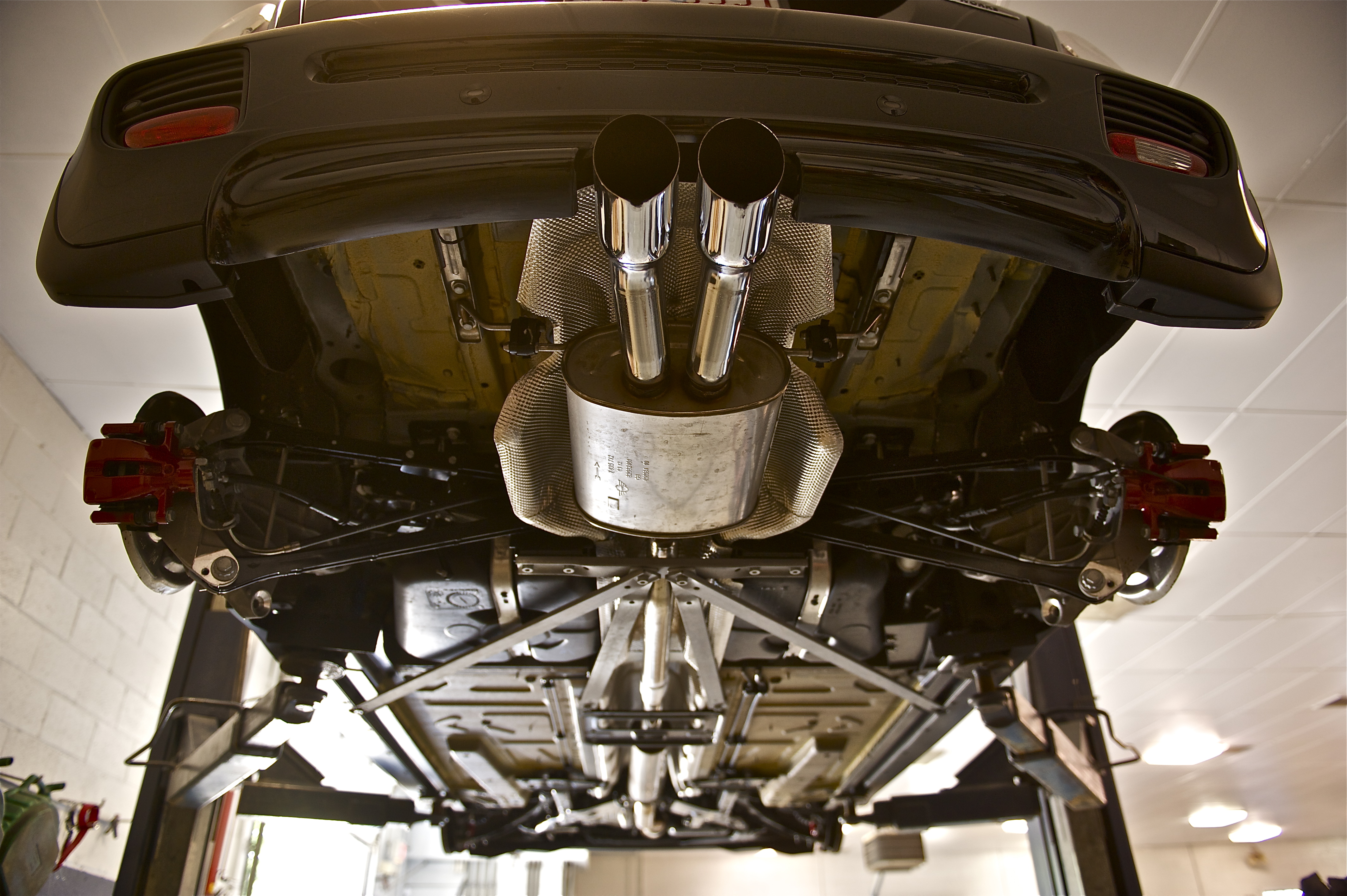

Thanks Z and all others for the info.. I'm posting this pic of my Roadster, because I believe that the 4 holes at the end of the tunnel on the aluminum end will mount to the 4 bolts on either side of the cross brace that ties all the braces together. In which case, at least those 4 bolts are accounted for? Does the Coupe/Hardtop have this small cross brace? Sorry about the run on sentenceName:  _DSC3398.jpg
-Steven

I forgot all about those four holes on the very end of the metal piece because I don't have that cross member on my 2009 factory JCW. Those four holes are not attached on my setup. I was talking about the 3 holes on each that screw into the bracket. I wish I had that cross piece because it does indeed look like you reuse the screws from there to bolt the very end of the diffuser to the car.

Originally Posted by BlueToy
Thanks for the help. What/where do the brackets attach to the car?
-Steven
the rear part of the muffler (cat back) has a hanger on each side that attaches to the chassis with two bolts. You can see them in the picture above where the heat shield has the two cut-aways in the middle. You undue the bolts, slide the bracket underneath, and re-attach the bolts. I did each side one at a time, and I was laying on the ground. It will be much easier up in the air. It will all make sense when you hold them up there. Just use the right one on the right side - left on left. I made sure I matched up the part nos. correctly.

Originally Posted by InVisib0L
What "cross brace" are we talking about?
If you look at the picture above on the Roadster - there are braces that come from either side and meet just forward of the muffler. They meet on either side into a rectangle piece that has two screws on either side. I don't have this piece or that bracing on my hatchback. I think it may be bracing for the Roadster because it has no roof. It looks like the rear two holes on each tunnel may screw right into those using the existing screws in the chassis.
Old Feb 5, 2013 | 08:20 PM
Ohh okay thanks. Yeah, the hardtop definitely doesn't have that bracing.

I've had my 2009 JCW on a lift before and as of kfmuller confirmed, the cross braces shown on the Roadster above are not there.
Maybe the GP2 has the necessary bolts underneath the car already attached to something. Doesn't it also have flat panels running under the car to smooth out the air flow making the diffusers more effective?
Just making a guess as to why the necessary bolts are not included for some reason.

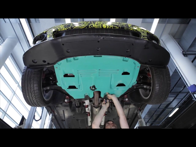

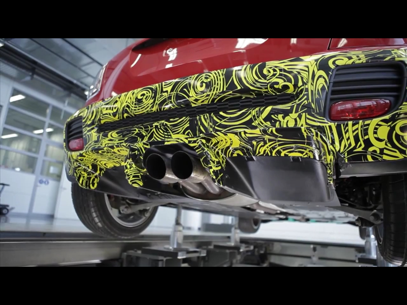

TerminalVelocity
Joined: Nov 2011
Posts: 1,073
We need to see the underside of the new GP. I'm really curious now.
-Steven
Here ya go! I grabbed these from a MINI promotion video for the GP after its reveal. Their not the greatest shots but might help a bit.
Of particular note to me is the Skid plate like ground effects up front. I've glanced over realOEM without luck so I'm not sure if this part has made it onto the production GP's or not. Pretty cool.
Attached Thumbnails jcw gp 2 diffuser-image-2512662314.jpg   jcw gp 2 diffuser-image-758234150.jpg   jcw gp 2 diffuser-image-3790772501.jpg
Old Feb 6, 2013 | 10:49 PM
  #140
InVisib0L's Avatar
InVisib0L
Joined: Mar 2012
Posts: 586
From: California
^ That diffuser doesn't even have those metal plates.
Old Feb 7, 2013 | 02:53 AM
  #141
BlueToy's Avatar
BlueToy
Joined: Jul 2010
Posts: 1,476
From: Chicago
Thanks Andrew It's interesting that they added the aluminum plates to the production pieces. I also read they spent a good amount of time developing the engine bay tray, and that it does a good job of drawing air off the back of the intercooler, as well as getting rid of hot air in the engine bay. Hopefully, this piece will become available.
-Steven
Old Feb 7, 2013 | 08:31 AM
  #142
TerminalVelocity's Avatar
TerminalVelocity
Joined: Nov 2011
Posts: 1,073
Same diffuser otherwise. I'm guessing they added them to strengthen that area due to failures they were seeing.

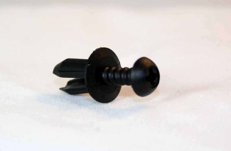

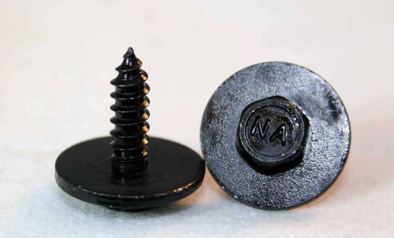

From: California
I could certainly be wrong but I know of two individuals who've tried to order these through their dealer and when they input the part numbers it required at GP2 VIN.
Whoa, that's not cool. Hmm, okay. So for those (6) screws... I went to RealOEM and looked at some of the screws used for the bumper. There was a large list: http://www.realoem.com/bmw/showparts...83&hg=51&fg=17
I picked out a few. Could it be anyone of these?
Attached Thumbnails jcw gp 2 diffuser-screw2.jpg   jcw gp 2 diffuser-screw.jpg   jcw gp 2 diffuser-erivet.jpg
