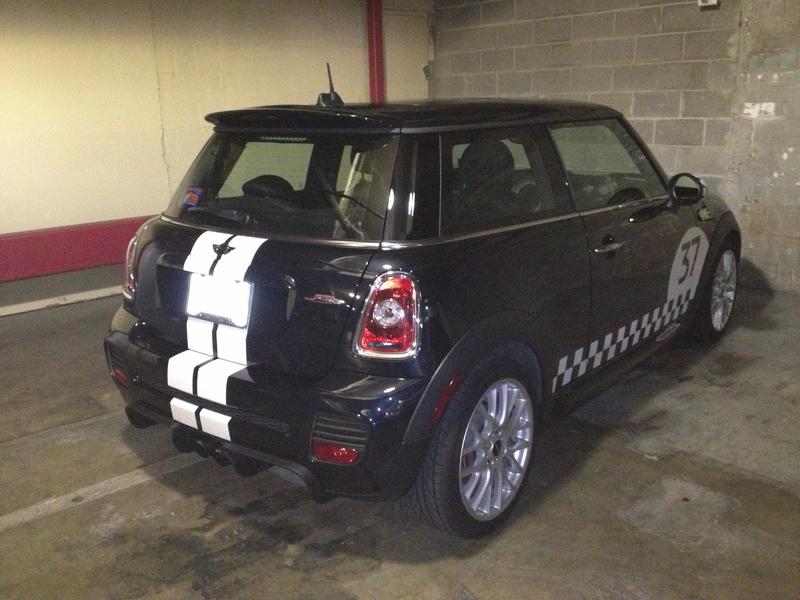

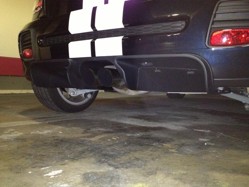

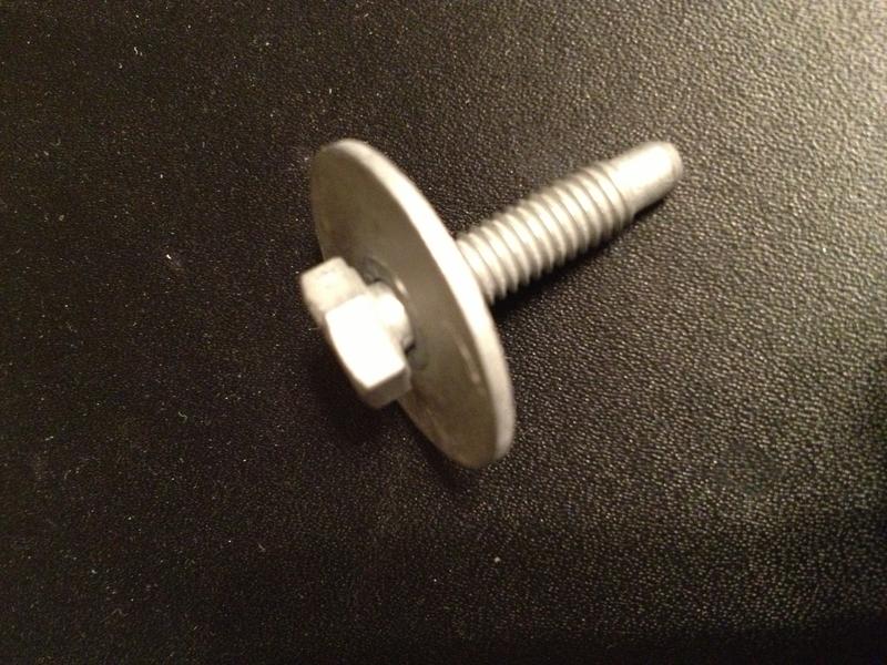

pictures
Not the best because I'm inside a parking garage. I'll get some better ones this weekend.
Also, a picture of the screws I got from the dealer. I needed six - three each to attach the mid-section tunnels to the brackets. Those were the only parts I needed, everything else was included - or existing on the car - 2009 factory JCW.
The screws are one inch long.

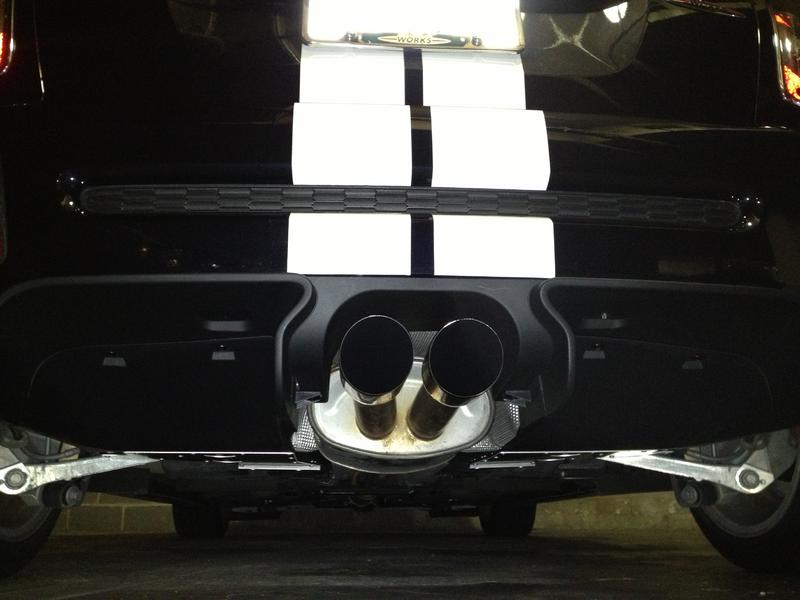

From: Dallas, TX
one more
Here's another shot
Would these work?
Here's another shot
Looks great!
Can't wait to get these installed on mine.
Here's another shot
Wow it looks awesome, what kind of exhaust you running by the way?

Originally Posted by Scooter09
Those might - I would wait to get the parts, then make sure they will thread into the clips. The clips have threads inside them, so you just want to make sure the screw fits.
The parts folks should be able to help.

Originally Posted by sooper_cooper
I hope my oversized Magnaflow exhaust tips fit in there...
They should - there's quite a bit of room in there. It is plastic, so you want a little space to keep from melting.
