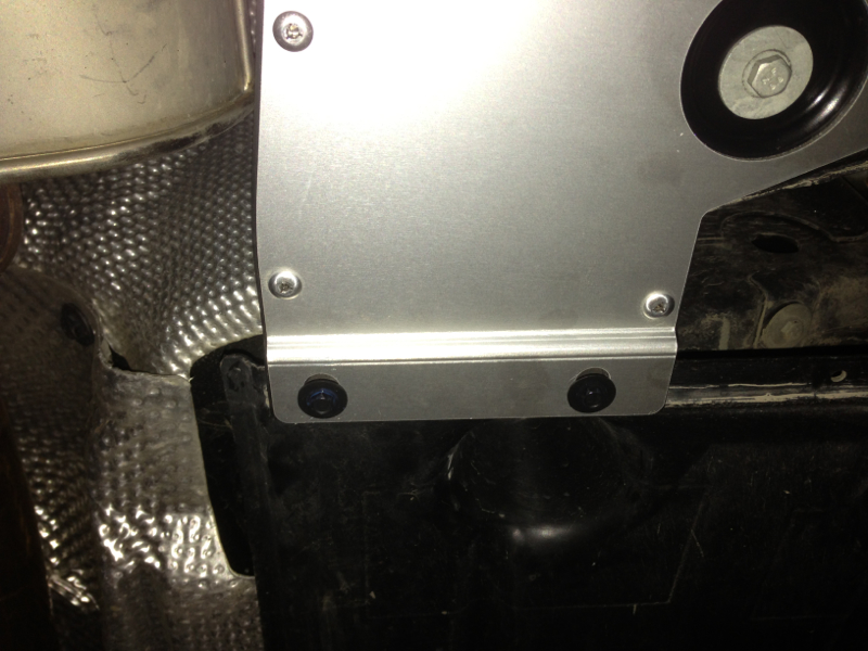

Not sure if this has been mentioned but for those with underbody panels you'll notice the two holes at the rear of aluminum portion of the tunnels. When mounted it'll be obvious they mate up with the holes at the rear of the under panels. I used some U shaped speed nuts and body bolts to secure them together. Makes for a very rigid and smooth transition between the diffuser and under panels and should help minimize any "parachute effect" from high pressure air entering behind the diffuser.
I've actually been trying to find the time to do that and add it to the install thread. I have some fasteners I'm going to use that I got from the dealership. Hope to get to it this week.

Out of curiosity what kind of fasteners did they provide?
