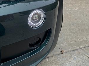

I also picked up new DRLs with an LED halo and a central turn signal bulb, plus some silver finished turn signal bulbs so that they don't appear amber.
Amazon Amazon
Amazon Amazon
I was delighted to find when the headlights arrived that the Xenon hardware is all specific to the housing and not the car, so I returned the new Xenon bulbs I had bought for them.
Turns out, the new housings use standard H7 bulbs for both the high and the low beam! I've ordered a pair of LED conversions that should be here tomorrow, I'll post pictures once I have them in. For now, I just have the H7 high beam bulbs in the new low beam position, so nothing fancy.
Amazon Amazon
Attached Thumbnails R53 Stock Xenon to LED conversion help-6cb078d5-0e1b-46f4-a130-97cf64c3cbf8.jpg   R53 Stock Xenon to LED conversion help-img_1592.jpg   R53 Stock Xenon to LED conversion help-img_1587.jpg

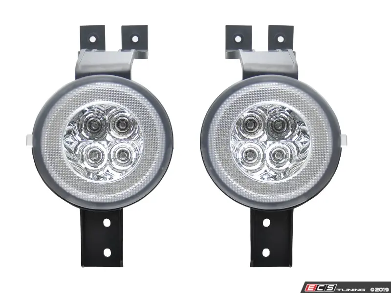

Those looks great, yep we carry some h7 led or Xenon conversion kits also now. Those have an h7 upper and lower so 2 kits and you can have all 4 bulbs done. Or just keep normal h7 bulbs in the high beams.
Whats great is now your 04 looks like an 05+ on the front end. Very OEM+.
The only downside you lose the headlight washers if you have factory xenon.
See below for conversion and we also now have the front turn signal Halos:
https://www.ecstuning.com/b-vinstar-...dicator-front/

I'm really happy with the look of the lights, and they fit perfectly. I was happy to lose the washers. I can wash them myself, and I prefer the look without them there. And, weight reduction! Right?

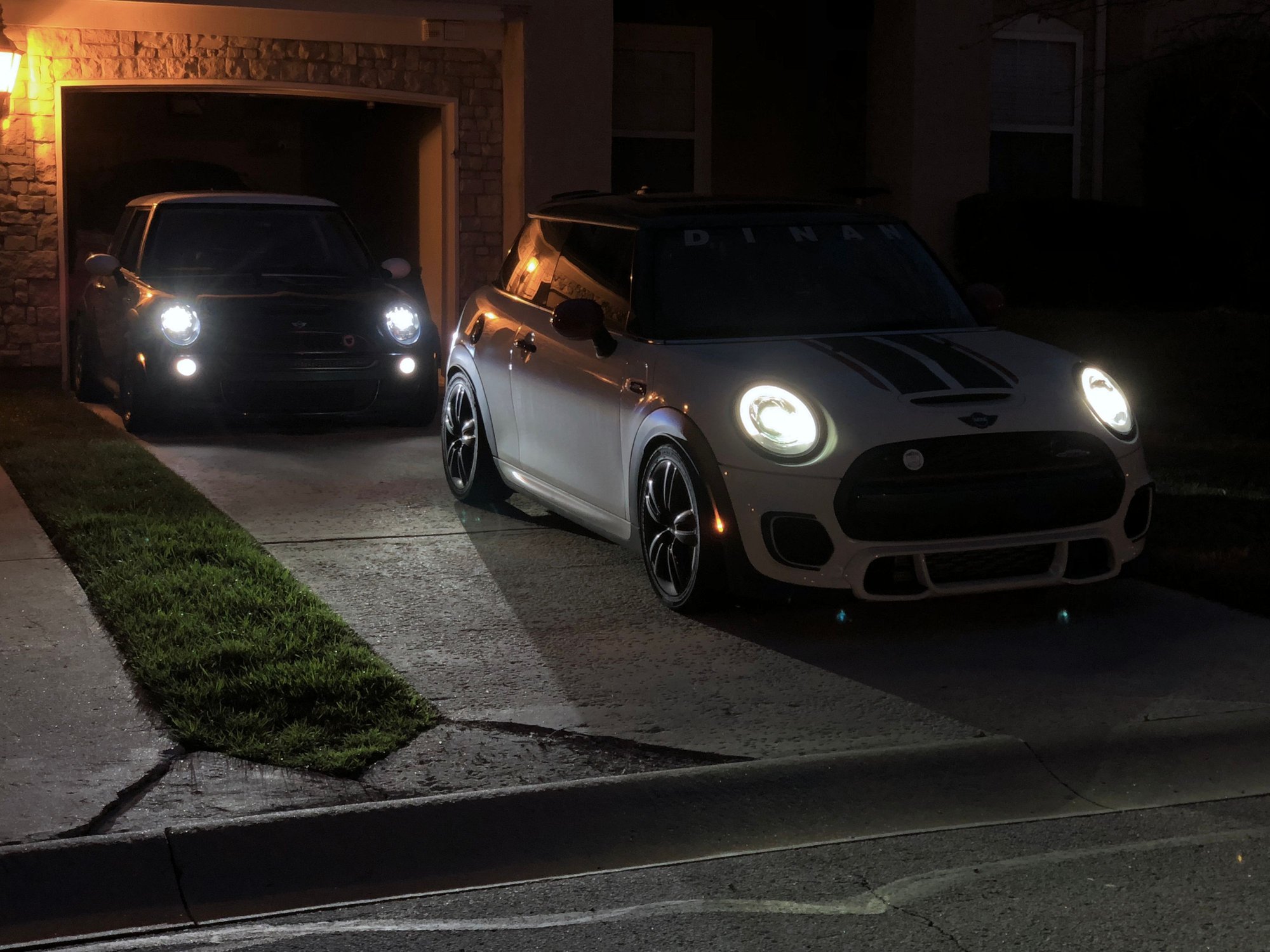

They look great! The xenons were never this bright, not even close! These LEDs are super bright and are a perfect match for the housing. The cutoff line on the road is sharp. Here is a side by side with my ‘17 JCW’s factory LEDs.
Too bad Torchstar sent me one box with two bulbs in it and one box with one bulb, so no high beams for now.
