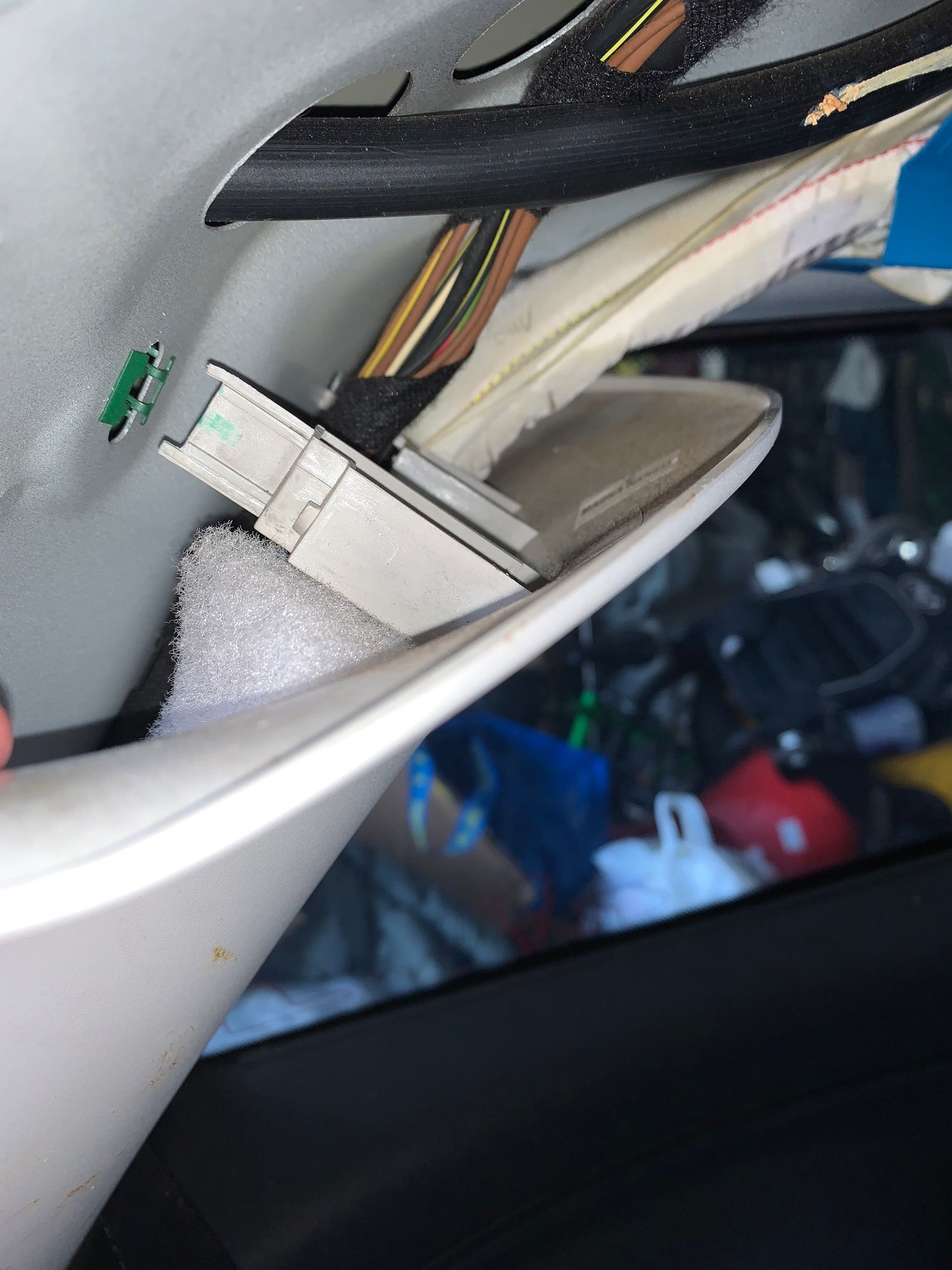

Finally took the time and got the headliner out. What a pain in the a**. The hardest part was having the courage to pull the A-pillars. I ended up braking one plastic tab on the A-pillar but I think it's salvageable.
Headliner out:
A-Pillar Clips:
B-pillar:
C/D-pillar:
If you have a sunroof, don't forget to check the drainage tubes. The first pic shows mine disconnected and the reason my passenger floor would get wet when it rains.

Likes: 57
From: Tampa Bay Florida
I wouldn't bother dying the parts to match since it is unlikely that you will find an exact match to the headliner, and you will just have a different color mismatch! The headliner will fade a bit over time and probably come closer to the color of everything else.
For anyone doing this for the first time, my advice is to find a junkyard car and try to take it apart first. When I did that, I found that the rear quarter trim needs to be pulled back or removed to get to the B and C pillar trim retaining screws. Be very careful if you have the anthracite trim package as the trim parts in that color are hard to come by and expensive when you do. If you find a car with it in the junkyard, consider pulling the parts to have as spares. The pillar trims are a hard plastic that will crack easily if you try to bend them too much.
