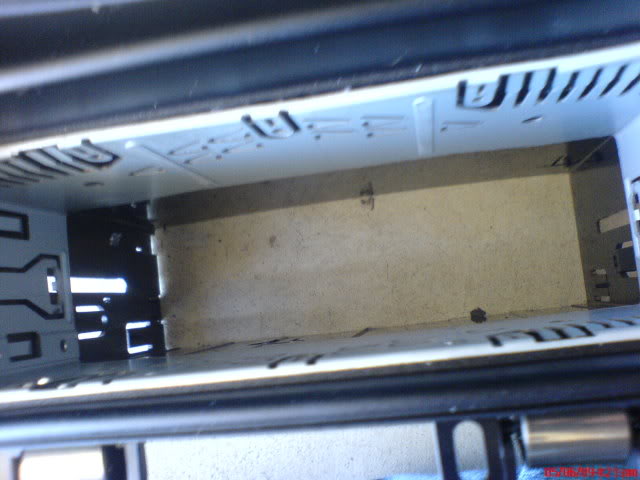

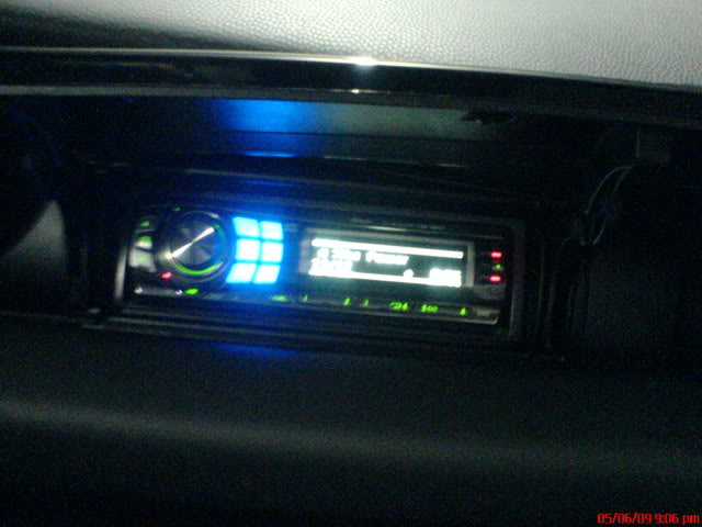

Well my friend and i decided to try a headunit to see if that solves our problems, and guess what it did!Well here are some pics tos how yall. If you guys need help just ask
Pic with the secreat comartment out.
here is a wider view of the taking part things. So If you want to do it you cans ee what you gotta do.

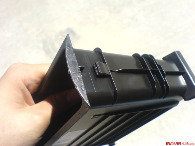

This is the secreat compartment out of its pain cover.The next few pisc will show you how to sorta remove it.. well give you an idea
Here is one of the tabs holding the compartment in. You will need something small to get this out from the front. I used tiny needle noise pliers. You might be able to remove this area with out taking everything out.... MIGHT
Here the other side. If you see how I broke the croner. This is how i found out about it.

testing the unit out beofre everything goes back.
Put it back in nice an snug. Tip for those thinking of this you might want to remove the conecter in the back (ipod cable?) An stick it in the upper holes.
Everything working!

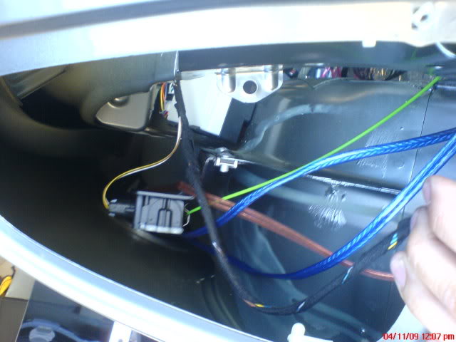

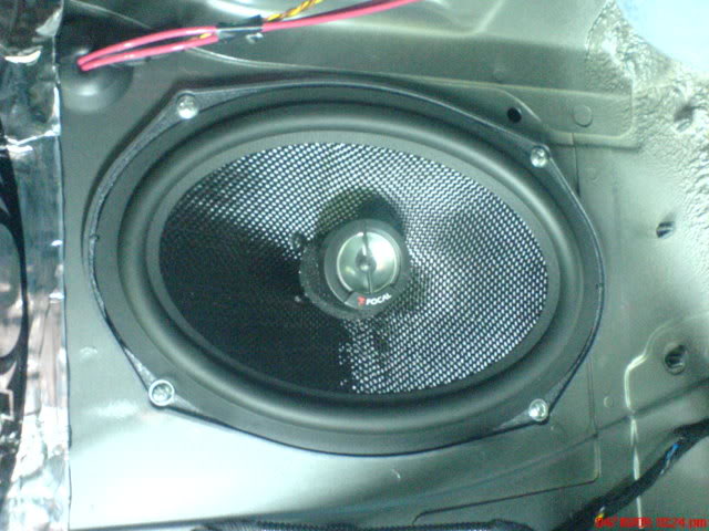

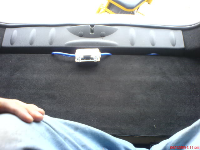

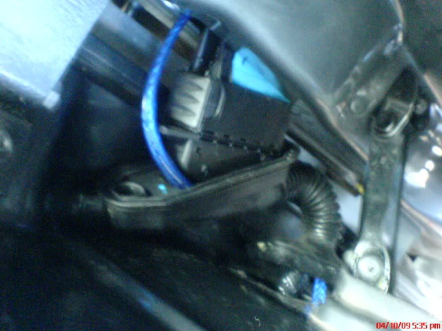

Here some instal pics of the optehr stuff.
strip down
wire through gromit first time (he didnt like it this way)

Focal kp woofer

running wire through the tailight area....
random junk from the first time install. no more red wires, or the 360.
