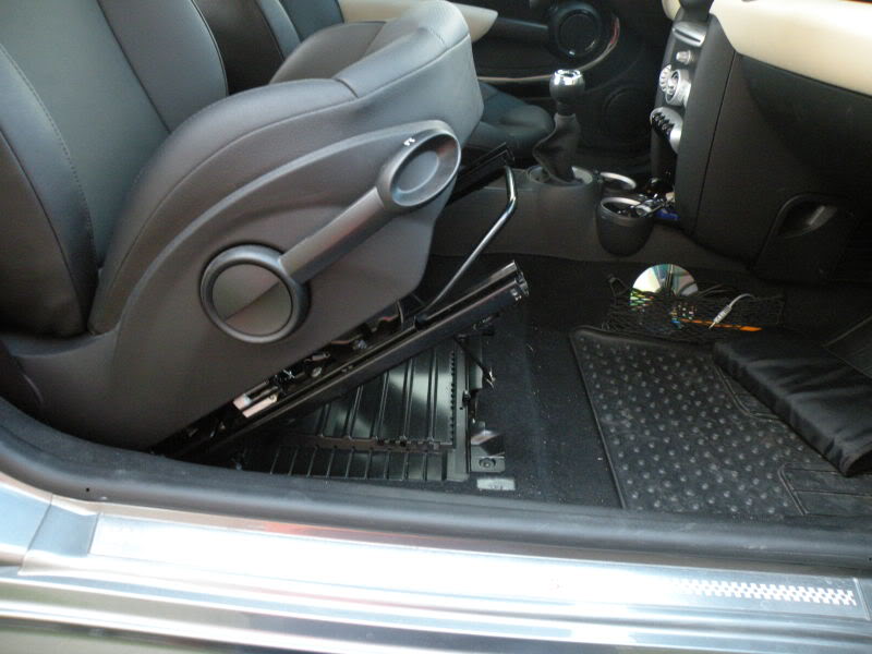

Step one remove the front passenger seat
Remove the four Torx bolts that are located in the channel that the seat slides back/forth on.

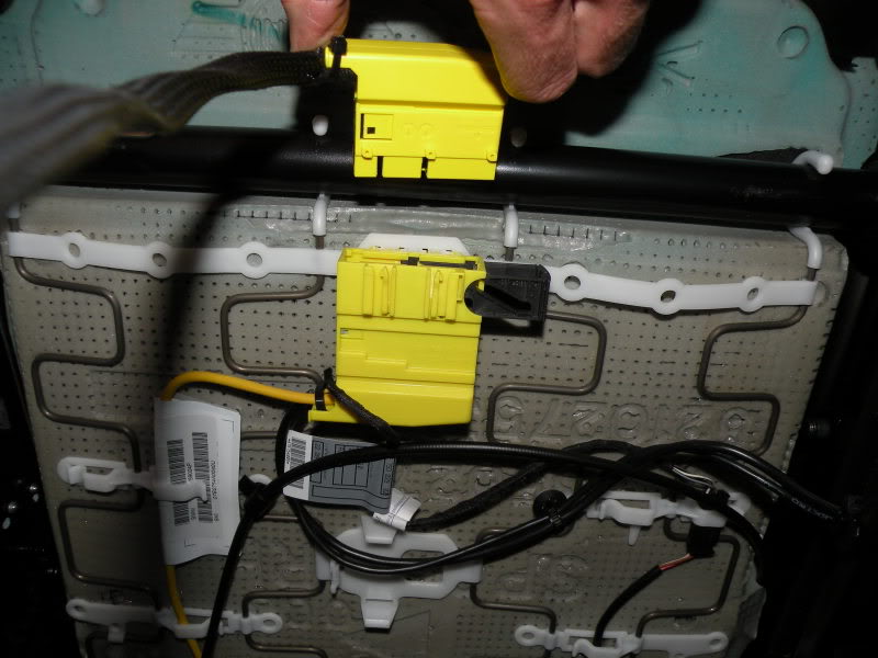

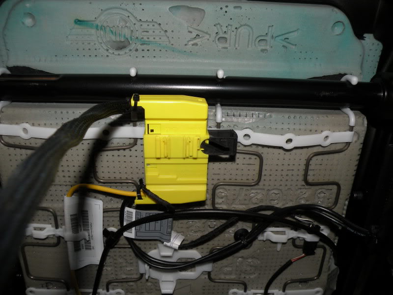

Remove the electrical connection to the seat: pull the black tab out sideways which unlocks and loosens the connector allowing you to pull it apart.

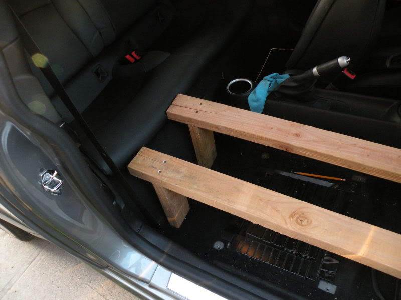

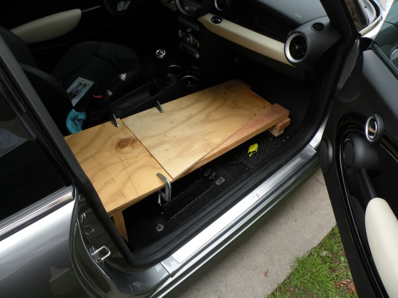

Gather some 2X4's and lay them out in the front area like so. The long ones are roughly 52 inches and the vertical supports are 11.5 inches,if I remember correctly. The ones stacked up in the footwell are to change the angle, the more that are stacked up the more level you will sleep. I also ended up cutting the long ones shorter to let my feet hang off the end since I am so tall.
I made the vertical blocks tall enough to hold everything just above the rear seat cushion.

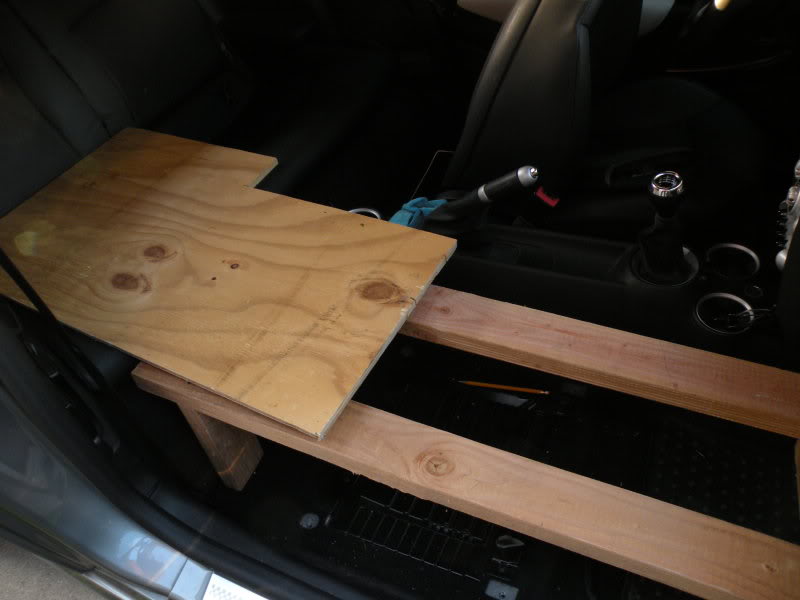

Cut a piece of plywood, I used 3/4 inch, to fit in the back to act as the main support board on which I will sleep.
I then cut a piece to fit down the rest of the length of the bed
not pictured: I used screws to screw the plywood to the 2x4's and removed the clamps.

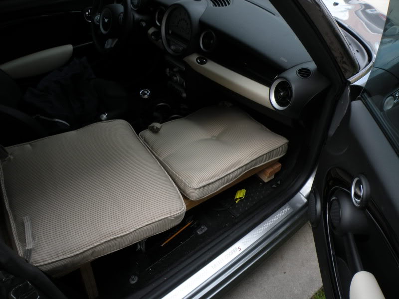

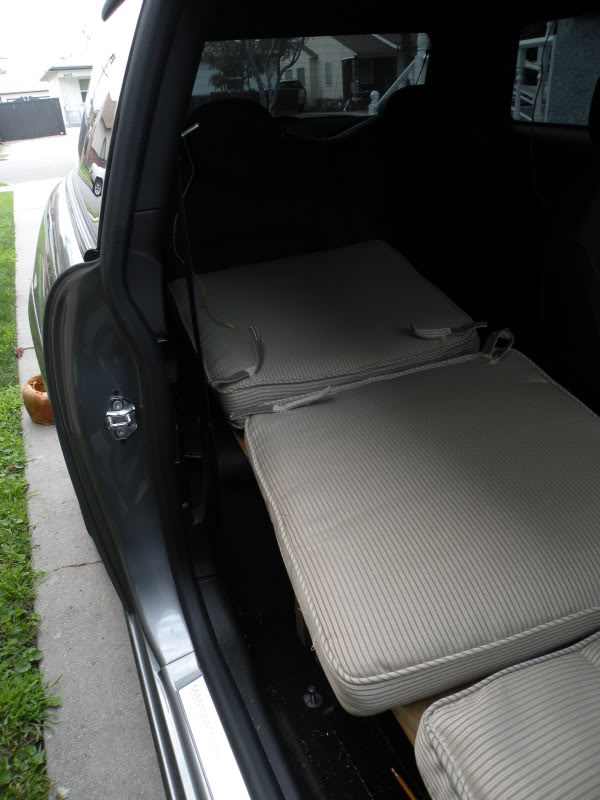

Gather some bedding material. I scored these seat cushions from the patio furniture in our backyard, they are super thick.

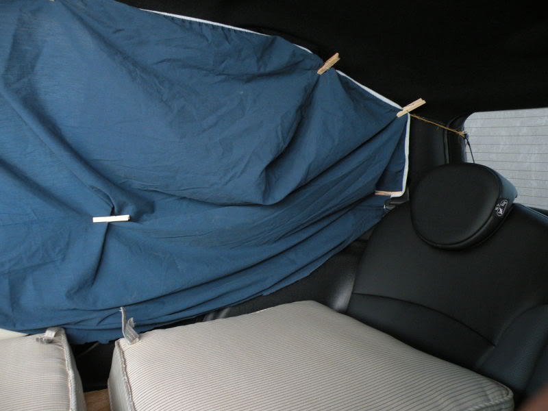

Next step create a curtain for privacy and to keep the light out.
I used an old bedsheet cut in half

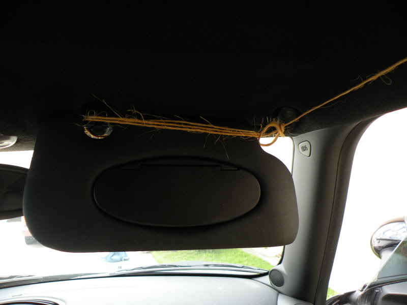

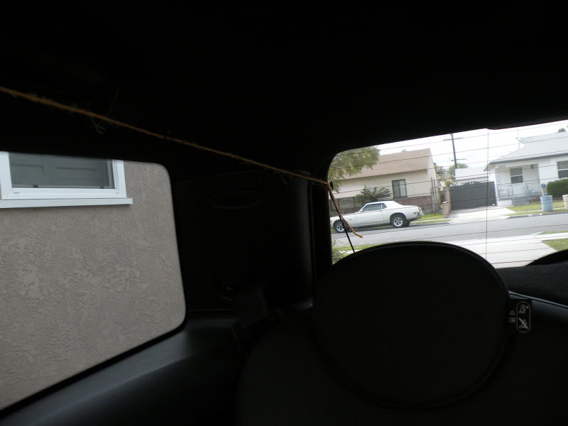

I used some twine to hang it up with, I strung it from the rear trunk hooks, around the rear hand hold, behind the front hand hold, and finally wrapped around the front visor. Make sure you unhook this from the trunk before you open it as it will probably rip the visor off of the mount or something.
sorry the pics came out kind of dark

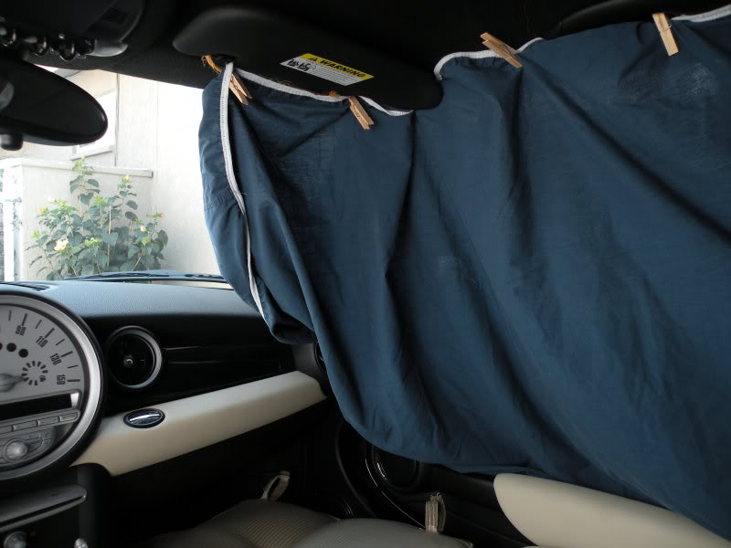

Then use some clothes pins (pack of 100 from 99 cents store) to hang it up along the twine
I have yet to make anything for the front or back, I figure I'll pickup a sunshade for the front and use somemore sheets for the back.

When you turn the ignition on with that under-seat wire cable connector off, you will get an AirBag Warning that can only be reset by a MINI Dealer.
good point. nothing a permanent marker, back tape, or wire cutters can't fix. like the ear plugs i wear for the seat belt chime.

This is funny. You really need to get a one piece type mattress though or you will be very uncomfortable.

Before I put the passenger seat back in I'm gunna try to see what can be done to lower the seat on the frame, even at the lowest setting its still way too high.
and yes, driving around town the airbag light comes on but there is no chime or anything so I'm just living with it. as long as it resets when I reinstall the seat I'm happy.
and I if I feel the need to pickup hitchhikers I still have the back seat available to legally belt them in.
I should also note that I am 6'2" and with this set up I barely fit, my feet are well under the dash and the top of my head is nearly touching the back seat if I lay strait front to back.

Im pretty sure it won't reset by itself when you put the seat back. I think you will still need a MINI dealer to reset it. lets hope for the best here lol
