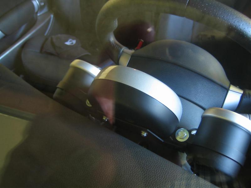

Boost and Oil Pressure Gauges finally installed.
Ok guys/gals I've finally managed to take some pics of my custom gauge mounting solution. Here are a few pics.(hope the attachments work) I'd like to eventually find some flat black cap bolts to clamp the gauge pods but that's a minimal issue. Enjoy!
Jeremy

Old Aug 18, 2007 | 06:05 PM
  #235
DixonL2's Avatar
DixonL2
Joined: Feb 2006
Posts: 4,173
From: Pgh, PA
jhiggs26: Pop those brackets and hit 'em with a shot of Flat Black and you're golden! I know tilted gauges is a matter of taste but I'd straighten 'em up a bit while you're at it. Looks great though.
The bracket was made out of 1/16" aluminum with squared up straps that were riveted to the sheet aluminum and then everything was primed and finally painted flat black. I just need to flatten out the 2 glistening bolts! The tilt is required for now as I do not have 45 or 60 or 90 degree fittings on the tail side of the gauges. When gauges are horizontal there is too much stress on the nylon tubes hence the tilt. I'm getting used to the tilted look though.

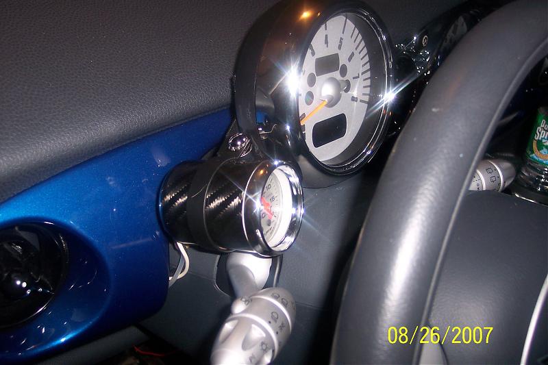

Finally got around to taking some pics of my boost gauge w/ carbon fiber cup. I'm really pleased with the way it turned out. Also, as an alternative mounting solution I used industrial grade velcro. After about a month (with hot summer dash temps) I've had no problems from mounting it this way. Also, for power to light the gauge I tapped into the dash lights down in the cubby area of the center cluster.
There's some more pics in my gallery, including one of my "velco method." Enjoy!
