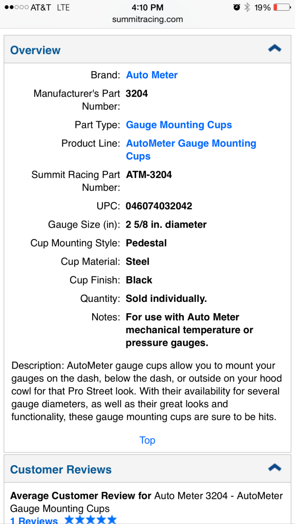

Please correct the post!! I purchased the mounting cup ATM 3204 per the directions. This is too small for the 2 5/8" boost gauge (ATM 4401). It is for the smaller, 2 1/16" gauge.
Unfortunately, I now have to pay to ship this part back and try to find the correct mounting cup . If anyone knows the correct part number, please post!!
I'll see in about a week when I get mine in..

Lightbulb oh my god, I'm such a nub...
WOW uh, I'm glad that my first post ever was so moronic. It turns out that if you take off whatever the black plastic thing is that's on the gauge it fits nicely in the 3204 mounting cup . So, good job having those part number correct. Bad job me. For what it's worth, Amazon does have this part listed as for 2 1/16", if that's any excuse.
"Product Description
For use with all 2 1/16 Auto Meter and Auto Gage Gauges."
from:
Amazon.com: Auto Meter 3204 Mounting Cup: Automotive Amazon.com: Auto Meter 3204 Mounting Cup: Automotive

05minisbeater, you should be alright, just take off the weird black circle that comes on the gauge, it'll fit fine. Sorry for the scare, just being a n00b.
