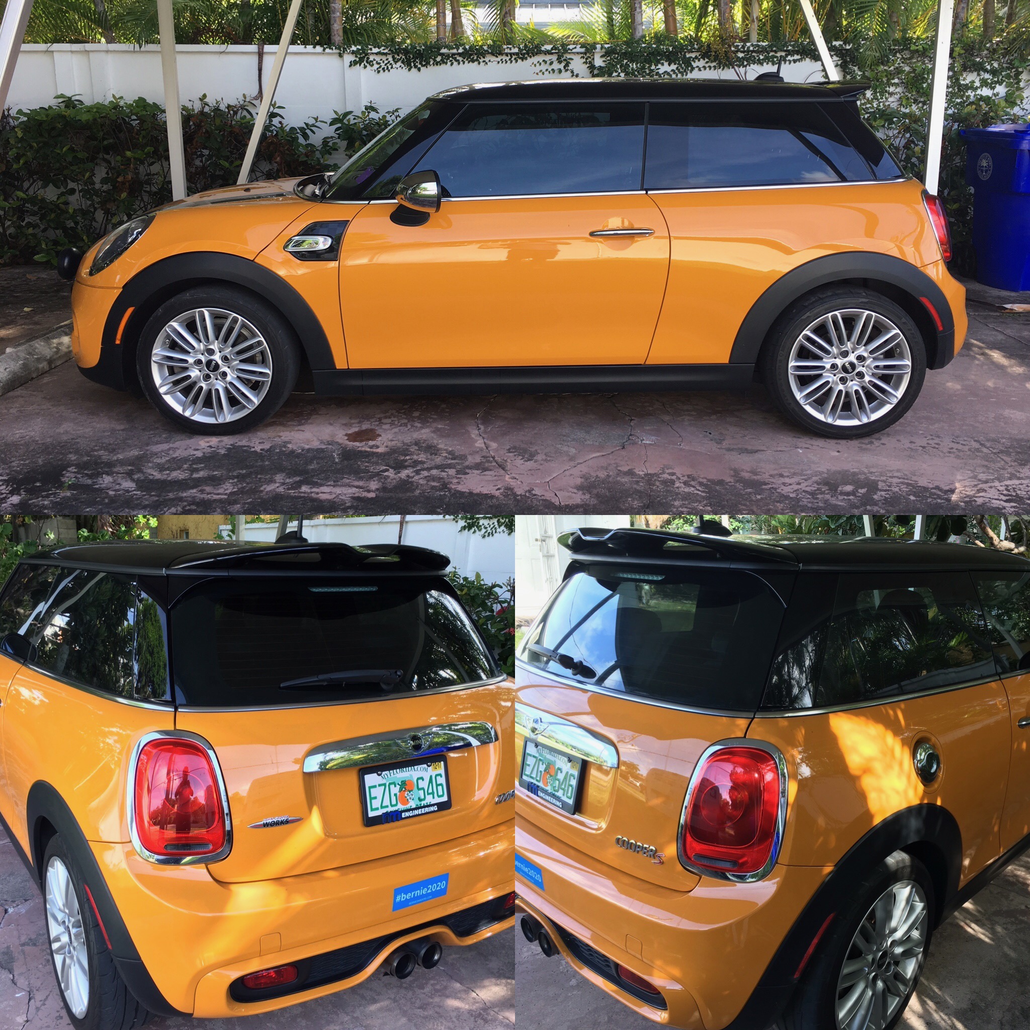

Going to cool Pulga down for the summer.
Update: All done!

What tint percentage is this? Been wanting to do mine for ages but haven't ironed out all the details. Looks great!

13 or 15% Darkest legal limit for Florida.

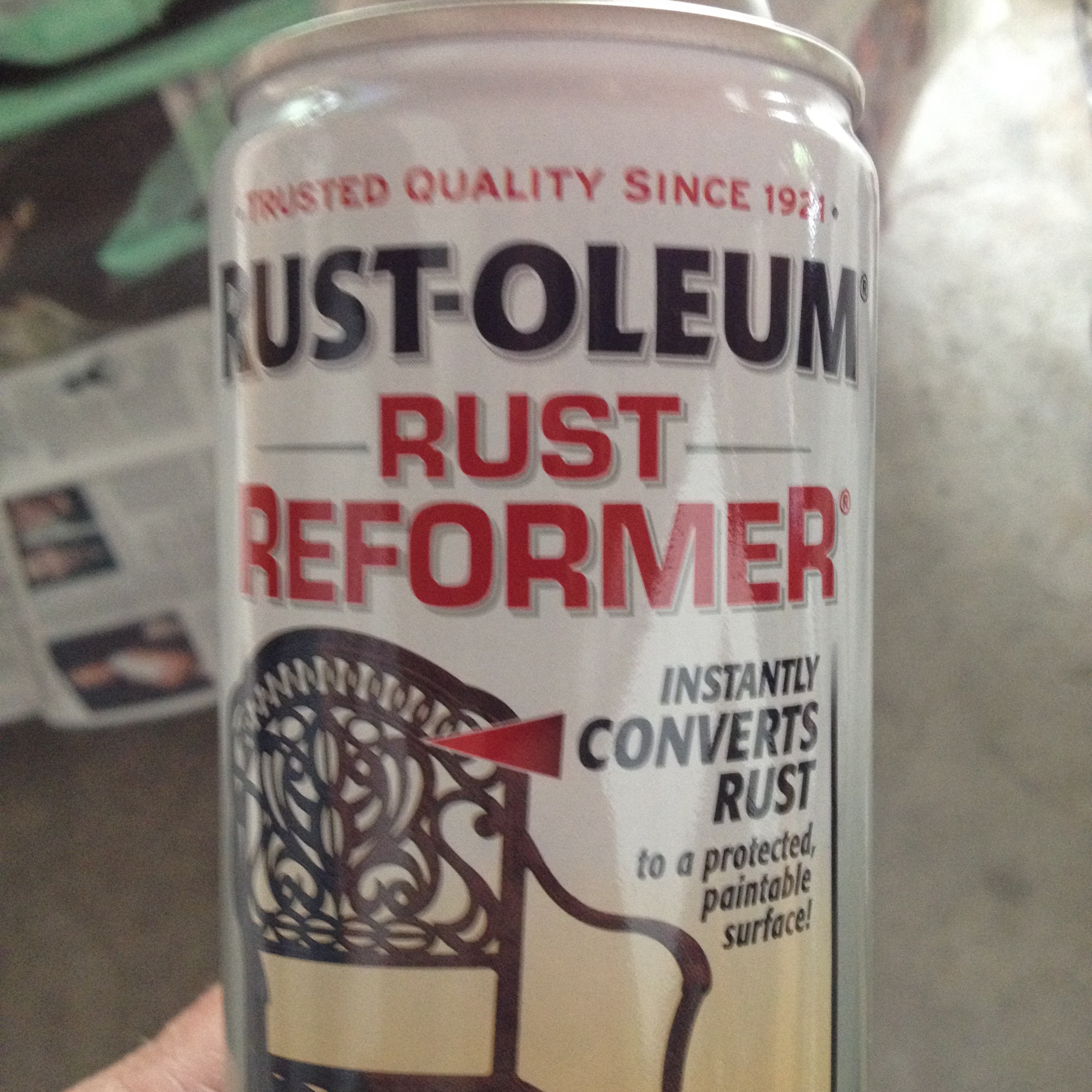

Repaired signs of surface rust under boot seal gasket
While pulling off rear boot lip panel I needed to lift off the boot gasket seal for hatch. I discovered early signs of surface rust in area of boot latch....
Taped off area, wire brush/sandpaper and shop vac'd the area. Then sealed off the area with body shop plastic for overspray. Used Rustoleum Rust Reformer....Seals / stops the rust from forming further by turning it into something inert preventing it from continuing. Then cleaned out the crevasse of the gasket from any rust particles, used some WD40 on the gasket and sealed it back up. New gasket not expensive, will replace with new one that provides better seal in this area.
All better.....
In the last few years, I did this same preventive measure for both pass and driver side openings....and replaced those door seals with new as well. Probably should have checked this back then....
